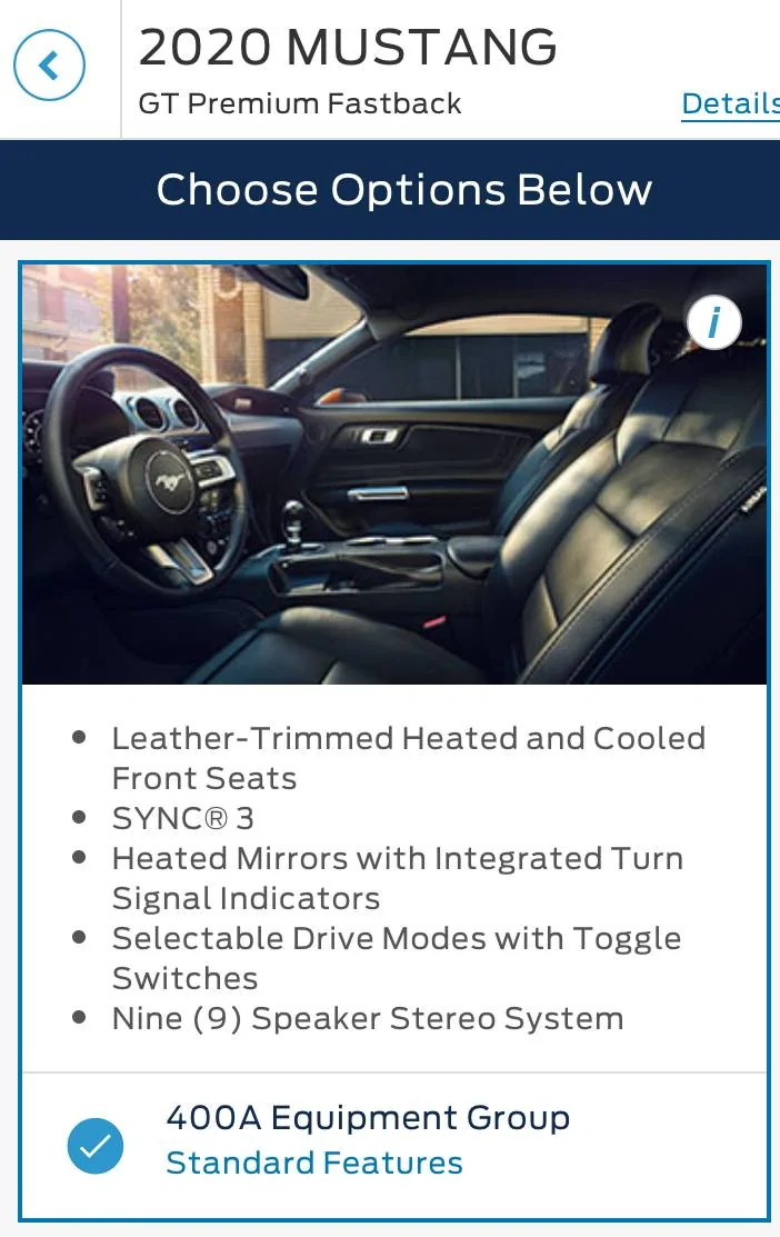

All S550 premium cars have had and still have heated and “cooled” seats.

There you have it. Cooled means cooled. False advertising.
