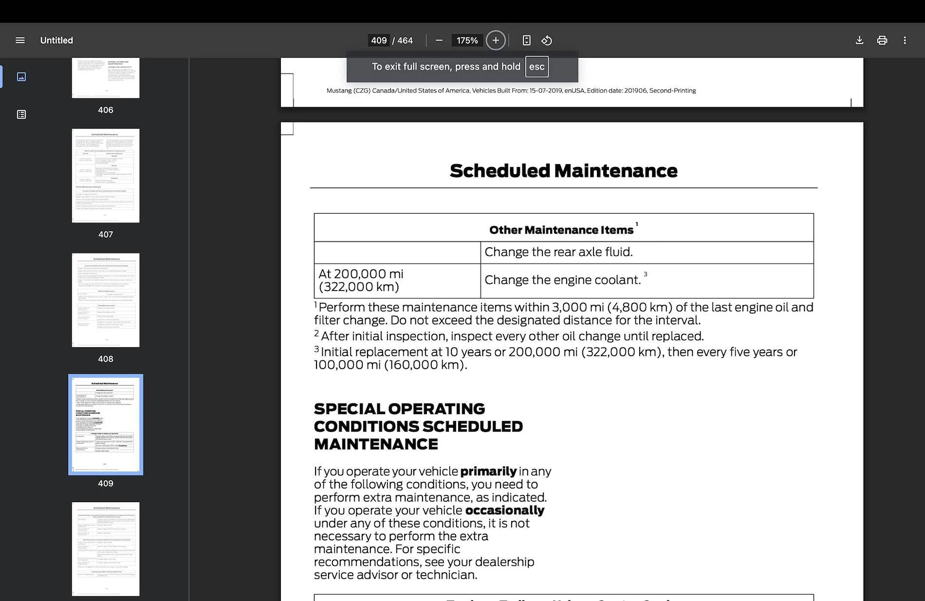

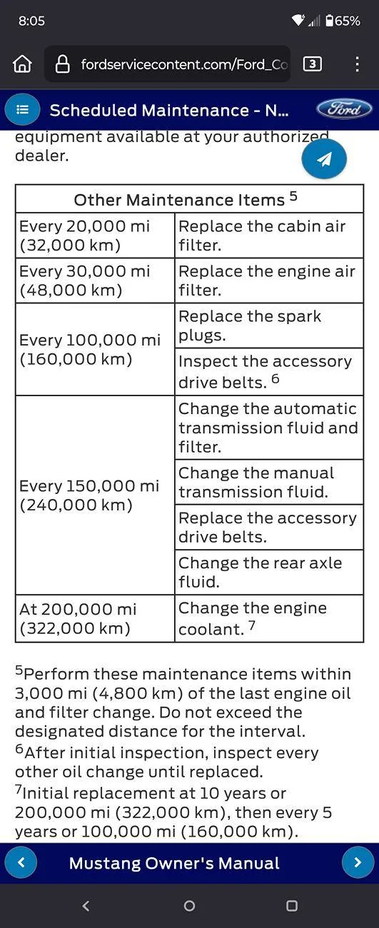

I'm going to guess your coolant is fine.
The owner's manual says you should check coolant strength and level at every oil change or every six months.
Additionally the maintenance schedule calls for a coolant change at 200,000 miles.
At five years old I would consider inspecting/replacing the expansion tank cap.

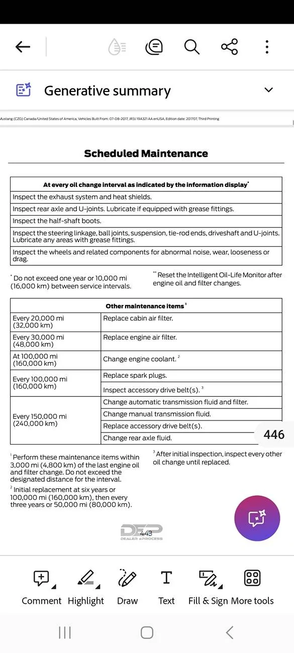

According to the owners manual coolant should be changed at 100k miles. There is no mention of a time limit/frame.
You can always get a hydrometer and verify the coolant is of the proper condition/strength.
100k makes way more sense

The manual on my 2018 shows to change coolant after six years or 100,000 miles. It's footnote #2 in the picture posted above by ORRadtech.
FWIW, the '18 came with the Orange coolant. Other years may have different maintenance needs.
Good catch on the 6 years. I totally missed it.
You can't buy the orange coolant any longer. At least not from Ford. They now spec the yellow flavor. Yellow is backwards compatible and can mix with the orange without consequences.
