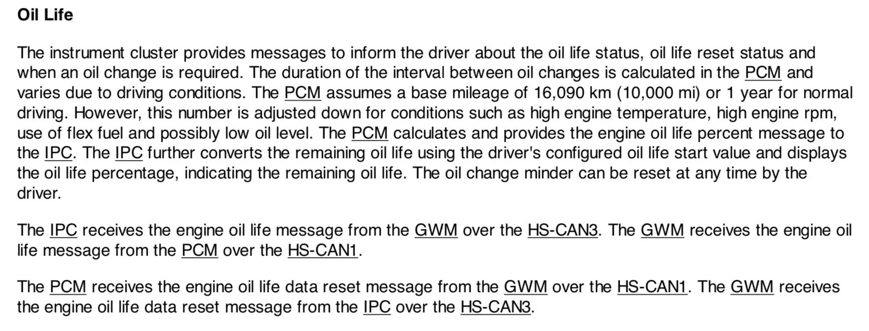

I’ve posted this before, here it is again for those who maybe have never seen it regarding OLM operation and how it functions, per the shop manual:
The timer also counts down as the car sits. So for those wondering why their Oil Life Monitor is saying you need an oil change when you have only driven 500 miles since last oil change BUT the car has been in the garage for 6 months consecutively... The above is your answer.
Thank you for posting that. Had I seen it in the past I would have avoided starting a new thread.
