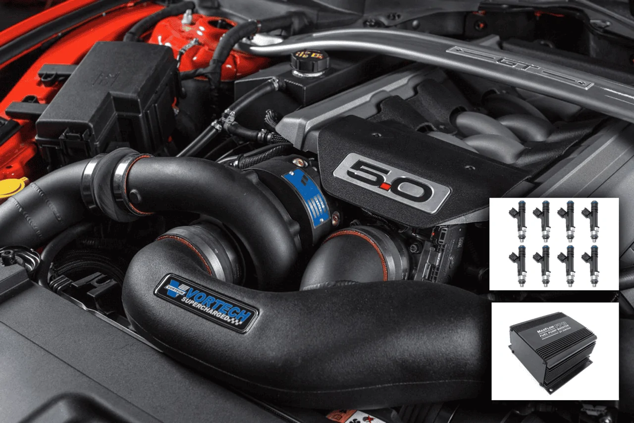

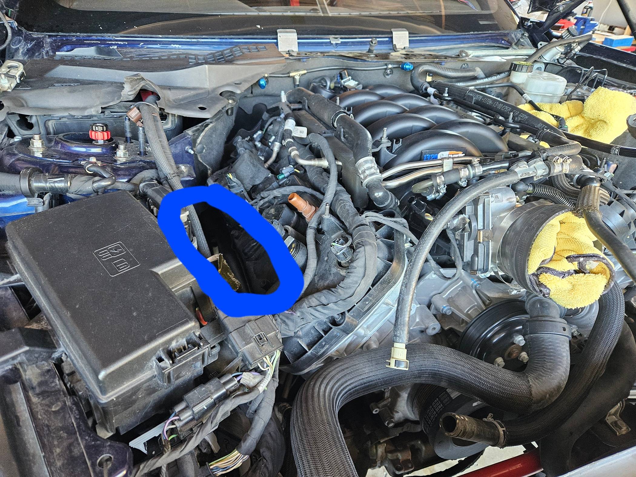

Good morning does anyone of you have a link to a reservoir that is on the engine passenger side space?
I'd like to relocate mine there for aero and cooling purposes
(Full race car)
I think I saw somewhere a turbo kit has something like that.
Please let me know

Im pretty sure its the resevoir that comes with the Paxton and Vortech kids you are looking for. Id check their site and see if you can order seperately.
Whoa that would be nice to get it moved back over there as long as sitting on top of exhaust manifold didn't have that adverse of an effect

That's my concern

Valid concern. IF it's a pure race car.. I'd relocated it to the trunk.
I was thinking in the battery box. I have the lithium one. I'm sure I could fit both.
Maybe with a firewall in between.

oh yes with the lithium battery for sure the battery box then.

On my 94 Cobra, I removed the factory coolant overflow bottle, purchased a Moroso bottle which is smaller and black. I was able to mount it between the front bumper cover and core support; it’s secured with a large stainless steel hose clamp to a center support for the bumper cover. It’s not instantly noticed when looking at or through the front of the car’s grille. It’s been that way for over 17 years now without any functional issues.
Does the S550 have enough room behind but between the front bumper cover and core support? If so, you may be able to do something similar with an aftermarket bottle - it doesn’t have to be S550 specific, any aftermarket bottle OR even a bottle from another vehicle manufacturer will work so as long as it functions as the original stock unit did when installed.
Do keep the post updated with what you decide, because the factory coolant bottle and ALL S550 aftermarket bottles are fugly and just look out of place in the factory location.…
