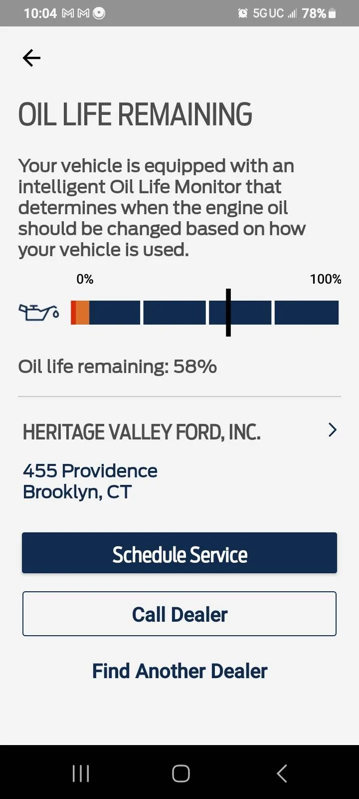

My oil change was about 100 miles ago. Right before its winter slumber.
What the hell is this garbage?

Reset it and let it rip!

Oil life monitor is based on time and mileage. It’s just counting the time. Like the previous poster said, just reset it and good to go

Yes, the Oil Life Monitor ticks down 1.92% a week and will reach 0% at the end of one year. It counts down regardless of mileage driven, to encourage at least one oil change a year. It's not the only factor in the OLM to determine oil life, but like a failsafe.
