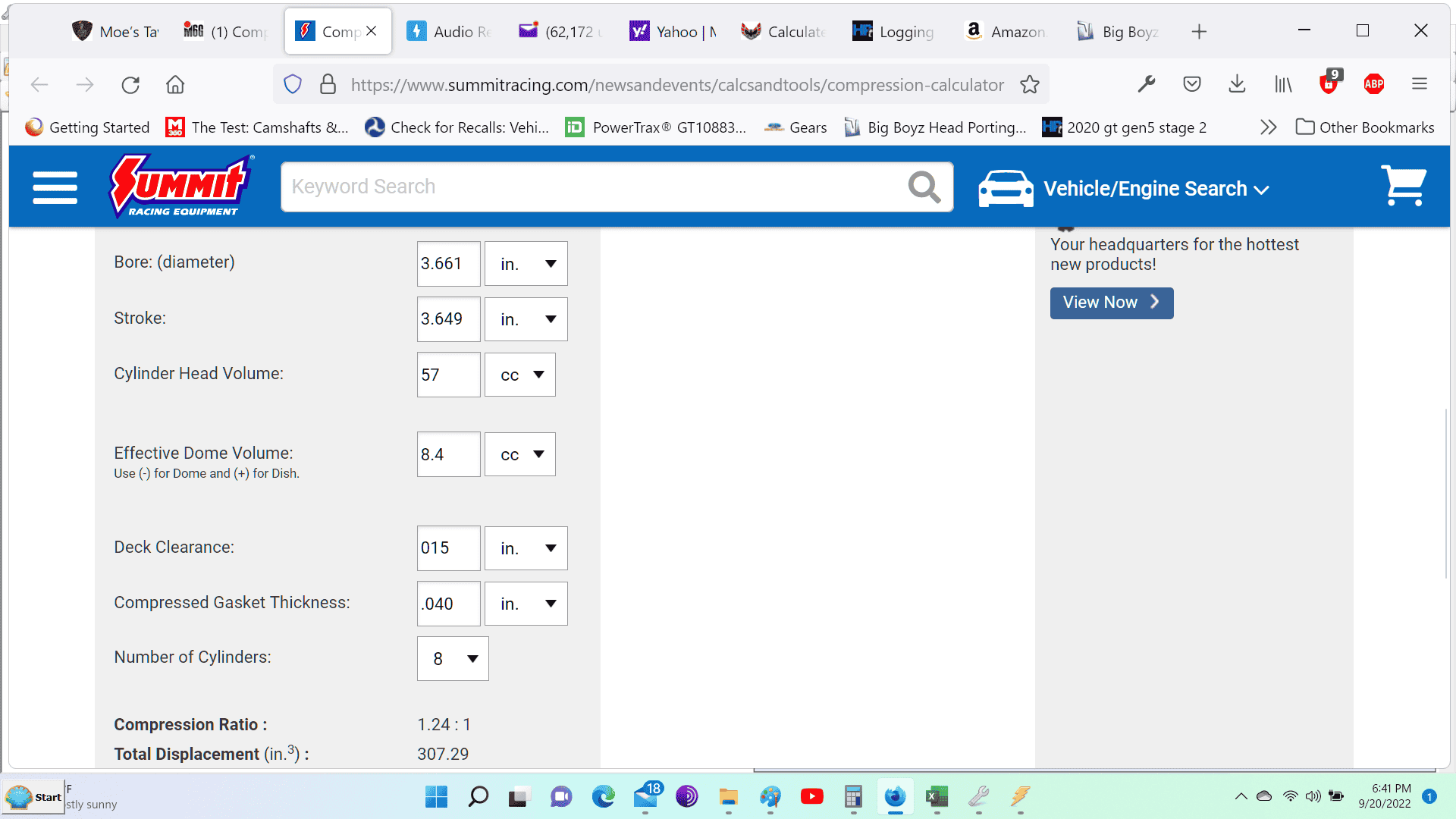

This calculator is usually pretty accurate. Don't know why it is reading low. I'll have to pull out the slide rule......
Change dome so it is not negative. (8.4 not -8.4, the calculator I was using wants negative to represent dome)

Yea, I'm not trusting this calculator. 1.24 to 1

OK used positive for dome, same 1.24 to 1. LOL
