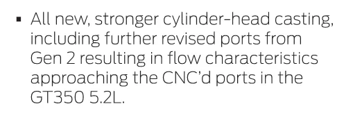

I wonder why the rep recommended Gen 2 heads? Gen 3 heads flow more and have slightly bigger valves, and they are stronger than Gen 2. From the Ford Coyote Technical reference:
