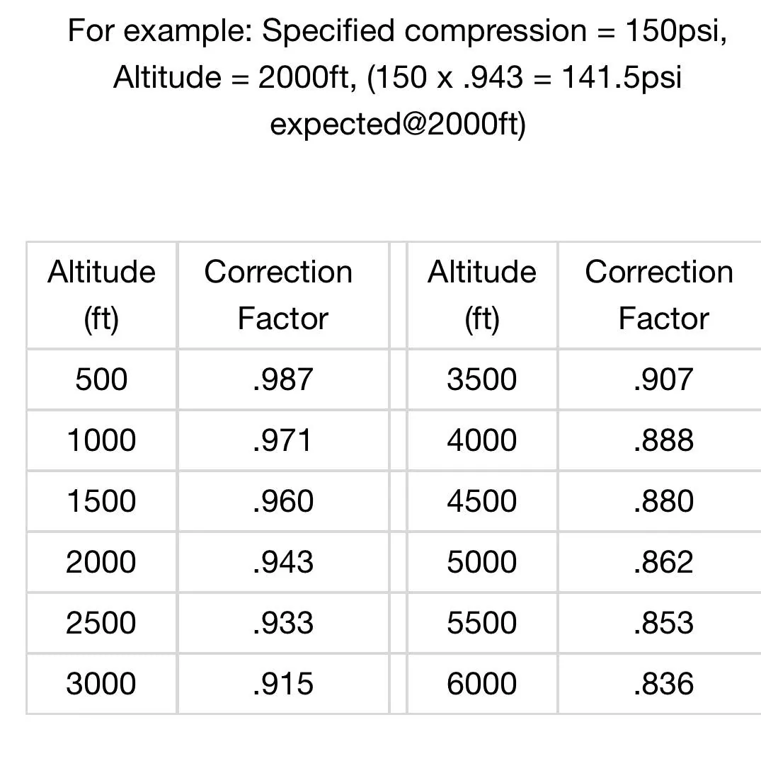

Here’s a little information I found case anyone’s having the same questions

What should be the compression ratio (or the range) of a 2019 Coyote at sea level? Read the 3 pages, and nobody mentioned that. Thanks.
