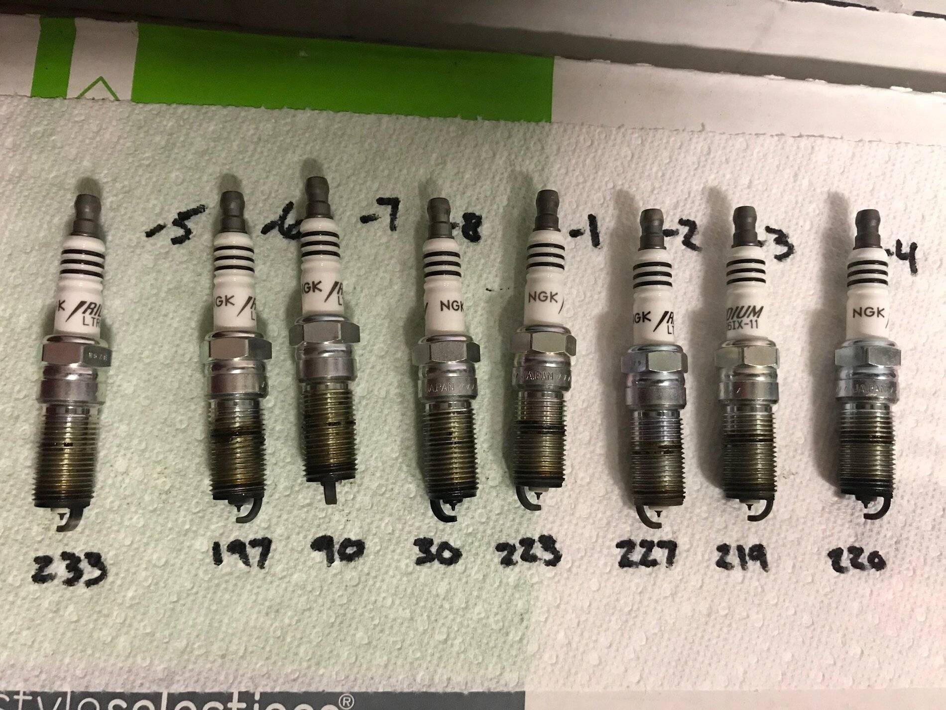

Here's what I got on my engine when checking compression with all the plugs out using the starter. I let it spin through 8 compression strokes for each.

@thelostotter yours is NA? If so that rules out the theory about blowers increasing compression numbers.
Any idea why yours broke?

Yes, NA. #8 piston ring land broke. #7 and #6 were cracked but hadn't completely failed.
Not sure exactly why it happened. I do track the car and was using 91 octane which is the highest pump gas available here. So there may have been some detonation going on although I never heard it. The car never really got hot on track either according to the gauges. I did have the FR Power Pack 2 for a bit which definitely DID ping sometimes, so maybe that was it. Or this motor was built with ring end gaps on the tight end. They were all at 0.015" when I tore it down, even #8 which was totally worn out so it likely started life a bit tighter.
Had the block honed with a torque plate, mains align honed, and rebuilt with Manley rods and Wiseco pistons. Put on an Earl's 50 row extra-wide oil cooler and a real oil temp sensor in the pan. Race fuel only on the track now. Taking no chances :thumbsup:
