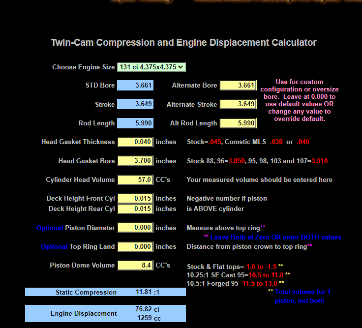

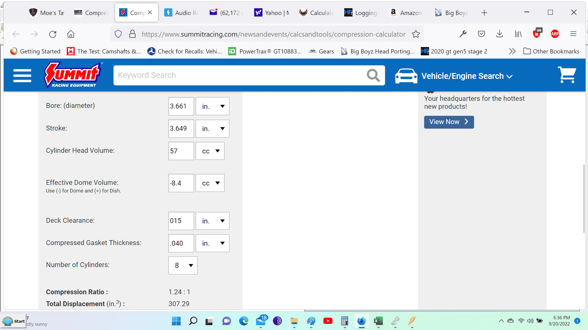

Check again. I cropped the first one
On the summit calculator, you use a negative number for the dome. On the calculator you used, you use a positive number.
I tried it both ways, that is why I posted 2 screen shots.

You put 15 inch not 0.015 inch
LOL another senior moment.:facepalm:
