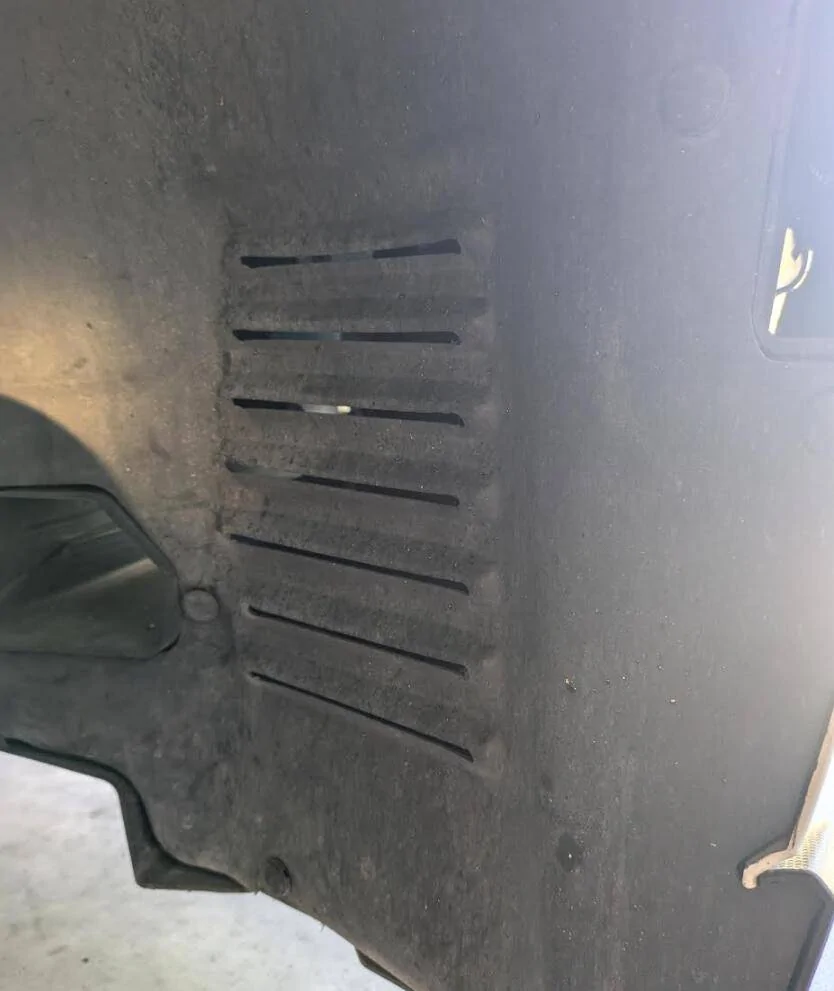

If I were you wanting to cover them, I would put gaffer tape on the airflow exits in the wheel well liner, and see if that gives you a bump in temp. If that doesn't help, I would then consider gaffer tape on the grill. I would say stopping the airflow coming out allows for air pressure to build up in the cooler area, and it will have the same net affect, without any visual changes to your car.

Genius! Did not consider just blocking the rear of the coolers through the wheel liner. Makes sense as that would prevent airflow through the fins. Also a lot less work than pulling the front bumper and cover the front of the coolers. I'll give this a shot, thanks!

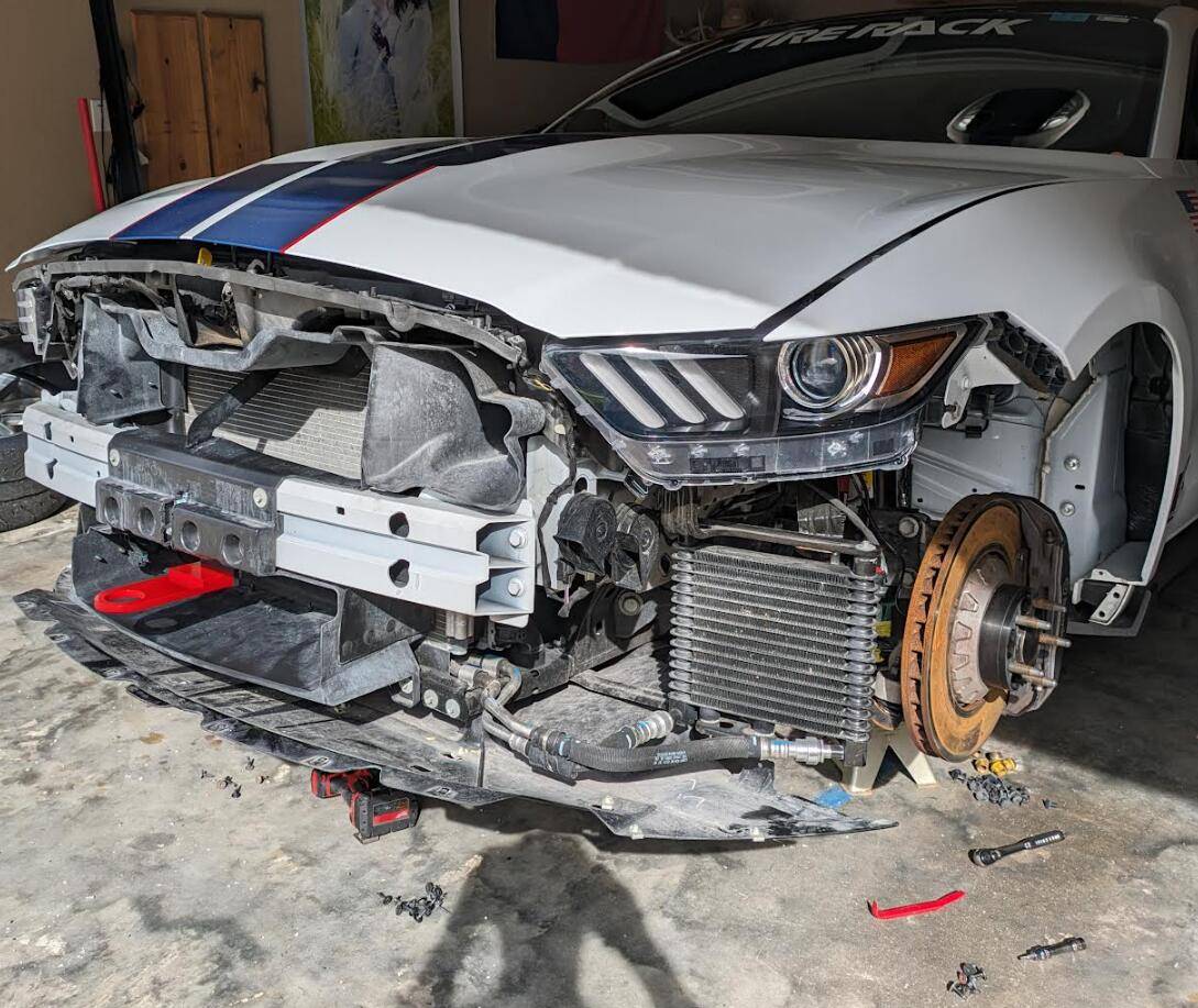

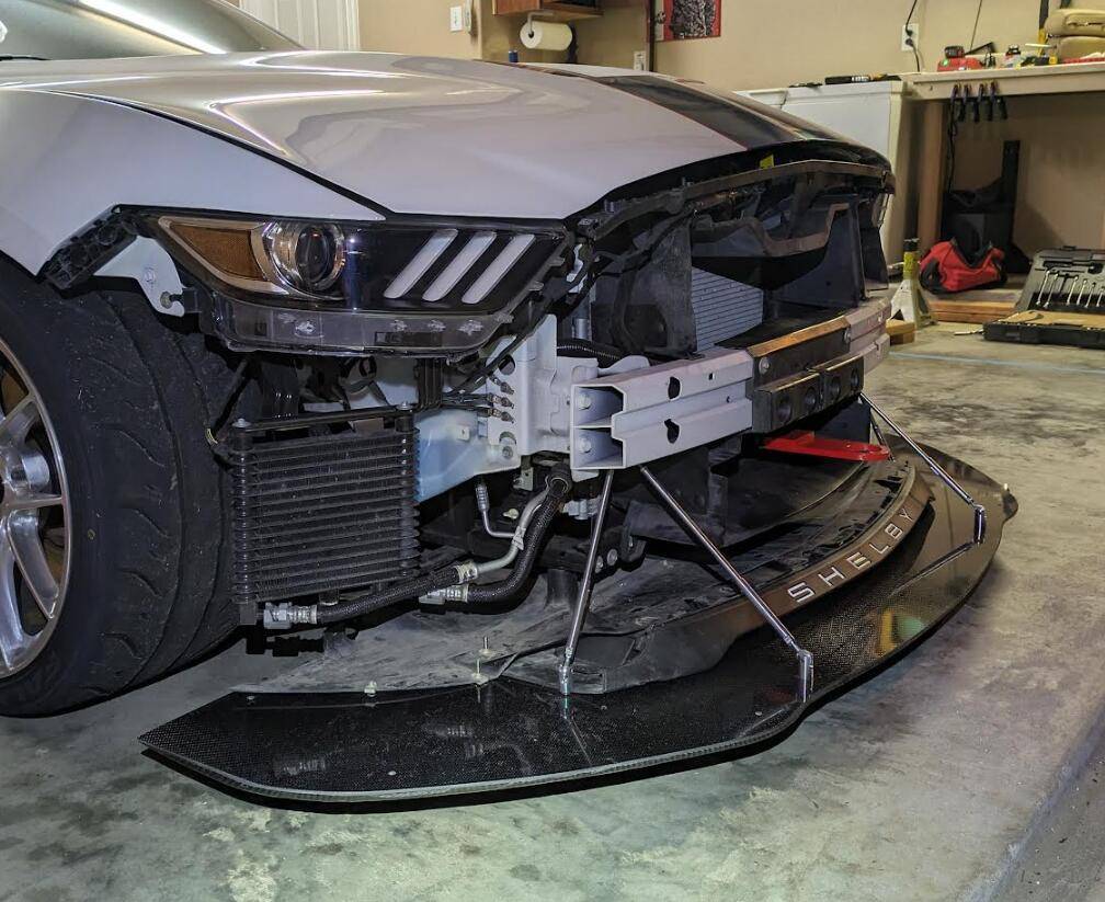

To be clear on the gaffer tape, I am suggesting plugging the vents in the wheel well liner (Photo from my car below), and not putting tape on the cooler itself. That way, you don't have to remove anything, and you aren't inadvertently collecting rocks/road crap in the radiator itself.
That said, if you pull the wheel well liner, I seem to recall enough space around the cooler that you could probably work your hand around it to put gaffer tape on the front of the cooler once you remove the wheel well liner.
FWIW, the bumper removal is pretty easy. If you haven't done it before, it seems a bit daunting, but it really isn't bad at all.
Awesome. Good to know I might be able to reach the front of the coolers through the wheel well. I'll do the tape first and see how that impacts temps. Really appreciate your input.

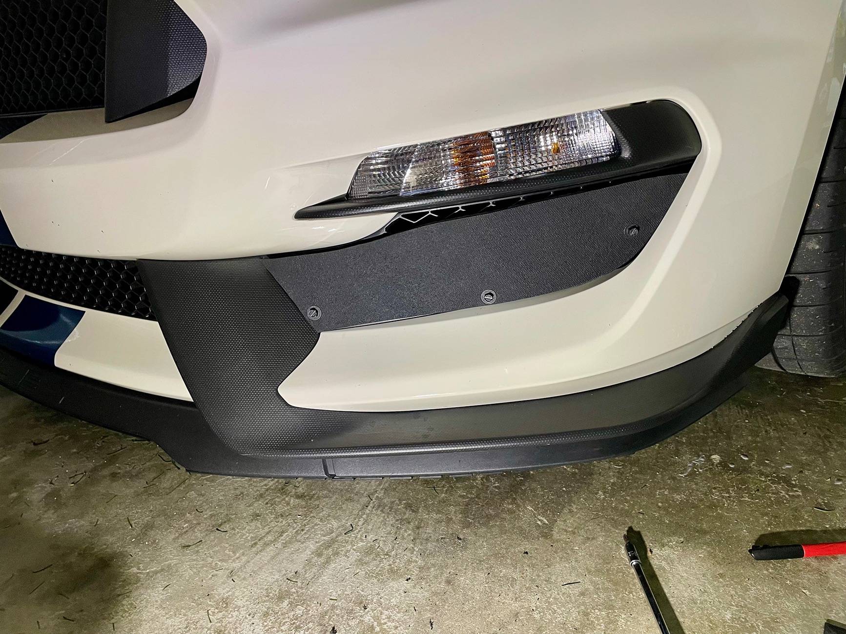

threw this together tonight. Just a prototype, but will give a decent idea of air flow restriction. I’ll report back.

Quick follow up for any cold climate people following:
Gained 10 degrees on the commute. Lingering around 180 during cruise and moderate throttle. Makes me feel much better.
Anyone savvy on transmission temps? With the cold, I’m not even getting to 100. Rear diff gets to 120ish. Wondering if I should flip the prototype and copy it for the right side trans cooler duct.
