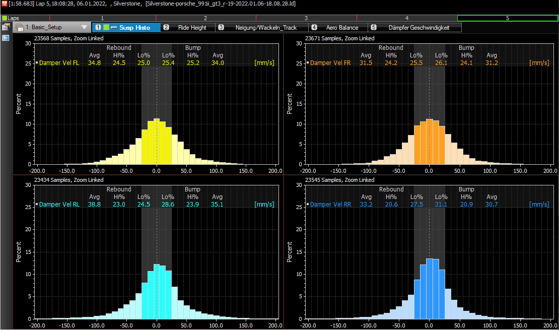

Fair question. Let's say we're talking about the front end. As we stiffen the front spring we're controlling the front ride height of the car on the brakes and the responsiveness to input. We'll be able to ramp up brake pressure faster on the stiffer spring, because we've reduced both the time the car takes to react and the magnitude of pitch due to braking load. Further, we can turn the steering wheel at a quicker rate because the car will accept a cross-load. Anti-roll bars can provide some directional response, but they produce their contribution during and after the car has rolled. Dampers can't support the car if they're not moving, so their importance comes in as the car is rolling. Neither can support a load as you initiate steering. That's why big front springs feel so good. Their influence takes effect the moment you turn the wheel.
The faster you can load the front tire, without just blowing through the tire grip, the more rotation you can produce early in the corner while you still have the nose loaded with the brake. You can raise the front spring rate high enough that it loads the tire faster than the tire can accept that load, so there is definitely a point of diminishing returns, but that point is usually a lot stiffer than people realize.
There is a school of thought (I think it's an over-simplification, but let's go with it for the moment) that if you plot a histogram of your shock speeds that it should roughly appear to be a normal distribution. If 'x' percentage of time is spent at a range of 2-3 in/sec in compression, then it should be roughly the same in 2-3 in/sec in rebound. Similarly, if you're seeing 20 in/sec peaks in compression, then you should see something similar in rebound. This is all 'rule of thumb' stuff. There's no mathematical justification to this that I'm aware. While I don't accept this concept as some sort of gospel truth, I do think it's a useful tool to use as a sanity check.
Here's an example I pulled off Google:
At the end of the day, here's my cheat. If you find yourself turning in with your fingertips on the wheel as opposed to grabbing the wheel with your fists, then add front spring. Whether you feel it or not, if you're using your fingertips, then your car lacks stability on corner entry. It's the bane of my existence.
