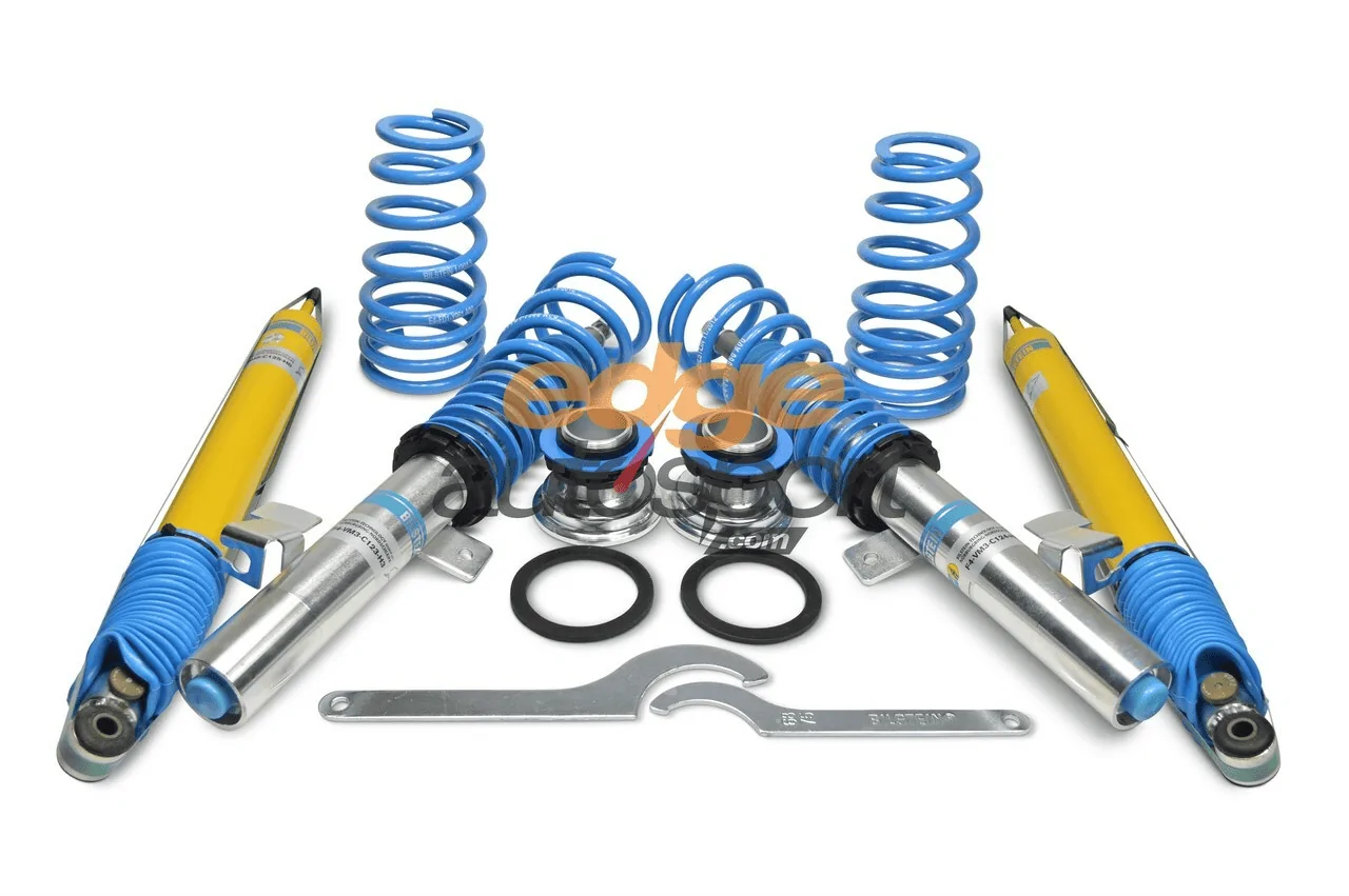

Steeda pro-action adjustable also come in coil-over config for the front. The biggest 'problem' with coilovers (painting with a broad brush) is VASTLY too much spring rate for day to day use and much too lowered and short-stroked.
Unless you have a rabid fascination with suspension and the desire to tune your car, stick with any of the quite good solutions already mentioned and a *correct* alignment.

that is the one redeeming factor in FA's favor. The Bilstein "coilover" likewise does NOT have ride-height adjustment independent of spring preload.
With FA I add as much preload as I want to support the car and yield the desired amount of stroke on either side of the the balance point. Then I can twist the shock body while keeping those settings and raise and lower the whole car to suit. In theory (the relative lengths of the tubes doesn't allow unless you pick different components) I can have the full 2.5" of bump travel and 1/2" of top-out travel, and STILL slam the car 2" down.
