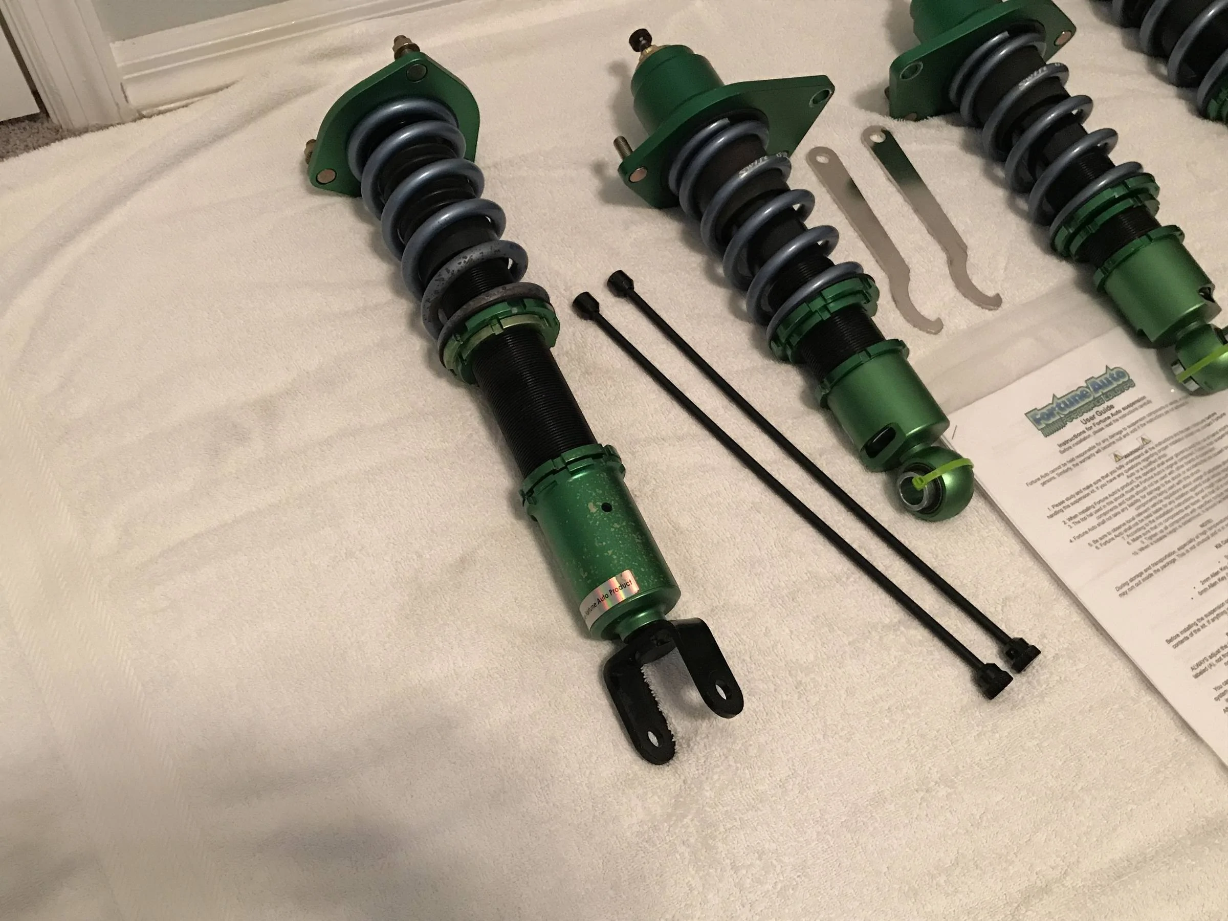

the JRI/Cortex shocks as pictured, as well the BIlstein, Ohlins and Steeda 'coil overs' all set ride-height as a proxy to spring preload. Spring preload influences the balance point of the piston in it's stroke. If you want the piston all the way at the top (less body drop) you crank on the preload until you have no more adjuster or you've hit the mechanical stops. And you still might not get there. Note how many, many coil-overs state they have a minimum of 30mm drop compared to stock? You're SOL if you only want 20mm drop, you can't get there.
If you have independent ride height adjuster you set the piston in it's stroke where you want it via preload, but then you have a separate adjuster method that lets you functionally change the length of the eyelet-to-eyelet and thus the height of the car.
This is a very crude example.
The one saving grace of the shocks from eg. Fortune Auto is that the lower mount is a threaded cup so by spinning the body you can change the total length by up to an inch.
