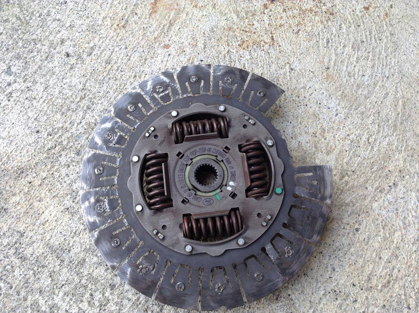

Ha, you to eh?! Here is mine after a high RPM shift.
