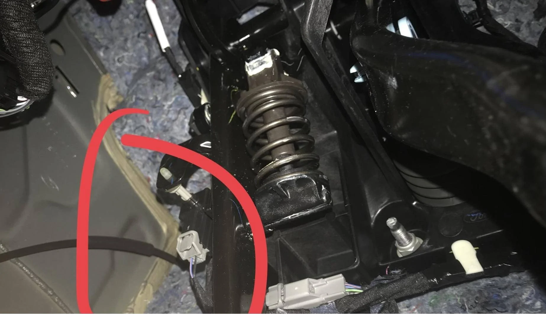

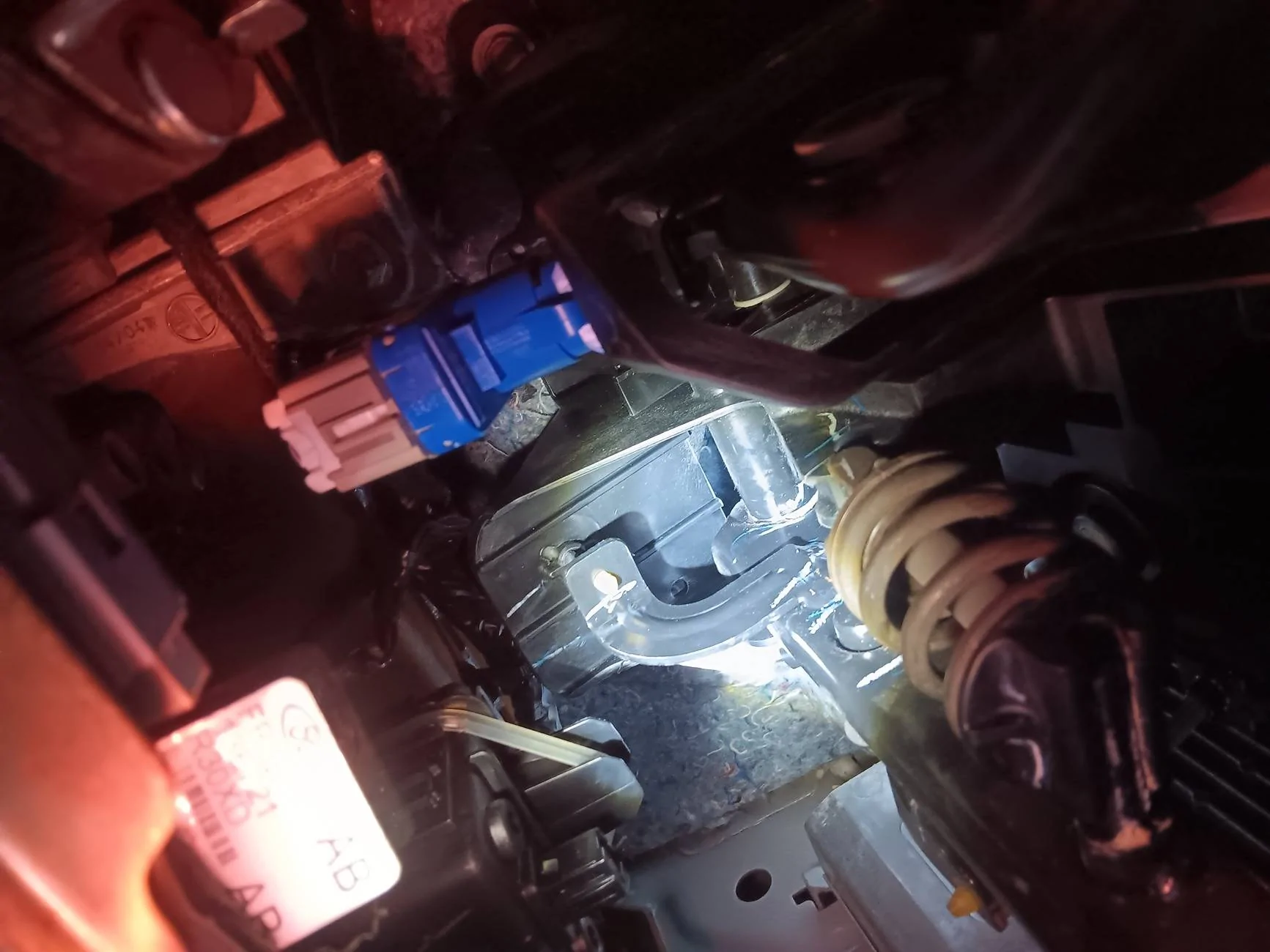

Having an issue with my clutch pedal on GT 2015. When I press it down, it won’t go all the way to the floor unless I manually push the pedal to the right. Once I do that, it fully depresses. My car requires a full press of the clutch to start, a task that requires multiple attempts to start. I also noticed the pin isn’t flush compared to other examples I’ve seen.There doesnt appear to be any cracks anywhere. Has anyone else run into this or have any ideas on how to fix it? Any help would be greatly appreciated!
here is mine
here is a image i found online. Disregard his red highlight. the pin tothe right is flush

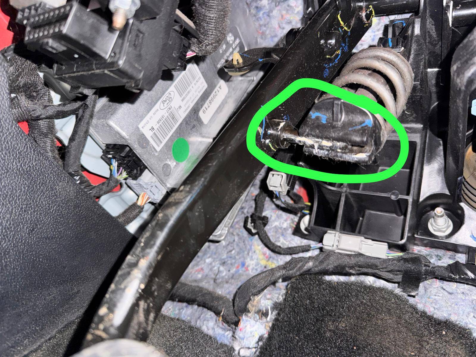

I would look at the pivot point, maybe there’s a bushing that is worn out. Or a weld that is broken, I think these are known for that. You shouldn’t really be able to move the pedal left and right. Also, what’s with the blue and yellow marks? I usually only see that on salvage parts.

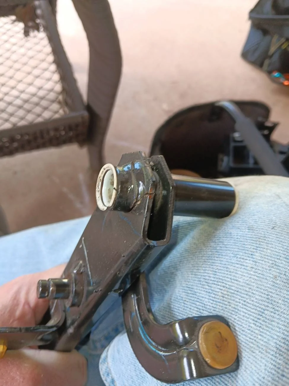

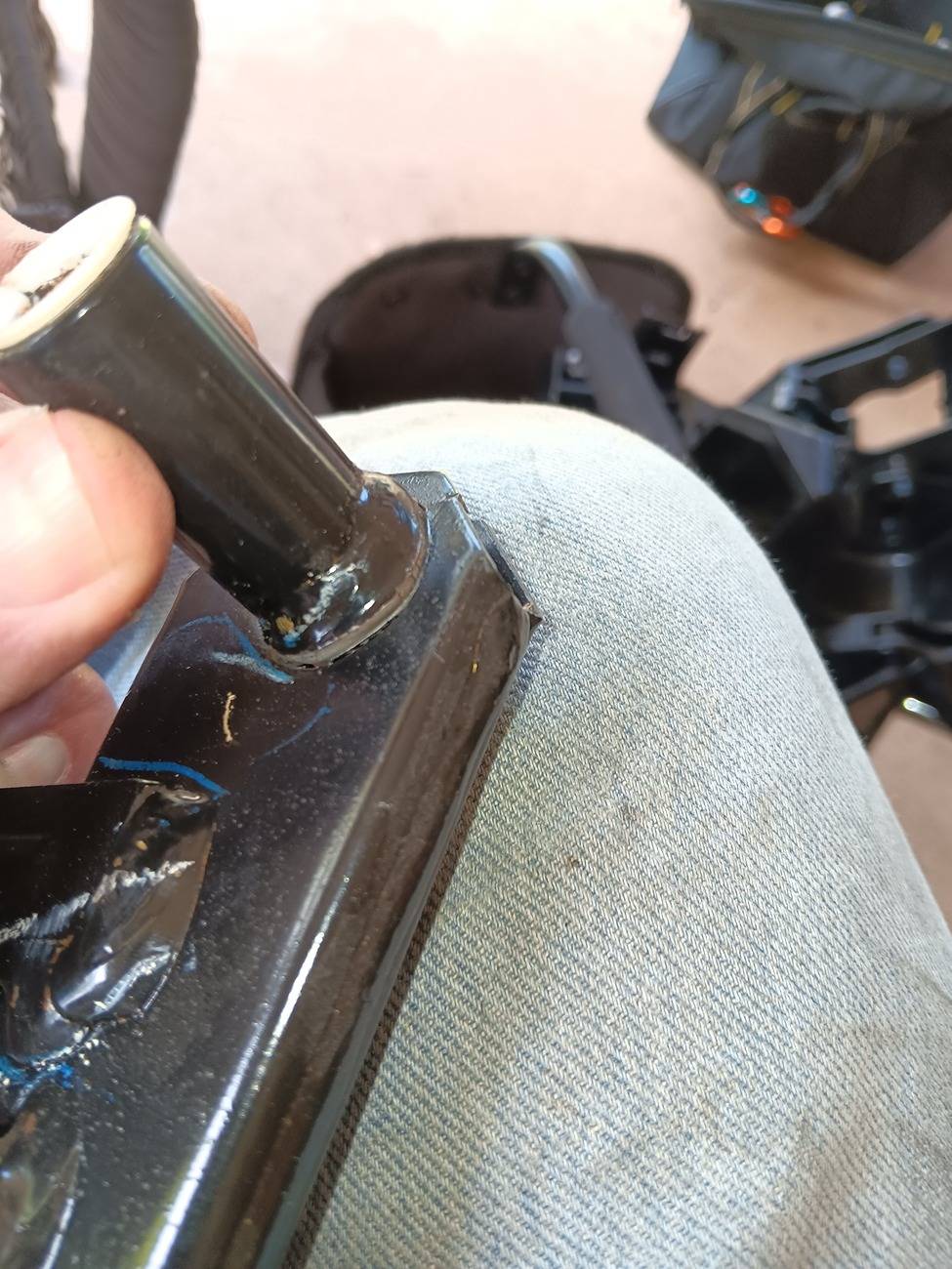

Did you get your issue diagnosed and repaired?
Mine had broken welds.
Some photos for reference.
