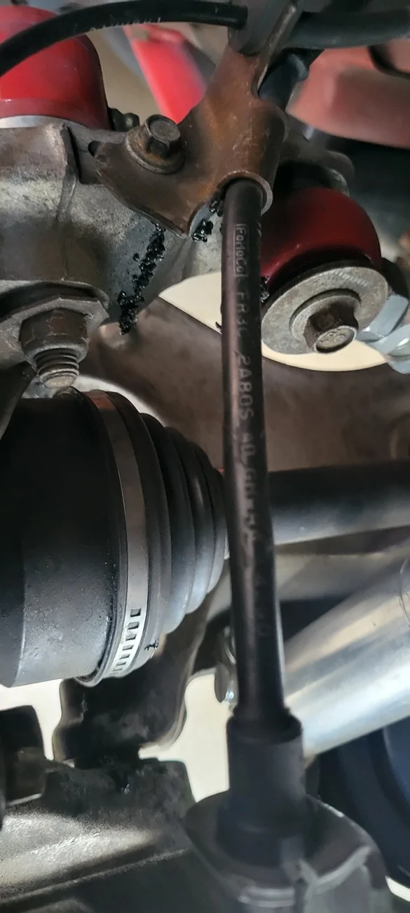

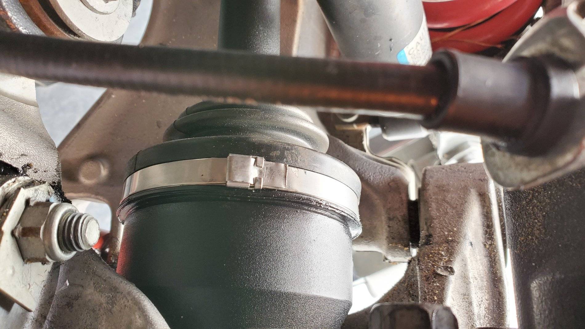

Replaced the clamps for the 3rd time today except this time I installed about a 4" section of clamp centered underneath the buckle area. This has reduced the bunching up of the boot in that area, which is where mine were leaking. I haven't been able to drive the car yet, but we'll see how it goes. I'm attaching a pic so you guys can see how the boots look now.

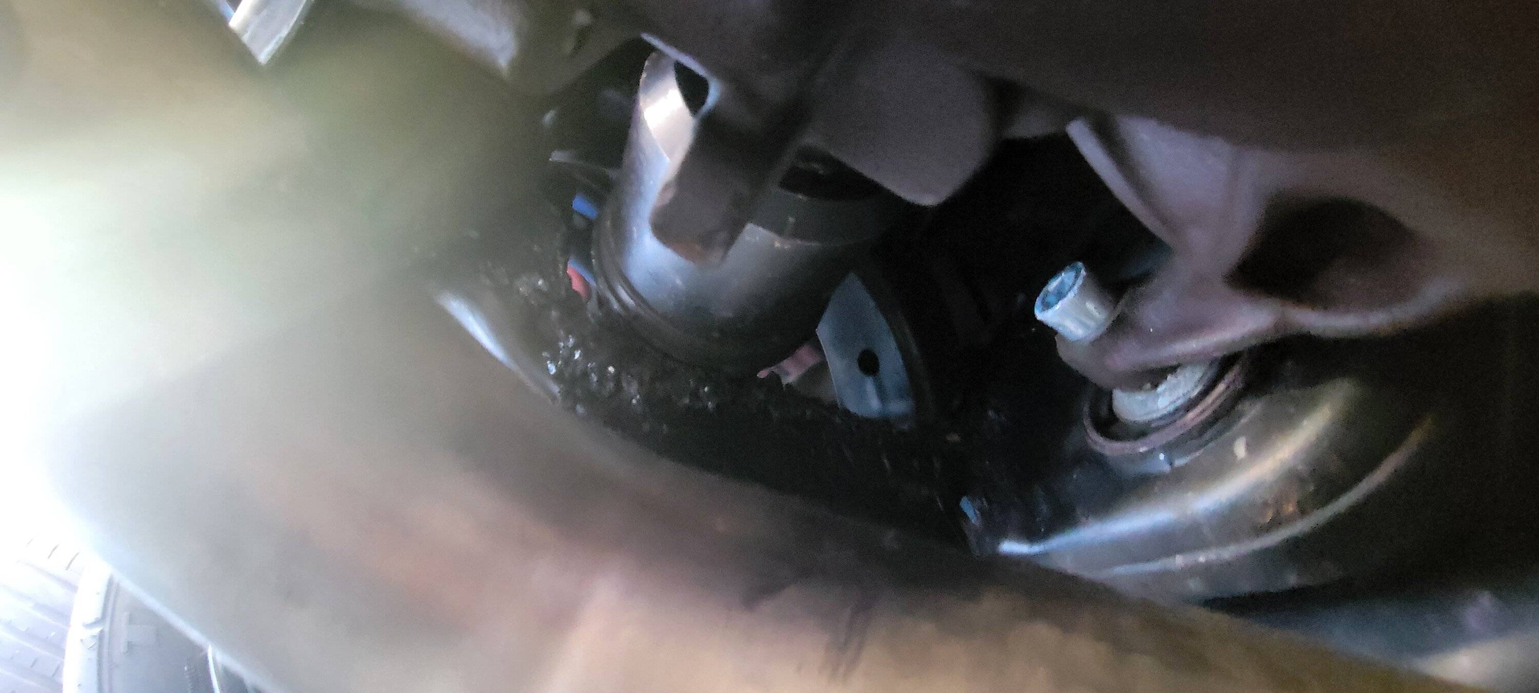

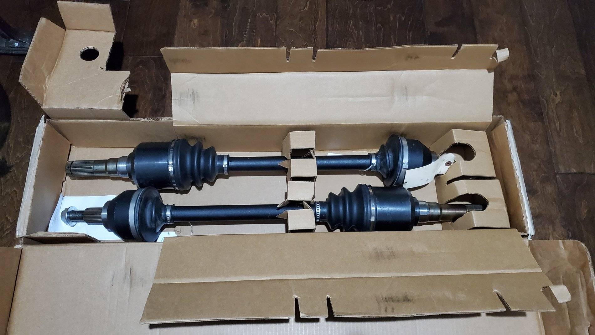

Update:
My "fix" worked well, but then busted the rear diff bolts which tore up the outer boots on the axles. Just got em back from DSS and noticed they switched to a different boot on the outer cv joint.
