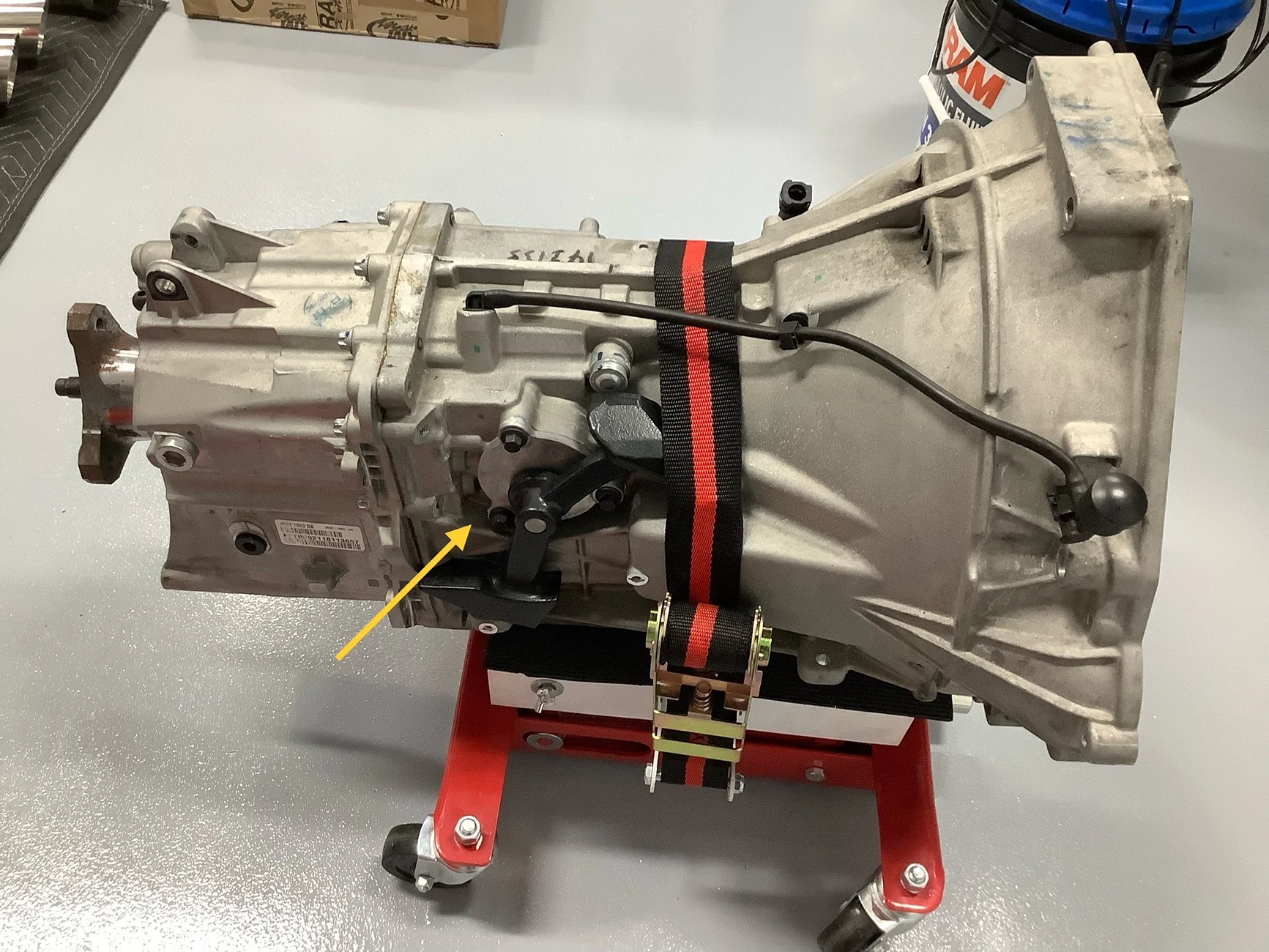

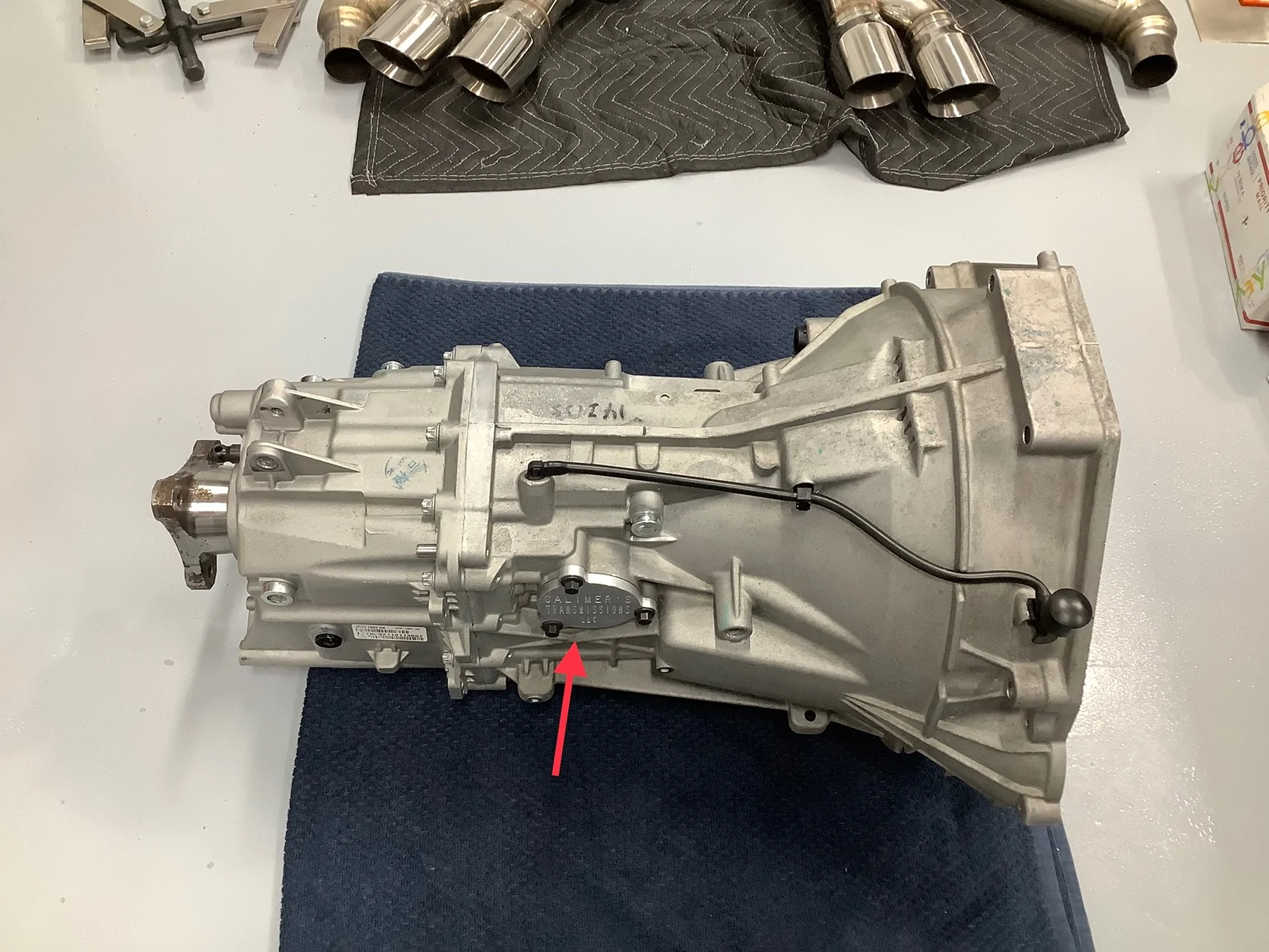

It might be the counterweight on the right side of the tranny. Try sliding underneath and holding the counterweight still and see if the noise goes away.
Some people have reported that the retaining pin broke and the weight fell off, while others have removed it and installed the Calimer block off plate. That’s what I did on my build.
