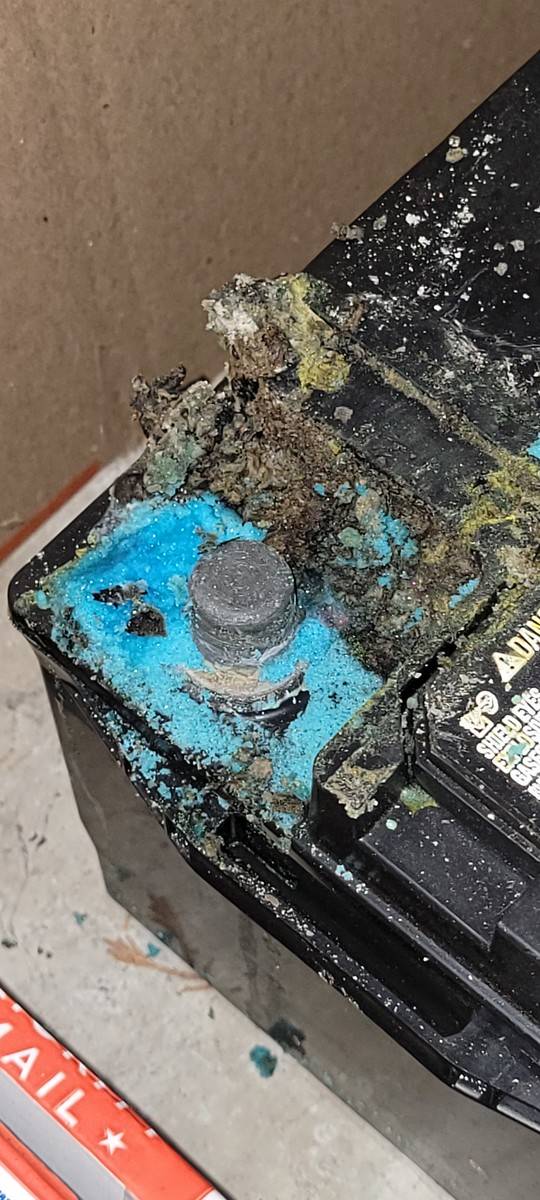

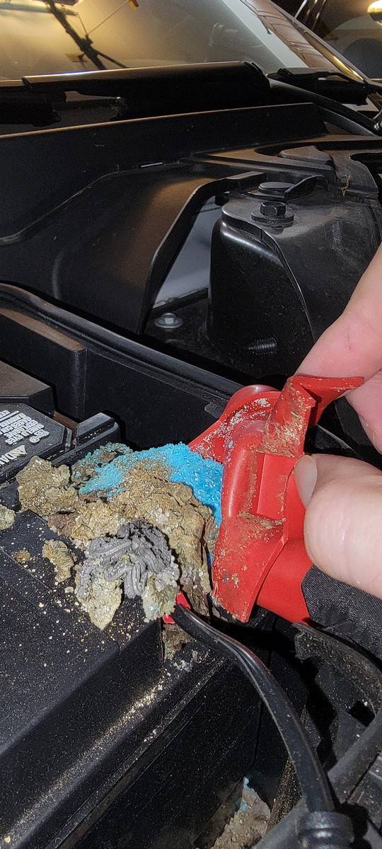

So when I pulled the battery cover off (last time I had this off was winter of 2020), I was greeted by this
Never in my life have I had a lead-acid battery fail so spectacularly.
Now for reasons unknown to me, Ford made the negative terminal clamp swappable, but not the positive terminal clamp. The stud that the clamping hardware sits on sheared off on mine due to the corrosion, so this left me with 3 possibilities.

I ordered the edge/MKX clamp as per the SSM, Ford states you can un-crimp the factory clamp and crimp on this new clamp to fix the problem. Since it was taking ages to actually ship out, I started thinking if I could fix what is already on my car. Turns out, yes. This is the least labor intensive route to go, which is always my favorite.
The nut/stud assembly that actually forces the terminal clamp closed is the same on the positive and negative side clamps. So I ended up taking apart my negative terminal clamp, and swapping the stud and hardware to the positive side.
Success! The positive side was back in place and clamped down. I then went down to my local dealer and ordered a new negative side (FU5Z-14450-A) and swapped the whole new assembly to the negative cable (my original one was starting to corrode on the bottom)

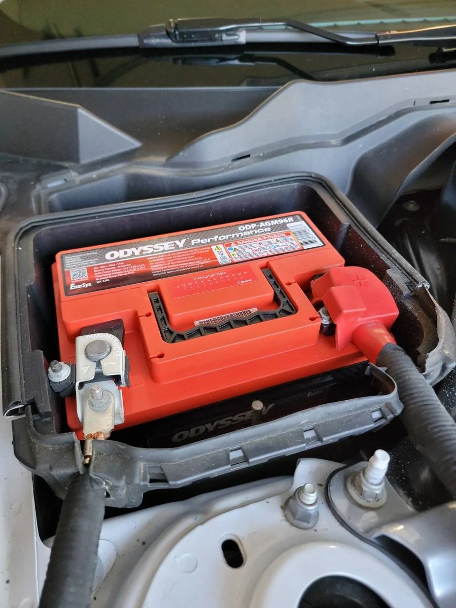

I replaced the factory battery with an Odyssey AGM96R, I looked into the XSPower battery but didn't want to roll the dice if I was going to any weird fitment issues (some did, some didn't).

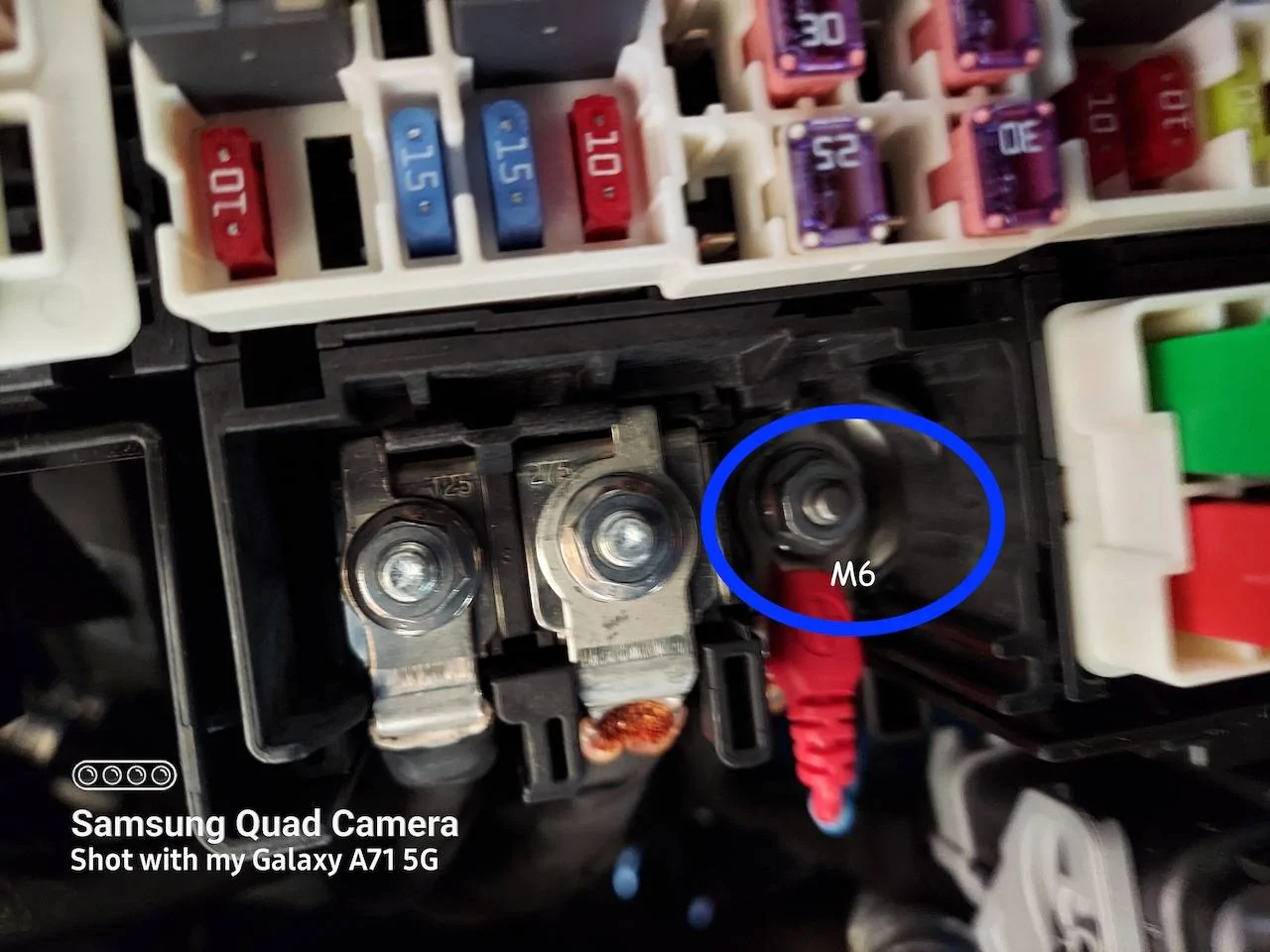

Side note: I keep this car on a deltran battery tender every winter. I had the tender hooked directly to the battery which during this debacle I've learned is incorrect. The correct way is to hook it to the leads going into the fuse box so the battery monitoring system can see the change in voltage that the tender is providing. Example here and here. I'll be making this change.
https://www.levittownfordparts.com/sku/w716510-s300--x4.html
Multiple sources/prices for connectors, so they are easy to find, get best price.

Looks like a slow overcharge condition or the internal post seal failed. Leaking electrolyte up through the posts will cause corrosion quickly. Guess I got lucky. I just replaced my original battery from a build date of 4/2016. It was still OK, but reserve capacity was getting lower, and cranking had slowed over the past year. Battery posts were still dry and spotless thankfully.
