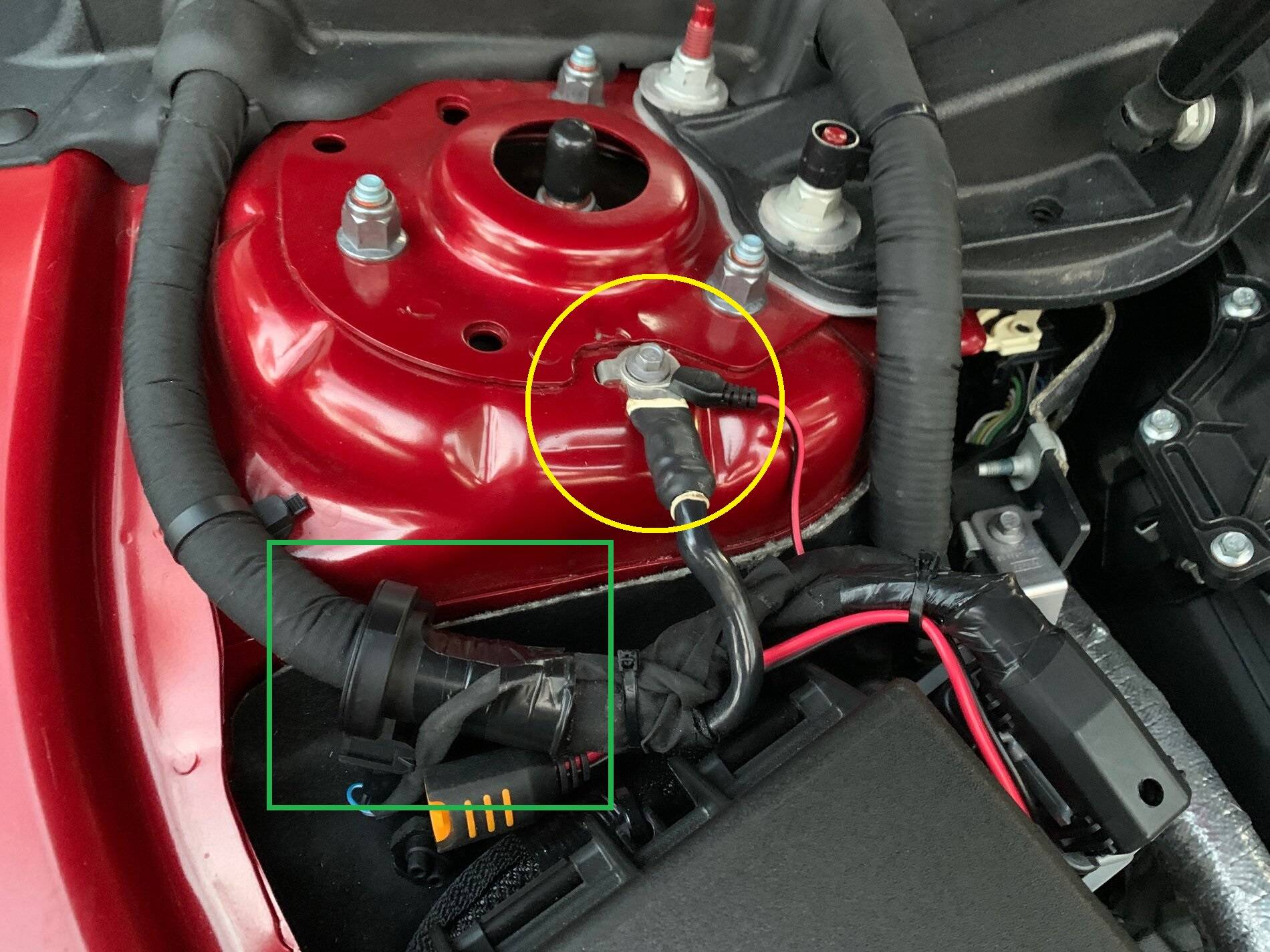

If the car is parked for "a few days up to couple weeks-ish,' it helps to lock the doors with your remote until you hear the horn honk. What this does on some newer cars (especially Fords since the mid-late 2000s) is that it puts the car in a timeout mode and then triggers the vehicle modules (most of them, not all complete) to go in a deeper sleep, thus consuming less power - so long as no key is pressed on the remote. It is the numerous modules on modern cars that really suck up a lot of power, even just sitting.
When the car is left unlocked, the modules are still 'awake' and there is constant communication attempted with the key/remote, which also helps drain the battery more.
Of course, if storing for the winter/long term, doing the above is useless unless coupled with a tender.
When using a tender, the neg terminal should be hooked up to the ground wire on these cars, which is just before the BMS unit, so that a continues trickle charge doesn't interfere with it, and monitoring the battery health.
As many have correctly stated though, the batteries these cars come with are adequate at best, and after sitting idle for even up to 2 weeks, many of these cars fail to start (due to drainage) when cars of yore could sit weeks on end, and fire right up.
ETA: For those wondering, this is how to hook up the negative terminal from a tender, to these cars (Yellow), which is before BMS Sensor (Green), with respect to direction of travel to the battery itself. Note: original pic from the GT500 forums which I edited for the post

It makes a difference in the short term.

cmxPPL219
Could you provide some more info on the why ?
" When using a tender, the neg terminal should be hooked up to the ground wire on these cars, which is just before the BMS unit, so that a continues trickle charge doesn't interfere with it, and monitoring the battery health. "
I am curious as to why bypassing the BMS is an issue.
I appreciate your thoughts.

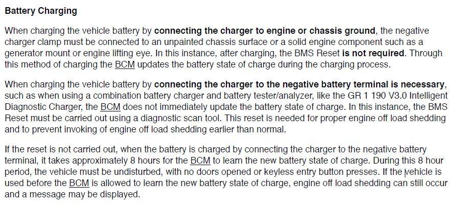

Yeah for sure - below is a bit of en explanation:
Ford Battery Management System (BMS) connects to the negative terminal of the battery and monitors current, voltage, and temperature. The purpose is that if excessive battery drain is detected, the system temporarily disables some electrical systems to protect the battery and provide data to other systems which manage the charging rate and load-shedding (battery saver) features.
This can be witnessed when your battery's life is on it's last legs, and certain things like heated seats, and various other accessories don't work randomly.
Battery Replacement - If the vehicle battery is replaced, it is very important to perform the battery monitoring system reset using the scan tool. If the battery monitoring system reset is not carried out, it holds the old battery parameters and time in service counter in memory. Additionally, it tells the system the battery is in an aged state and may limit the Electrical Energy Management system functions.
The BMS data is held in non-volatile memory (it is retained even when the battery is disconnected) and cannot be reset by any means other than use of an appropriate tool plugged into the diagnostics port on the car to send the correct 'BMS reset' command-code to the Body Control Module (BCM). (note - there is another way to reset, and one of them is not touching the vehicle for 8 hours, like explained further below)
Therefore, when you connect the negative lead to the negative terminal, bypassing the BMS sensor, the system has no way of accounting for the constant trickle charge, and the system will continue to charge the battery at a rate that reflects time in service and the other parameters, which, down the road, may lead to those ancillary accessories being disabled prematurely, when in fact, the battery is still very healthy, due to the constant trickle charge it was given.
Below, the first paragraph, for more "why:"

Thanks for the details of the "WHY"
