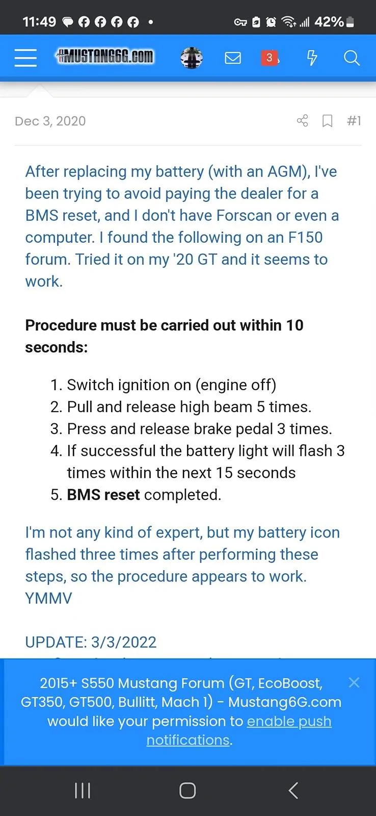

BMS - Car on, not running, pull blinker 5 times, press brake 3 times, battery light should flash. Your owners manual also describes this process.
I used this today on my 2022 GT. It did the trick.
