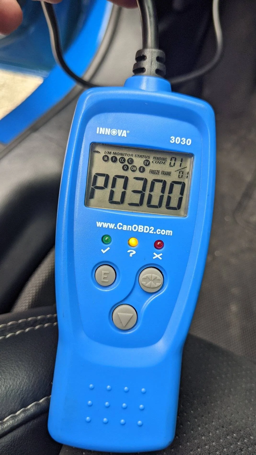

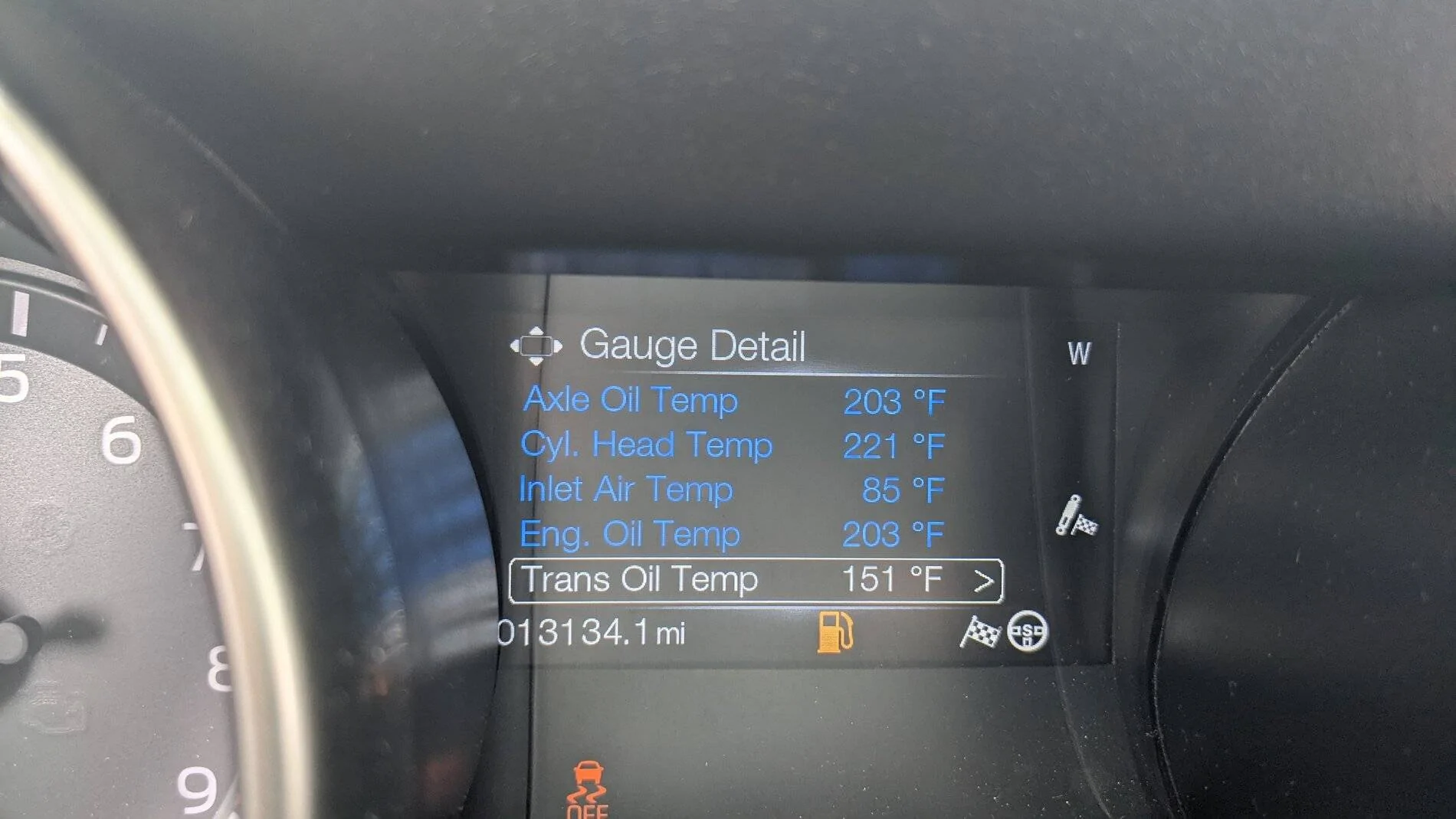

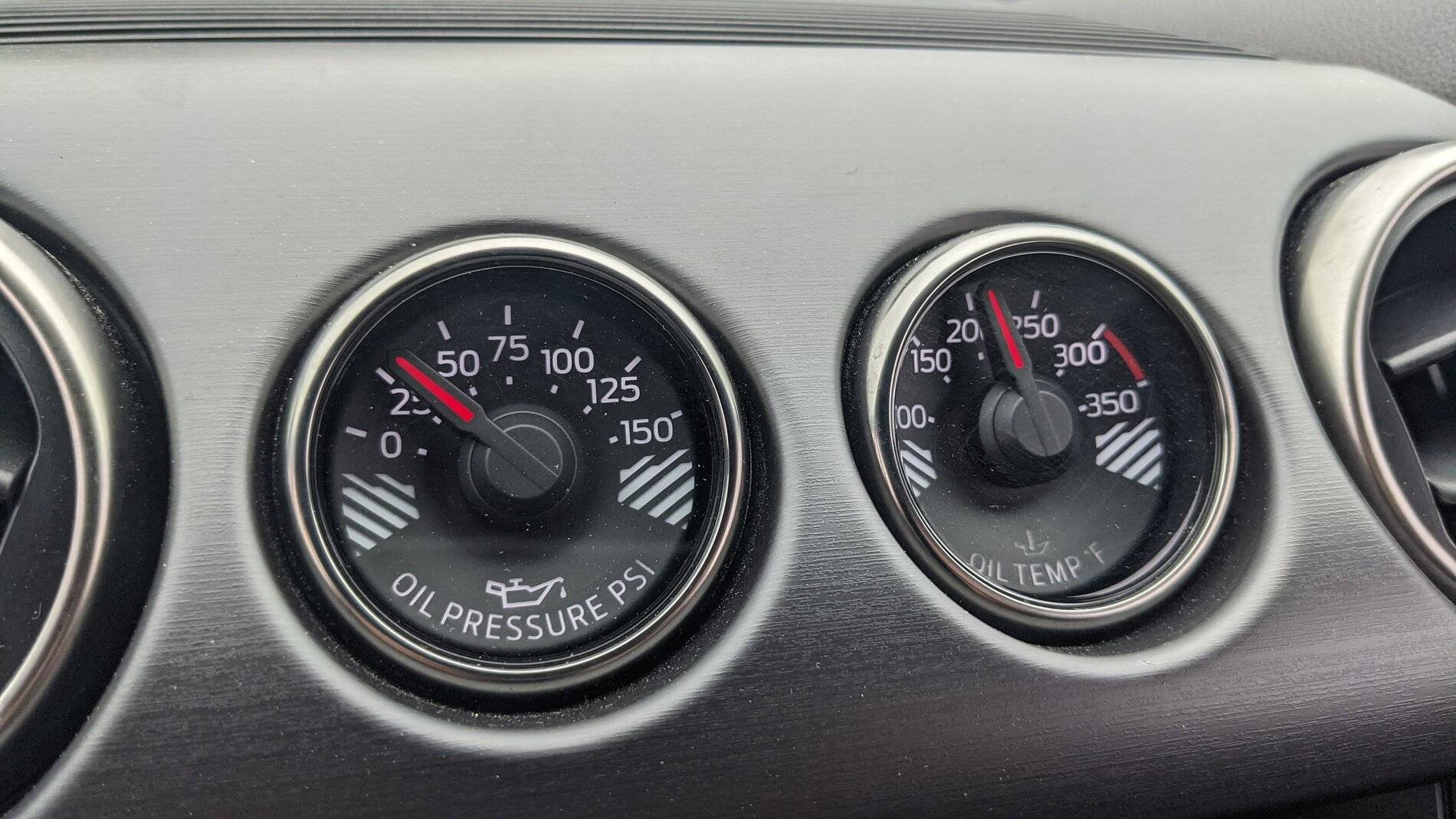

Notice it doing this is my last session. Only did it for like 5 secs then went off. Did not come back on. If I start the car now. No light.
Here are my gauges after session.
Thoughts? The diff seems super hot.

If you get a code reader, the answer will likely be stored in permanent codes. Otherwise, it’d just be a guess.

Probably not rear end or transmission overheat, as those will throw a check engine light and have a power reduction. I’m betting on coolant or oil over temp. If you’re still at the track, ask around, I bet 50% of everyone there has a code reader.

I’ve had this issue a few times - it’s always been related to an electrical issue of some sort. It’ll be the first code to pop up when a cylinder is misfiring - even when it’s only one that is having issues. When I had my injector and coil pack connections short out (separate occasions), I got this code first (both times). Later, the individual codes popped up when it happened enough to become a real issue.
I actually just had it last track day when a bolt holding in the #3 coil pack come out and the coil pack started to float up and cause an intermittent connection with the spark plug. Even though there was only one cylinder giving me issues, it threw this code.
In your case, I’ll bet you have a similar issue - some electrical connection related to ignition or fuel causing very intermittent issues.
