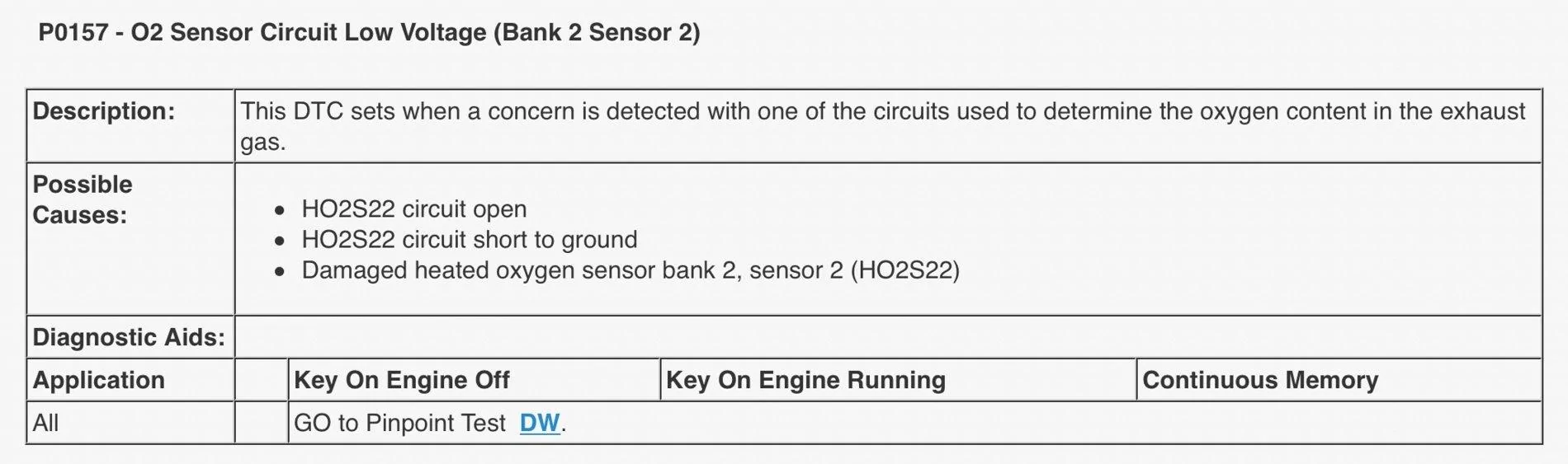

Car threw the code P0157 yesterday. It says it is because of low voltage at bank 2 sensor 2. I plan on replacing the O2 sensor myself. Can anyone confirm bank 2 is drivers side? I have been finding conflicting remarks on it.
Also, could this be associated with oil consumption? I’m going through a quart every 500 miles. Thanks

Bank 2 is drivers side on the voodoo
Either way, the downstream sensor is the same for both sides. So can switch them if needed (might be a good test).

Here ya go for confirmation:
