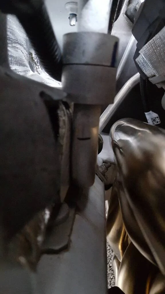

Too close? I'm running kooks headers but I'm only getting a max of 0.6 knock. At first I get -4 but around 5k it creeps up and then levels out in the -1 range.
Sent from my SM-G920V using Tapatalk
That looks good to me. :thumbsup:
I loosened the motor mounts and pushed the motor over about 1/4" just for peace of mind, I need someone to rev the car for me in order to see which way it rocks and how far. Seems much better than what some folks have to work with. Gotta get some torco just to be sure I've cured it and it's just bad gas...

Yeah, that looks like you have enough clearance to me too. Also check your O2's and make sure they're not contacting anywhere, and all of your connection clamps.

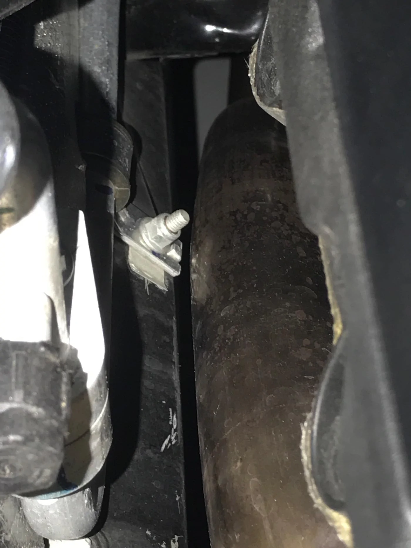

Does this look too close? Car pulled timing today during a WOT log for Lund due to false knock. Looks like the header may be nicked a little but hard to tell.

It definitely looks like it is making contact. Shift motor and remove or modify the bracket.

My car is pulling timing during WOT and my pulls don't feel nearly as strong.
I took a peak at my header bolt and I can see a clear scrape on my SW header. I would assume this bolt is touching the header during WOT.
Will filing down the bolt threads be sufficient enough to fix this problem?
