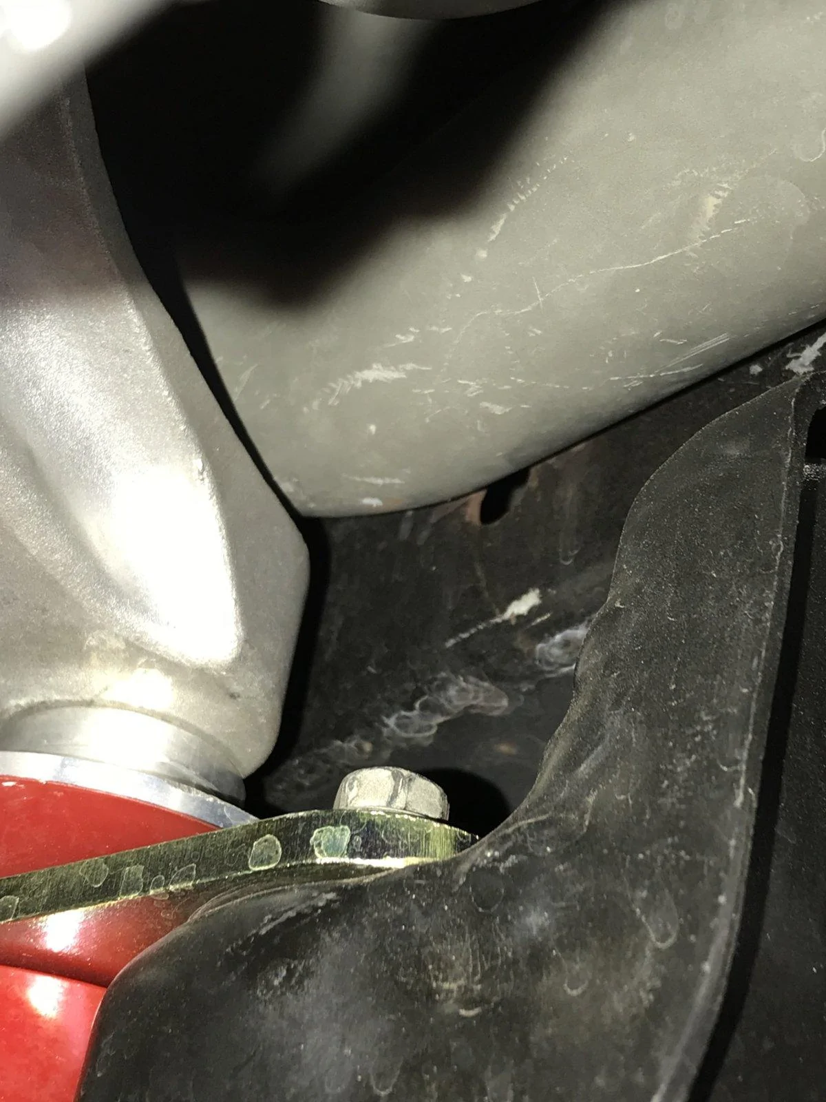

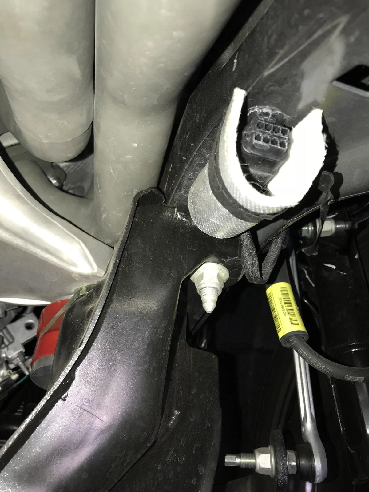

I’m glad I checked out this thread! I decided to look at my passenger side header, and it’s been making contact with the frame. Looks like I’m headed to the shop on my day off to fix this. Sorry for the poor pic. It’s hard to see because of the shadows

Problem solved! I moved the motor over as much as I could, but I didn’t feel that was enough so I heated up the header tube with a torch and forced a chisel between the tube and the frame. I have about 1/4”-3/8” clearance now. I data logged some pulls before and after. A little later I’ll check them to see what’s what

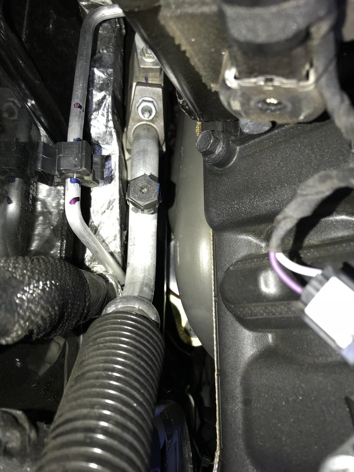

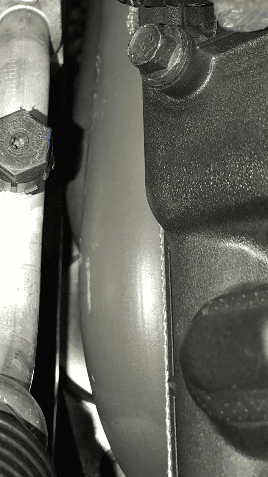

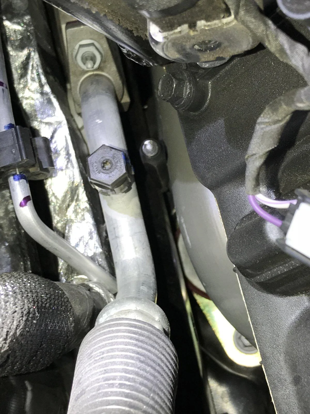

What size is the nut on the A/C brace?
