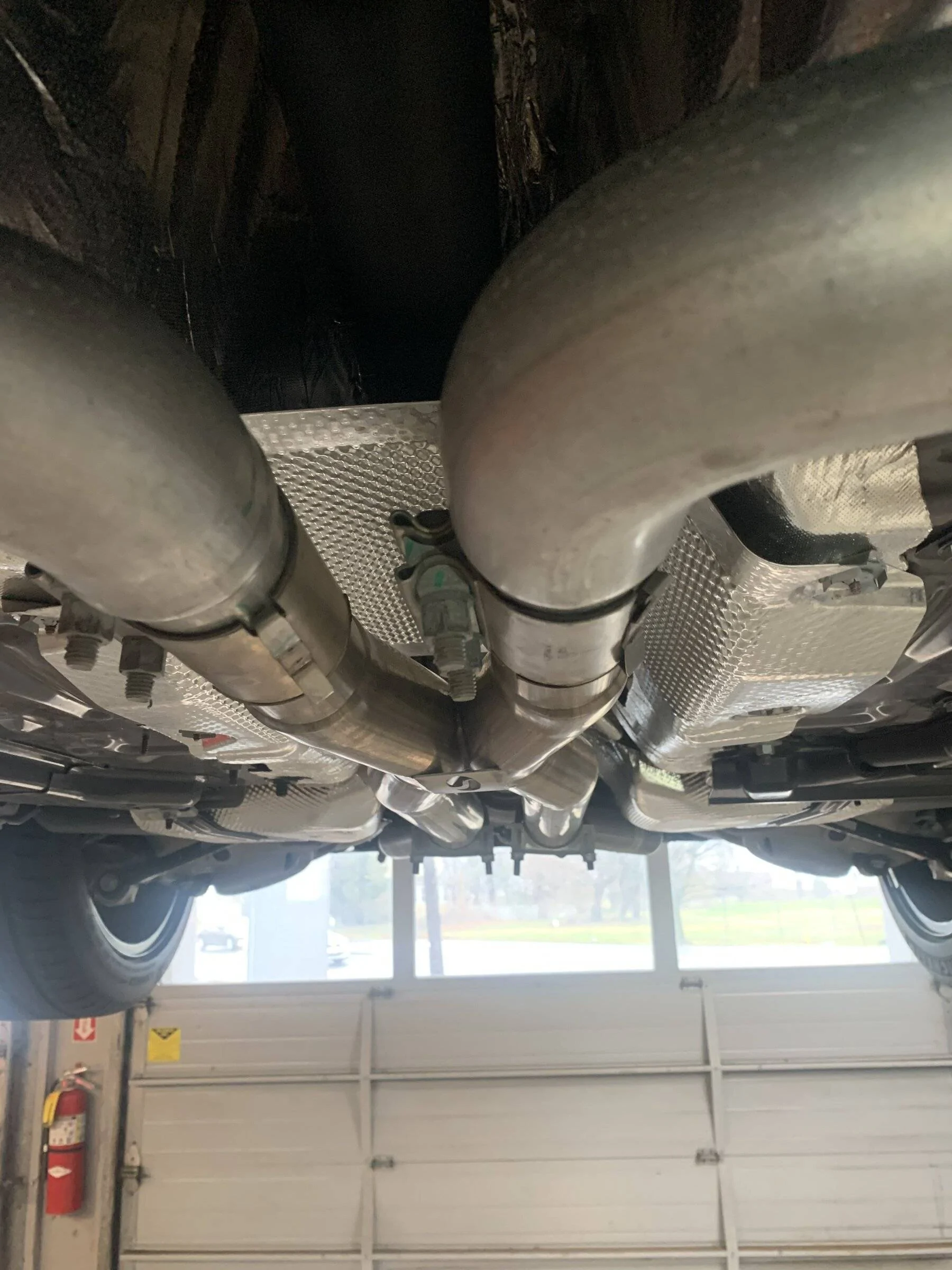

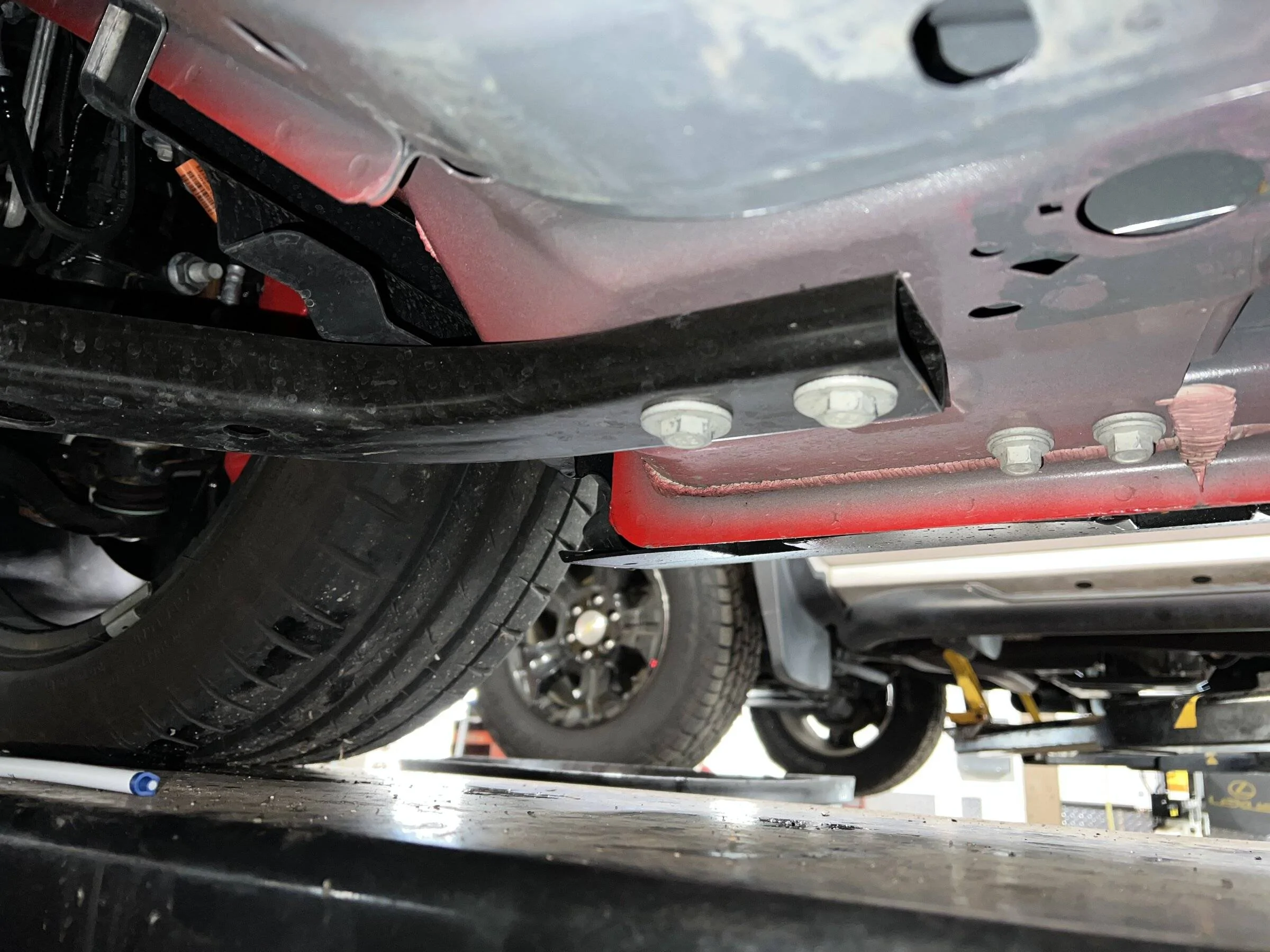

Picture #1: a photo that I took at the shop who installed the x pipe showing the area on the pinch weld that was apparently pushed upwards and bent the frame according to the service manager
Picture #2: a photo the service manager sent me showing the X pipe which was apparently installed incorrectly and ruined the exhaust system

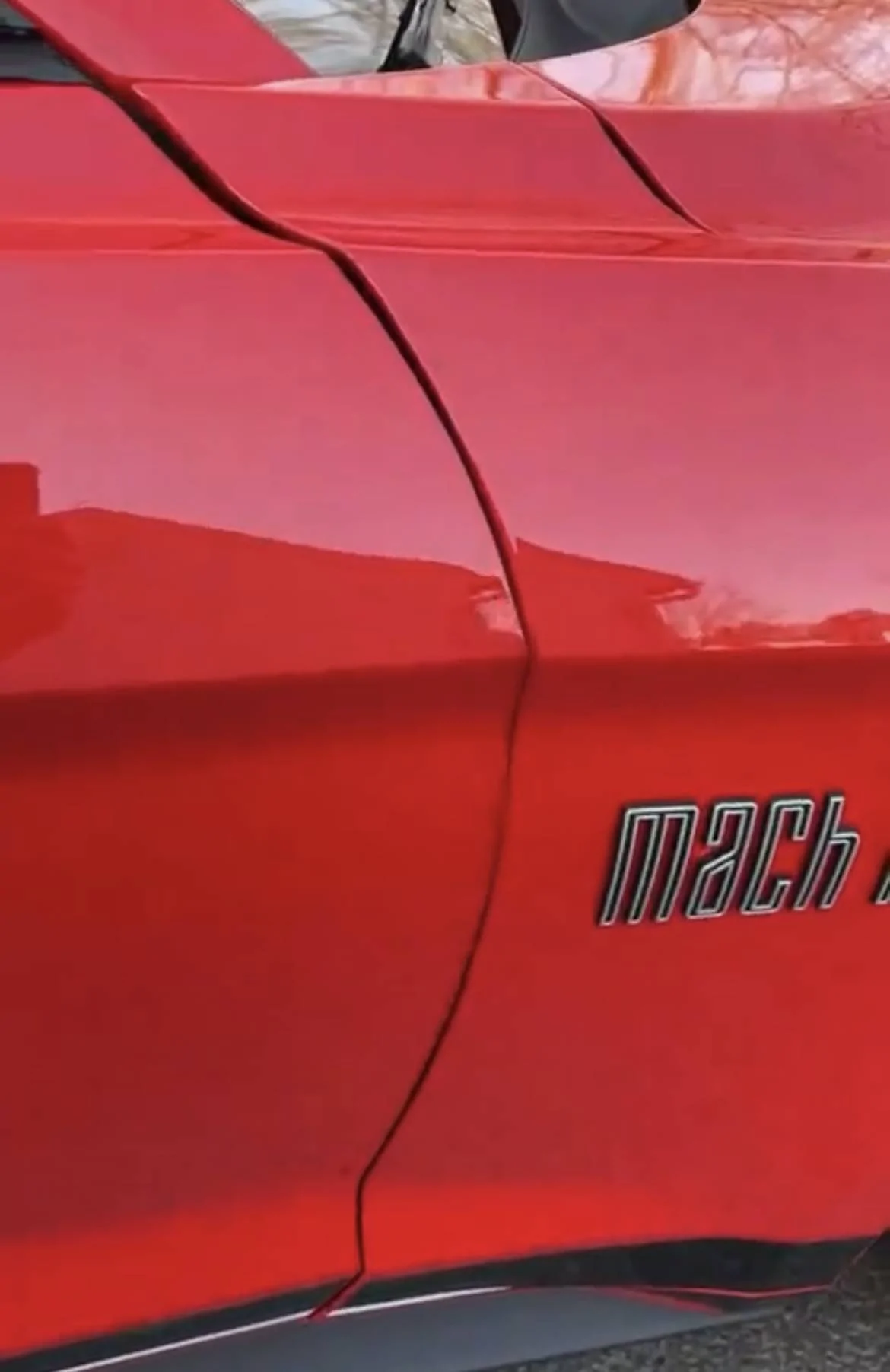

Picture #3: a photo I took before I brought it in to Chapman showing the door slightly opened and rubbing the fender

Looking at the pic you posted of the door to fender issue, I don’t think it’s as much a door alignment issue as it may be a fender alignment issue.
It appears the door to fender rub issue is the fender causing the issue. Look at where I circled, the hood to fender gap is definitely off. The fender is slightly raised where it meets the bottom of the A-pillar, and the hood appears lower. The fender should not be sitting higher than the hood in this area - both body panels should be at same height. The other thing is the gap between the rear of the hood and the top of the fender looks skewed…. I can’t tell if it’s how you took the pic, but when I make it larger, that gap is just weird looking like the body lines are not sync’d.

I agree completely with everything you said. Definitely looks to be an issue with the fender rather than door alignment. The body shop that looked at it actually said the same thing. To answer your other point, I was not notified, nor did I give authorization for anything to be done without warranty coverage. I really appreciate your response and giving your input on everything. I’m definitely going to take your advice on how to proceed
