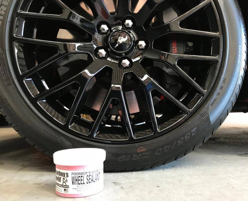

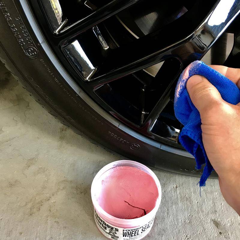

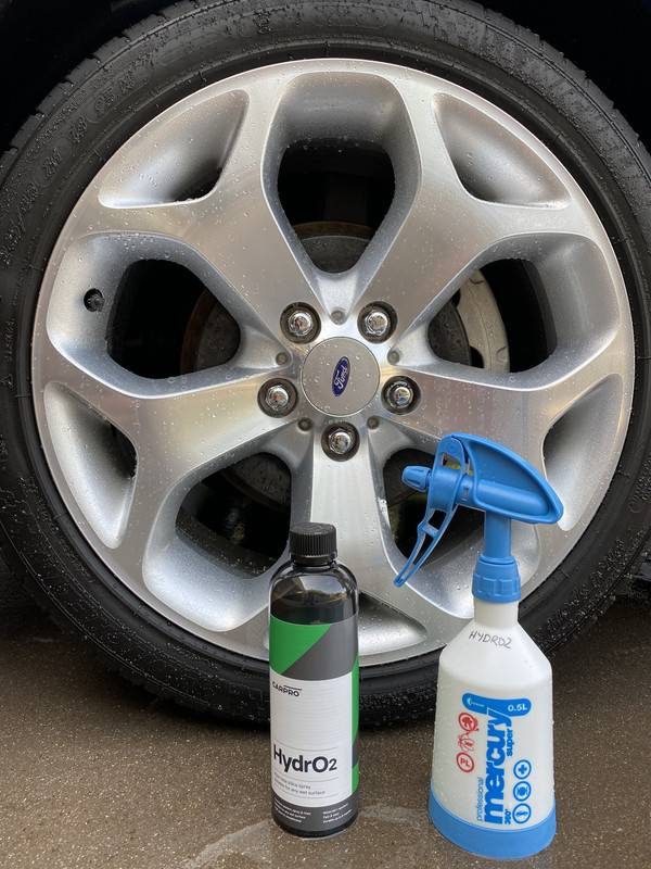

I used Poorboys Wheel Sealant for a number of years, loved how that stuff smelled. But a very time consuming process on PP1 wheels, and unless you removed them from the car, you wouldn't get coverage on the barrels.
I then moved to spray-and-rinse type ceramic sealants. Carpro Hydr02 and Gyeon Wet Coat, both allowing the whole wheel to be coated without touching the wheel itself, simply wash the wheel, rinse thorough, spray the wheel with the product and hose off immediately. Done. Longevity will be low, the quick and easy reapplication means that is not really a problem. I still use this method for all but my Mustang's wheels.

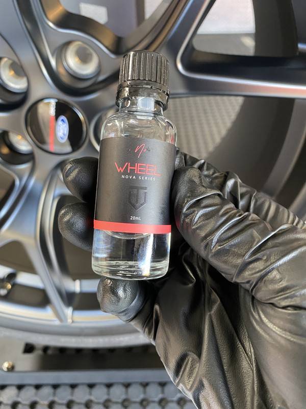

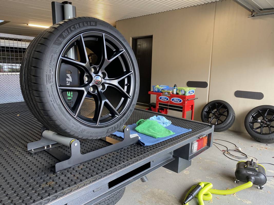

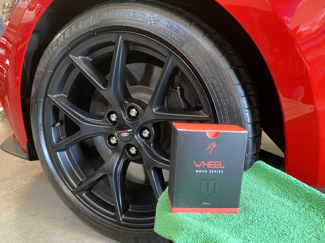

When I bought new wheels for the Mustang, I ceramic coated them before they were installed on the car, saving me the task of decontaminating them. I used NV Wheel, but Carpro DLUX is another good option.
The ceramic coating process is a bit more involved, especially if your wheels already have some miles on them, preparation is crucial otherwise you may find longevity will be limited, at which point you may as well just used the spray-and-rinse sealants.
I wrote this thread on the application process -
