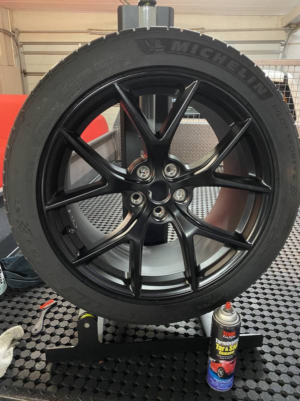

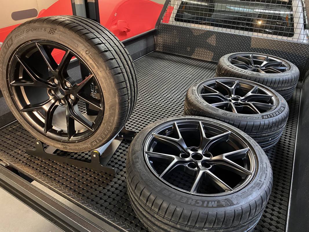

Having just completed this process on a new set of wheels and tires, I thought I would post some information for those who may want to try this themselves. My process for this also involved prepping new tires, which I have also included here. For those who will be doing this to an existing set of wheels, I will also note additional steps needed where appropriate.

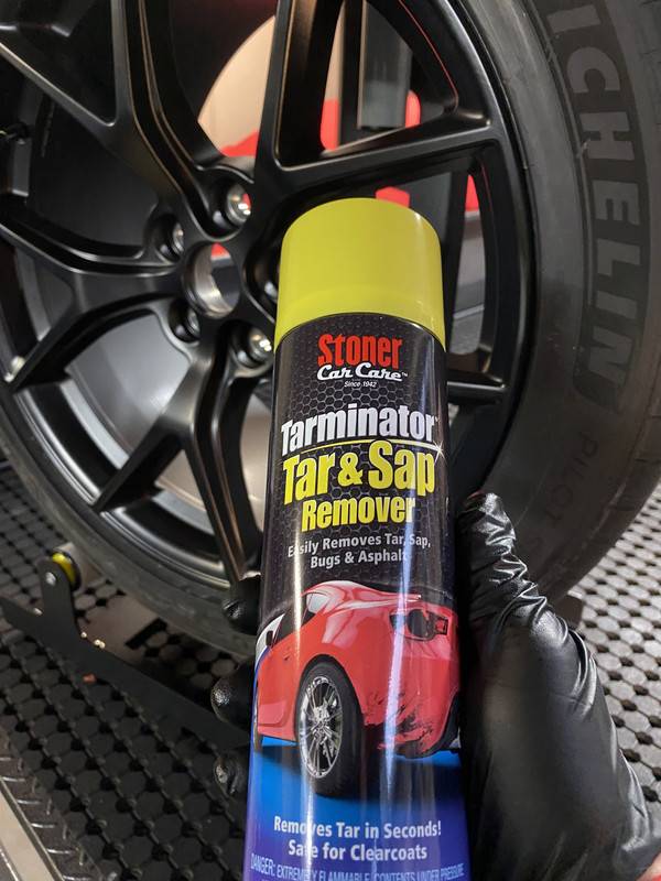

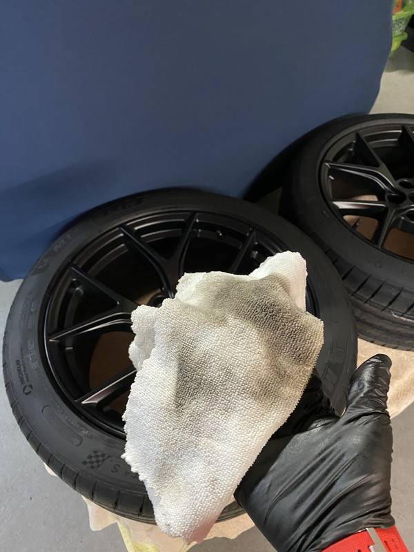

First step is to prep the rubber. Fresh, new tires are contaminated with mold release agents and fitment soap. This needs to be removed to provide a clean surface for a tire dressing to bond to. For this step, I used Stoners Tarminator to strip the tires bare. This product is generally used as a heavy tar remover but is excellent for tire prep too. However, many products can be used for this including APC, de-greasers and tire cleaners. The benefit of Tarminator is the ability to do the job without using water. You can see how grotty the tires were in the before pics –

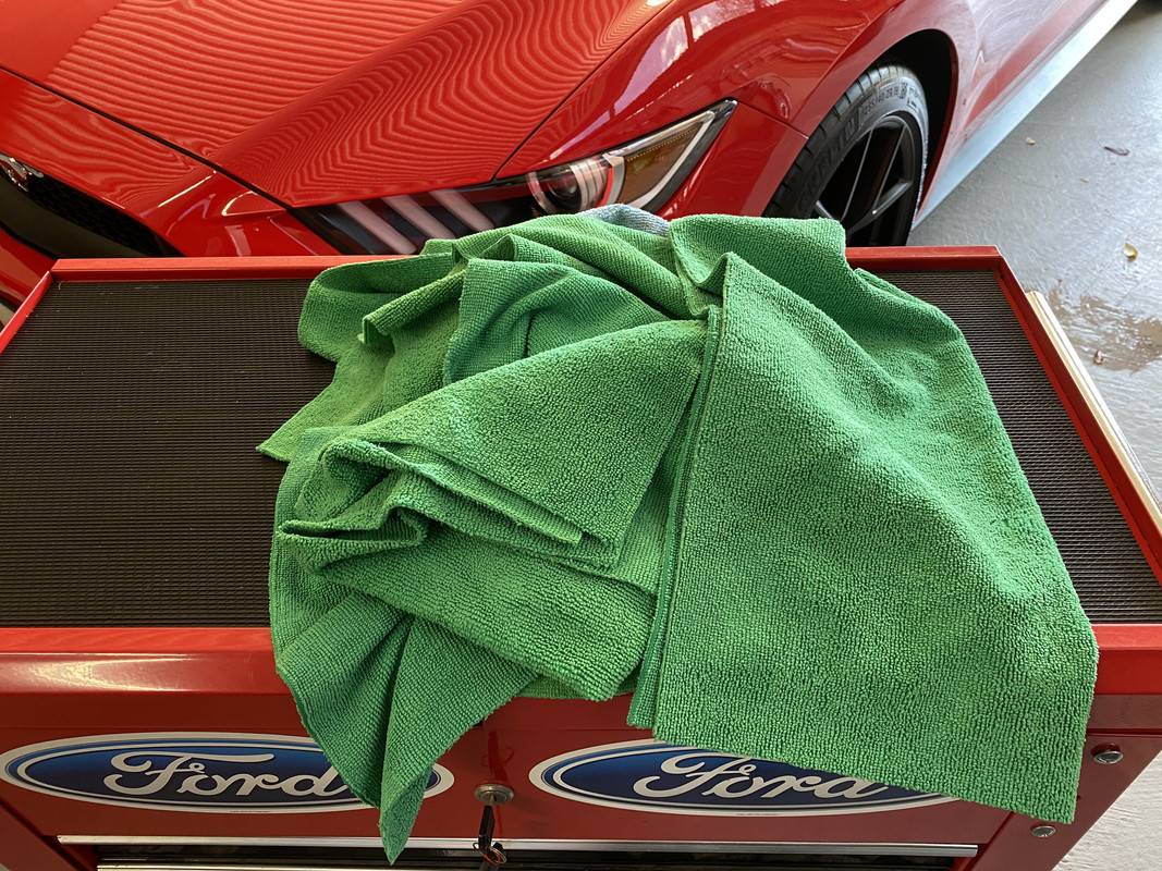

Tarminator is best sprayed onto a towel before scrubbing the tires clean. This stuff is extraordinarily strong, both in smell and cleaning power. I would show caution when using this around painted surfaces and remove any residue from over-spray/over-application. As you can see, this will ruin a towel so make sure to choose wisely. These white microfibres are basically single use items so I threw these away after this job.

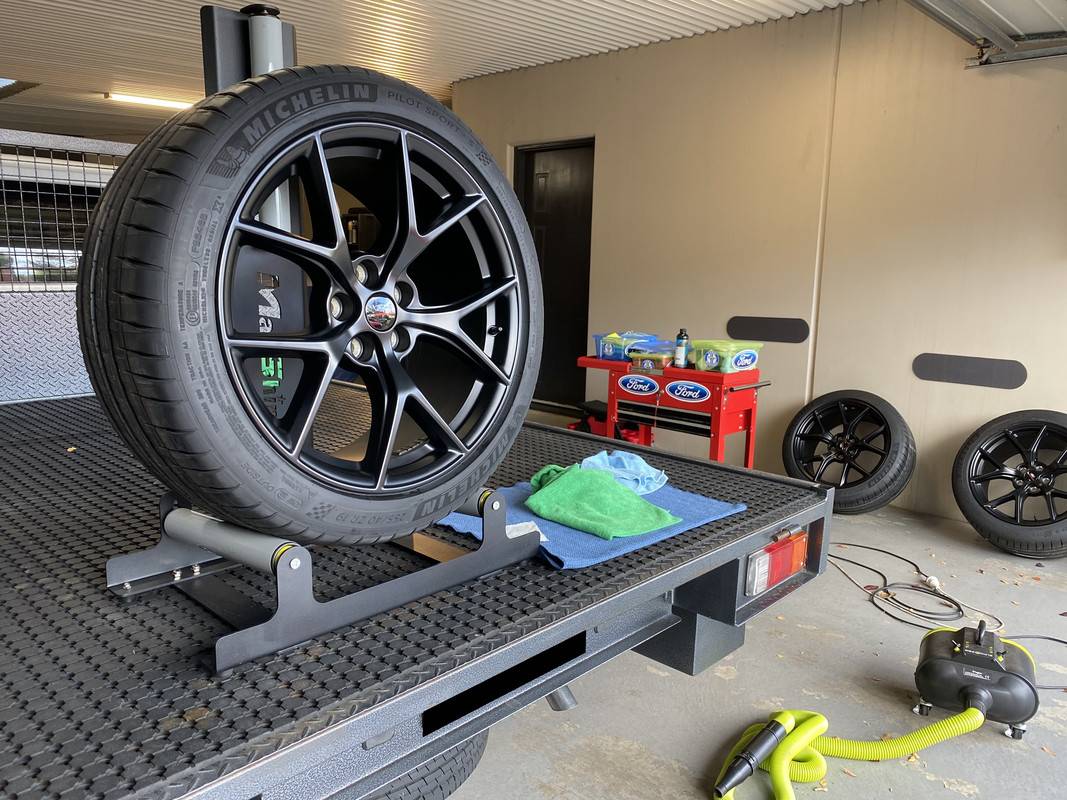

Now for wheel prep. As mentioned earlier, I had the ability to skip a few steps here and go straight to an IPA wipe down. For used wheels, this is where you would be using a wheel cleaner to thoroughly wash the rim, followed by a iron remover and finally a clay bar process. Some wheels may also need to be polished to restore their clarity, my wheels have a matte finish so obviously not suitable here.

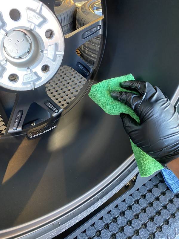

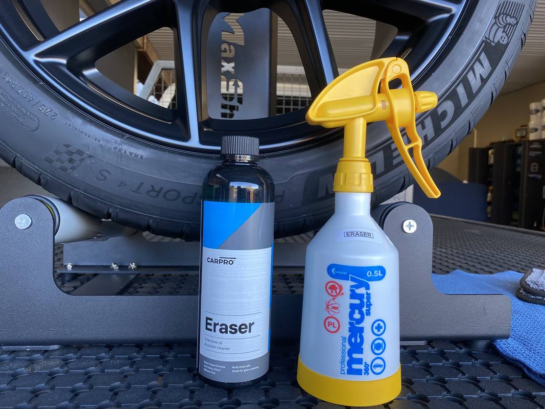

For the IPA wipe-down, my product of choice here was the delightful smelling CarPro Eraser. Liberally spray this over the wheel face and barrel before wiping with a towel until it has evaporated away. Then follow up with another application, this time sprayed into a second towel and wiping over the wheel again.

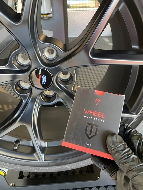

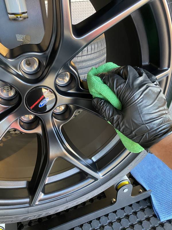

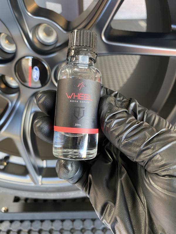

Now the wheels are clean and free of oils that may interfere with the ceramic coating bond process. Time for the coating. In my case, I used NV Wheel, however there are a variety of other similar wheel coatings available such as CarPro DLUX and GTECHNIQ C5.

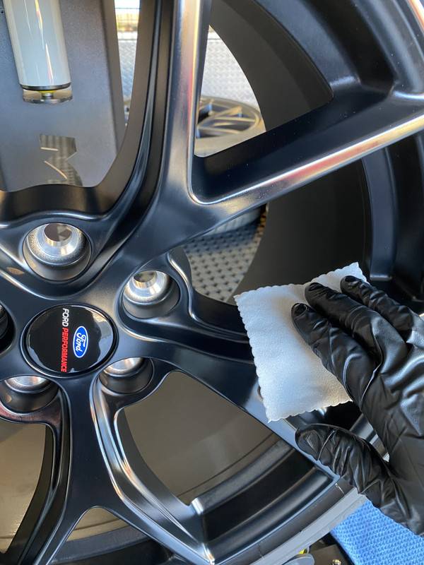

Firstly, absolutely make sure to wear Nitrile gloves for this job and apply in a well ventilated space. Open the bottle and apply a generous line of the product to an applicator to prime it. Once primed, a few drops are all that is needed. Working somewhat quickly while showing care to get a even coverage, wipe the applicator over the wheel face and spokes. Allow the product to flash, then start wiping with a low pile microfibre towel. Once leveled, take a second towel, and give a final wipe to ensure you have removed all of the high spots. Flip the wheel and repeat on the barrel and the back of the spokes. And again, repeat the process for the 3 other wheels. Flash times will vary depending on climatic conditions and from product to product. Follow the manufacturers directions and you will be fine. I used the supplied suede applicators but there are a variety of products for this job, although I have found linting issues on microfiber applicators.

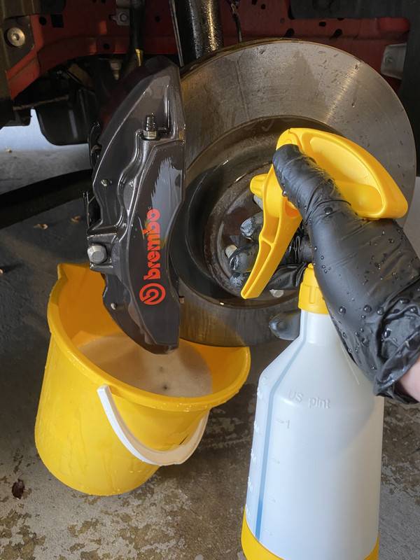

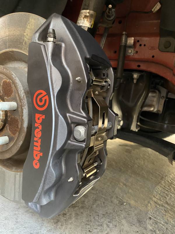

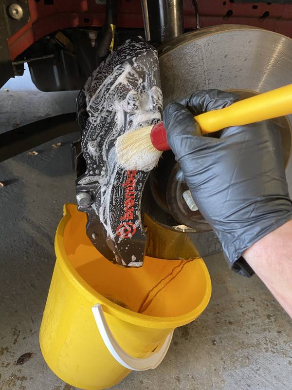

During this process, I took the opportunity to clean and then coat the front calipers while I had the wheels off. The rear calipers are nothing to look at so I skipped doing these.

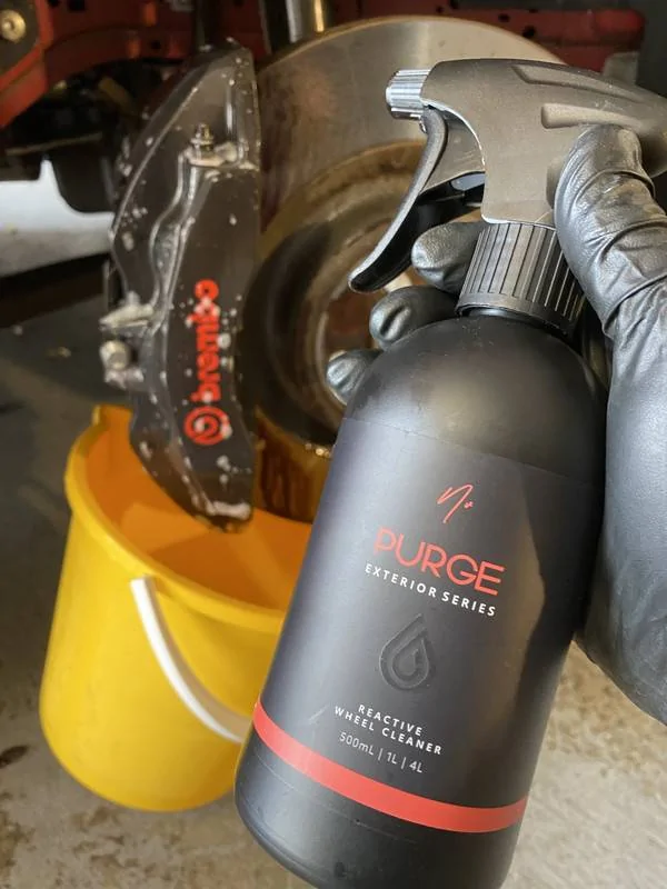

With a bucket suspended under the caliper, I rinsed with water then applied an iron remover. Allowed to dwell for a few minutes, I agitated with a brush then rinsed again with water.

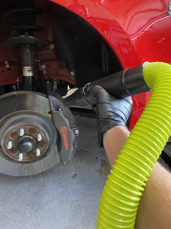

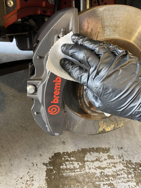

Then a wipe down with Eraser and dried using my blower.
Apply the coating using the same method as the wheels, apply with an applicator, level after about a minute then wipe again with a second towel.

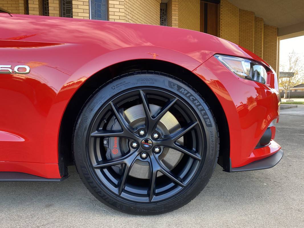

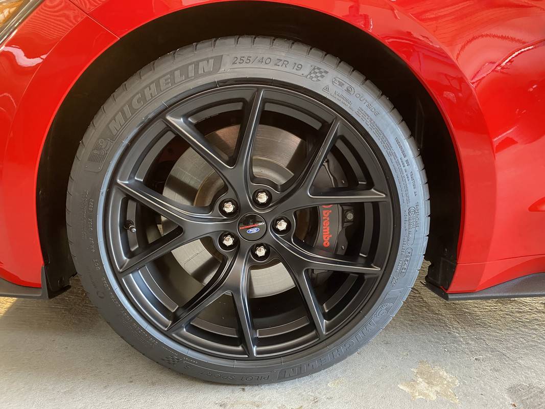

Wheels now on and torqued to spec, time for tire dressing.
Before –
After -
All up, I used nearly one 30ml bottle of NV Wheel, several suede applicators and several low pile microfibre towels. It is worth noting that those towels are either destined for the bin or for shop use only. The dried coating in their fibres has rendered them not suitable for painted surfaces again. At a couple of dollars per towel, I'm not worried about this. Also be mindful to follow the cure times to ensure optimum durability and results.

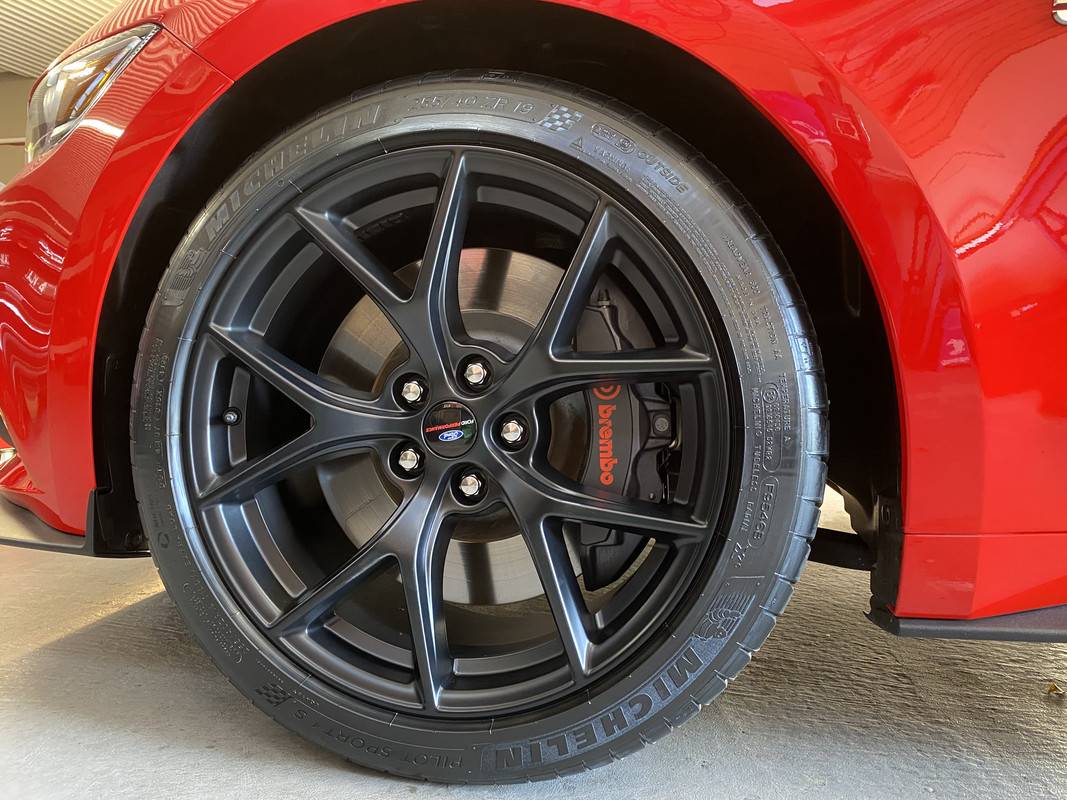

The finished result, the wheels are now protected and will be easier clean in the future.

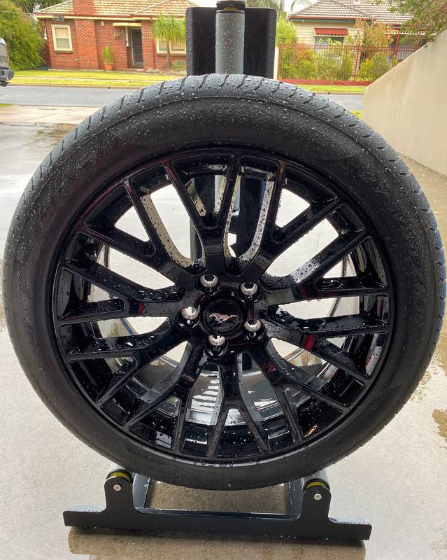

After cleaning up my original wheels, I thought I would add this in here to document the decontamination process that I omitted in my opening post.
This process is best completed with the wheels off the car for a more complete clean and easier working.

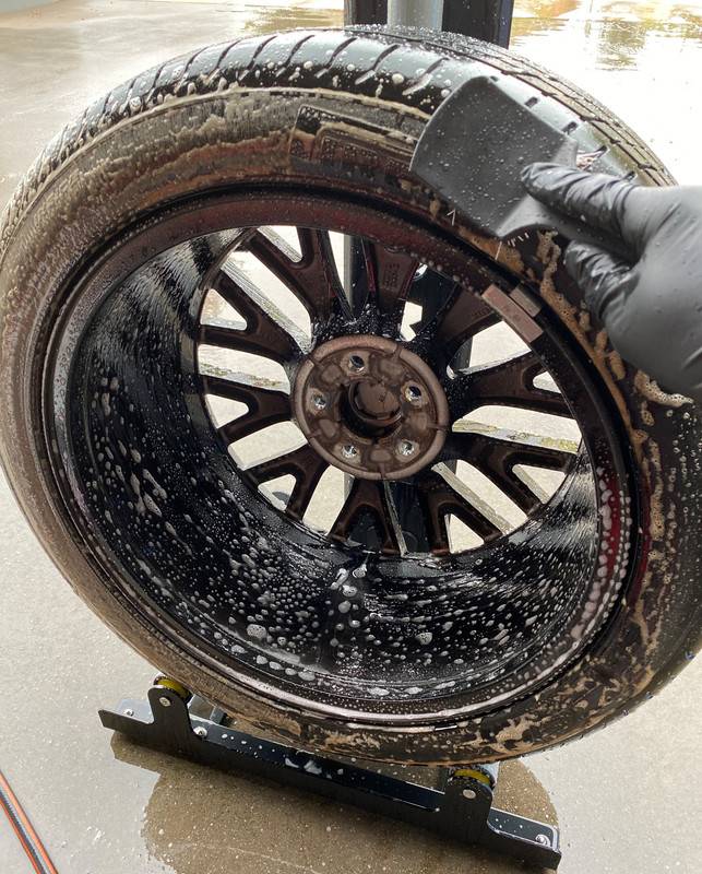

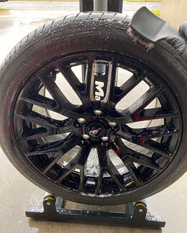

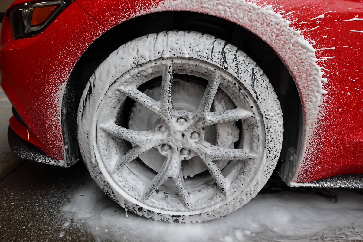

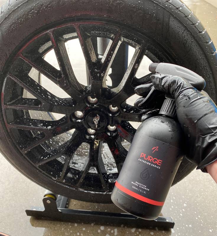

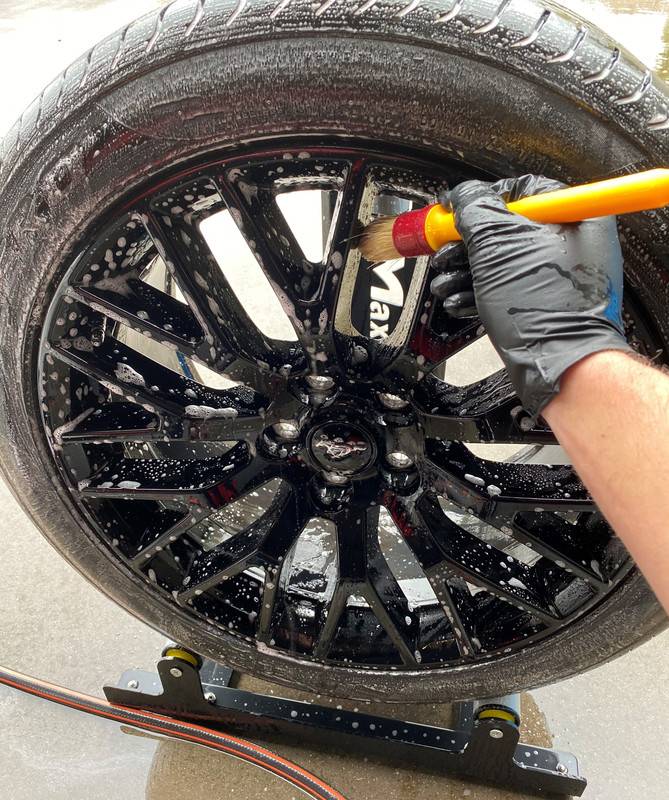

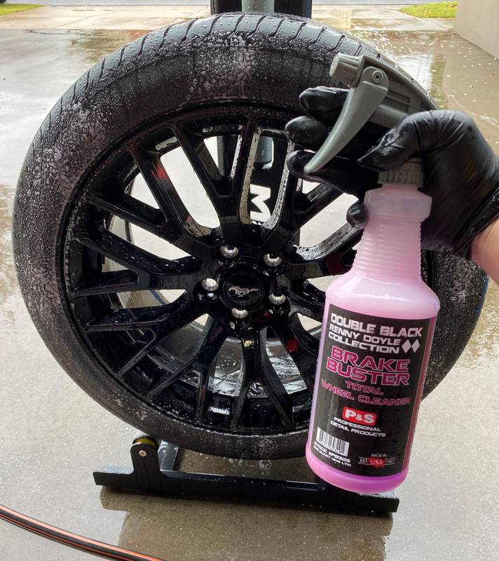

Starting off, clean the wheel as normal. This is one of the rare occasions I use a wheel cleaner on my own cars. These wheels were coated in CarPro Hydr02 and I wanted these things stripped bare. Brake Buster un-diluted has that ability. Starting with the tires followed by the rims. Being regularly maintained, you will note a lack of brown color change on the tires.
I then followed this up with an iron remover. Again, note the lack of color change due to the previous coating and regular cleaning inhibiting iron build up. It's at this point I will note that a product like this will NOT degrade a ceramic based coating, hense the use of the high-alkaline Brake Buster first.

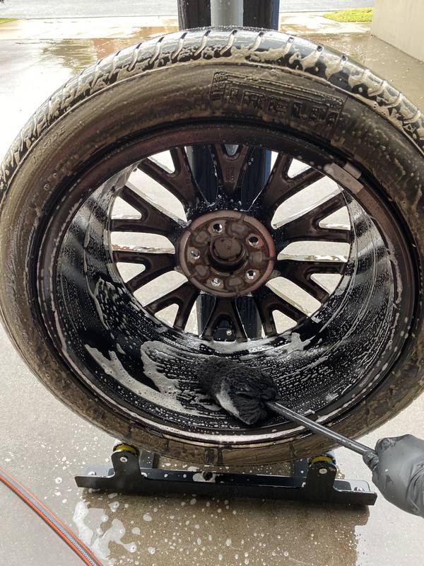

I then flipped the wheel and repeated the process. Note here the strong color change on the un-maintained rear sidewall.
This is the easiest and least time consuming wash of these barrels EVER! :like:

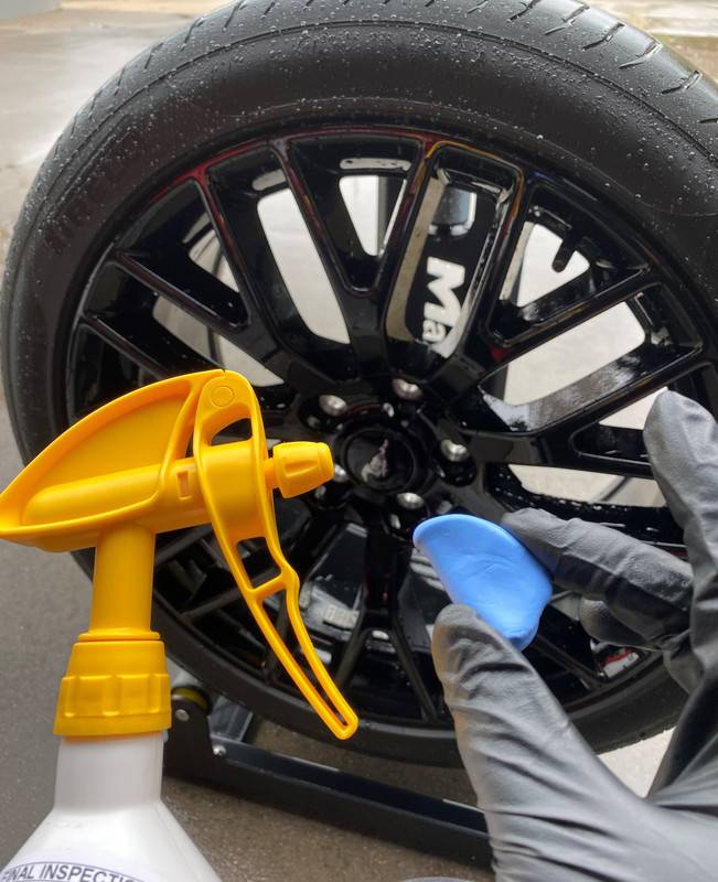

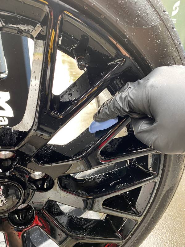

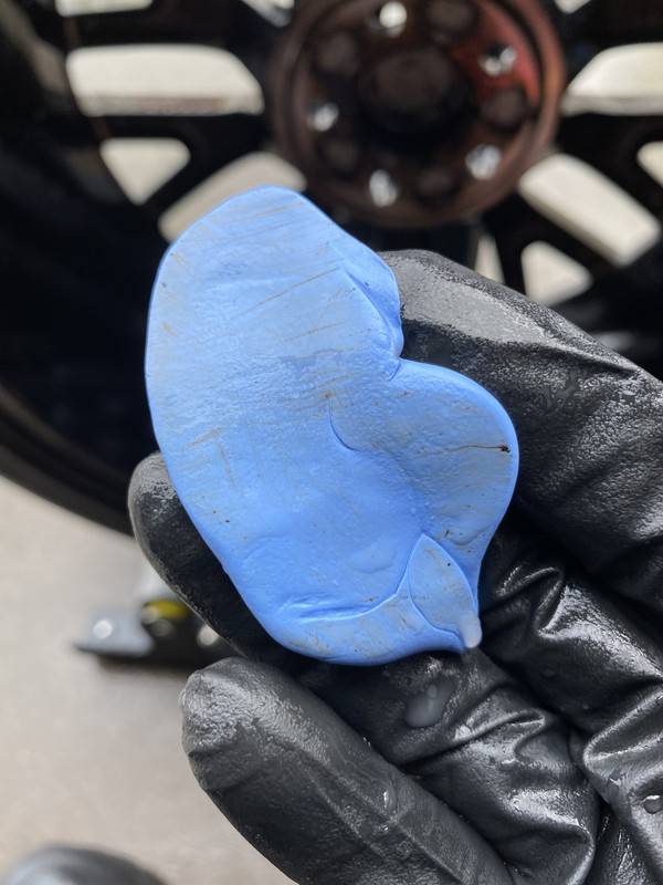

I then used a clay bar and some quick detailer on both the wheel face and barrel. The face and spokes were rather clean, the barrels did have some pick-up.

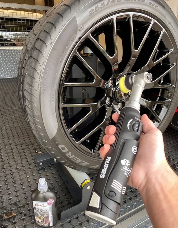

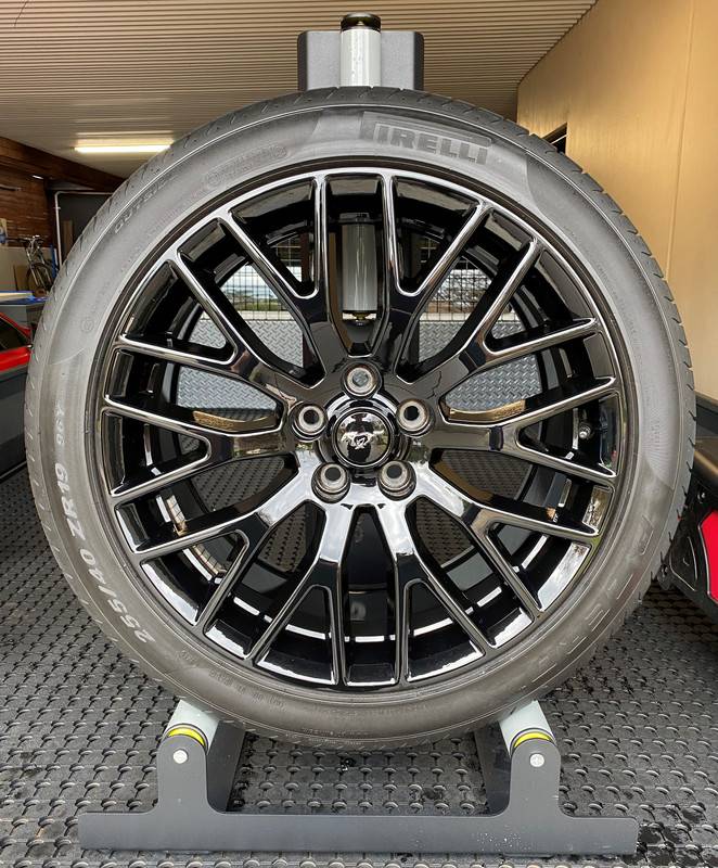

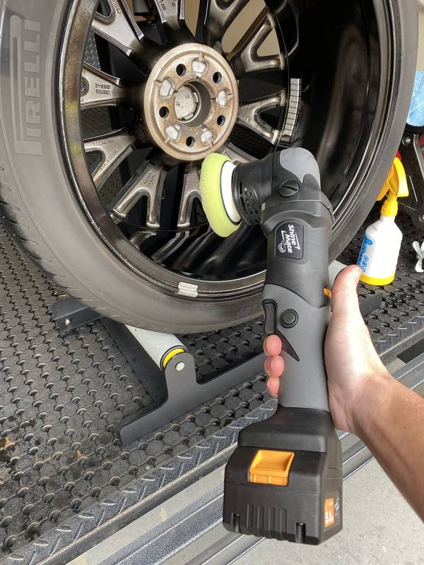

Blown dry, it was time for some polish. I didn't chase perfection here, if they were going back on my car I would have though. The goal was to restore some clarity and shine. With caliper clearance on these cars making brush choice limited, washing these wheels safely has been a challenge. With a gloss black finish, there was always going to be some wash induced marring.
The barrel was easy enough, using my 3 inch machine. The wheel face and spokes were a bit more challenging. Using my iBrid Nano in rotary mode, I managed to get a decent amount of coverage despite the space limitations. If you are on the fence regarding one of these polishers, just get one, they are AWESOME!
At this point, you would then proceed to the tire prep and IPA wipe down process. For these wheels, I gave them a quick wipe with Eraser then coated them in Bead Maker for some extra gloss and some protection.
And thus concludes my long and painful love-hate affair with S550 Mustang PP1 wheels. 🎉🎉🎉

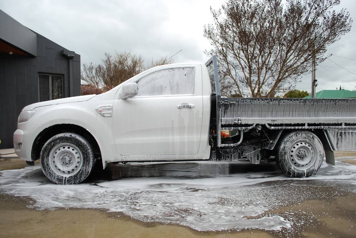

My truck/ute? Well, it made the ideal work platform this job. It's day job however is carrying tools and equipment.
I basically live in this thing, it helps pay for the passion. It is supposed to be my daily / beater but it gets it's fair share of detailing action too, probably too much! :giggle:
Powered by rousing 158 hp diesel engine. :crackup:

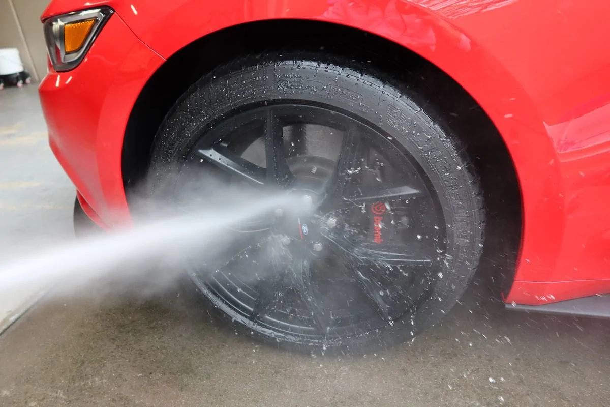

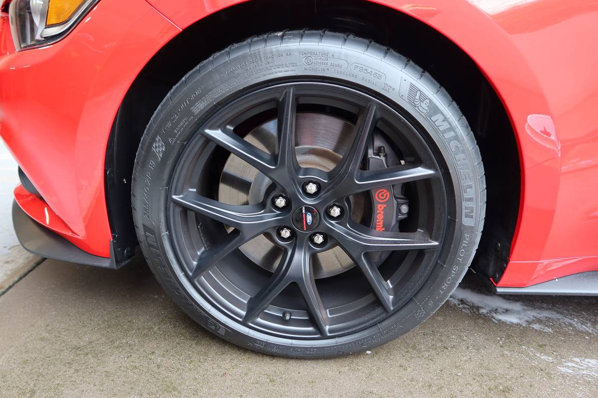

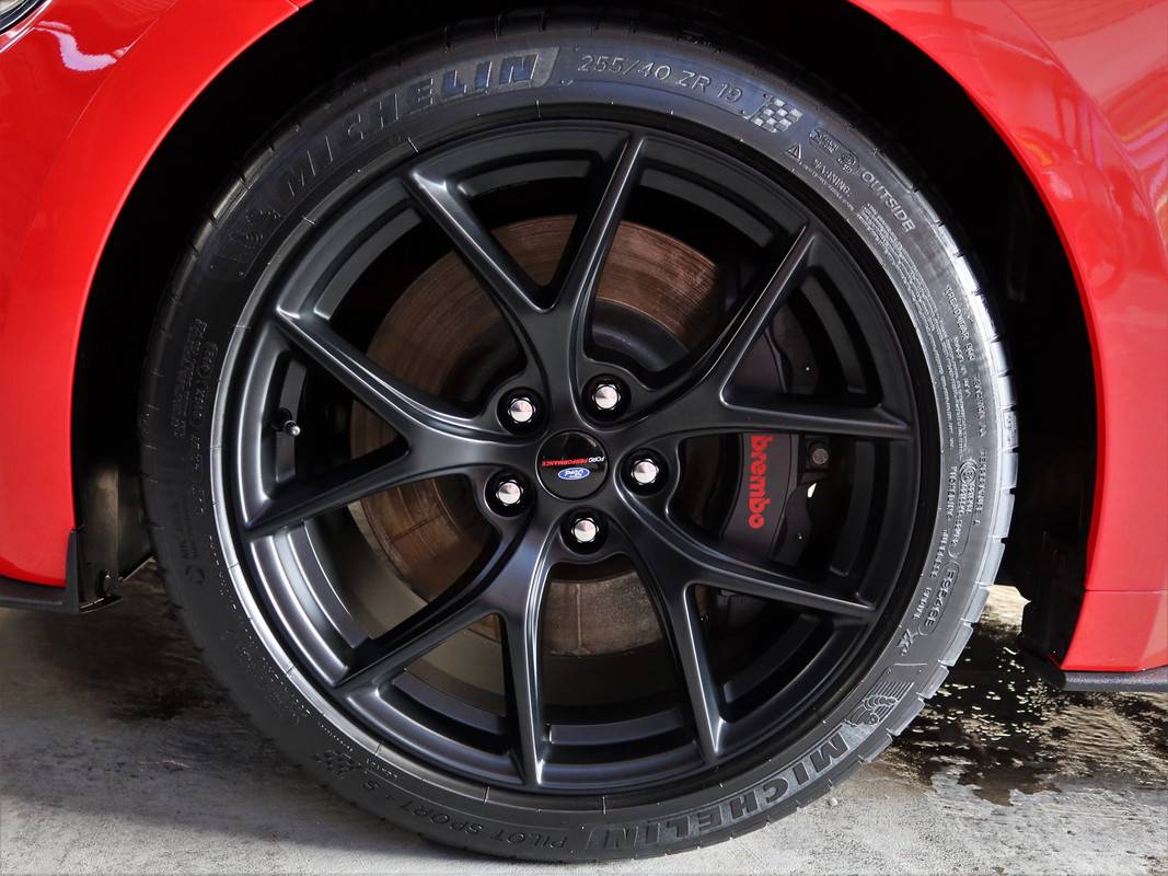

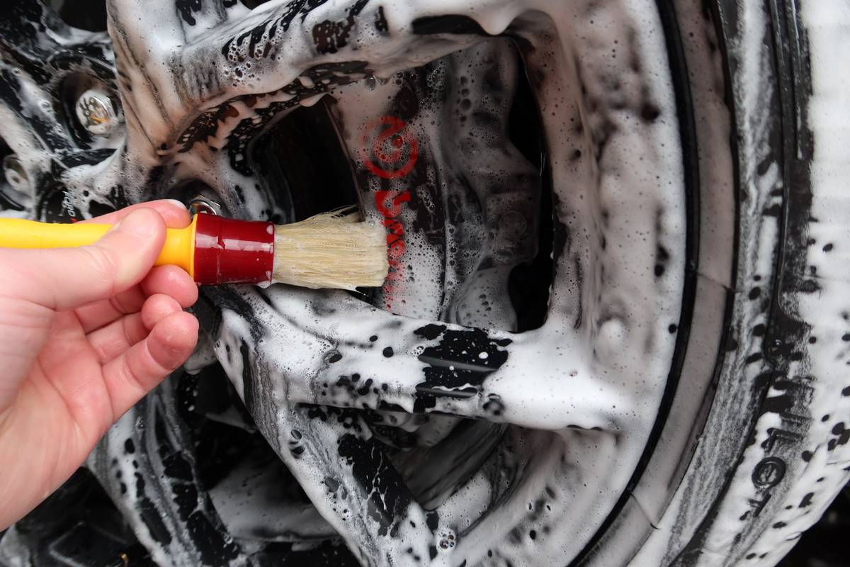

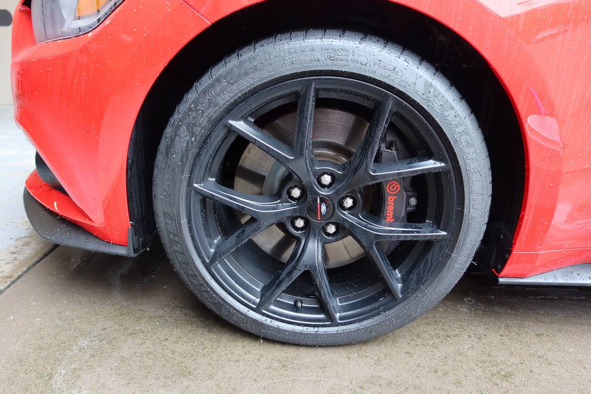

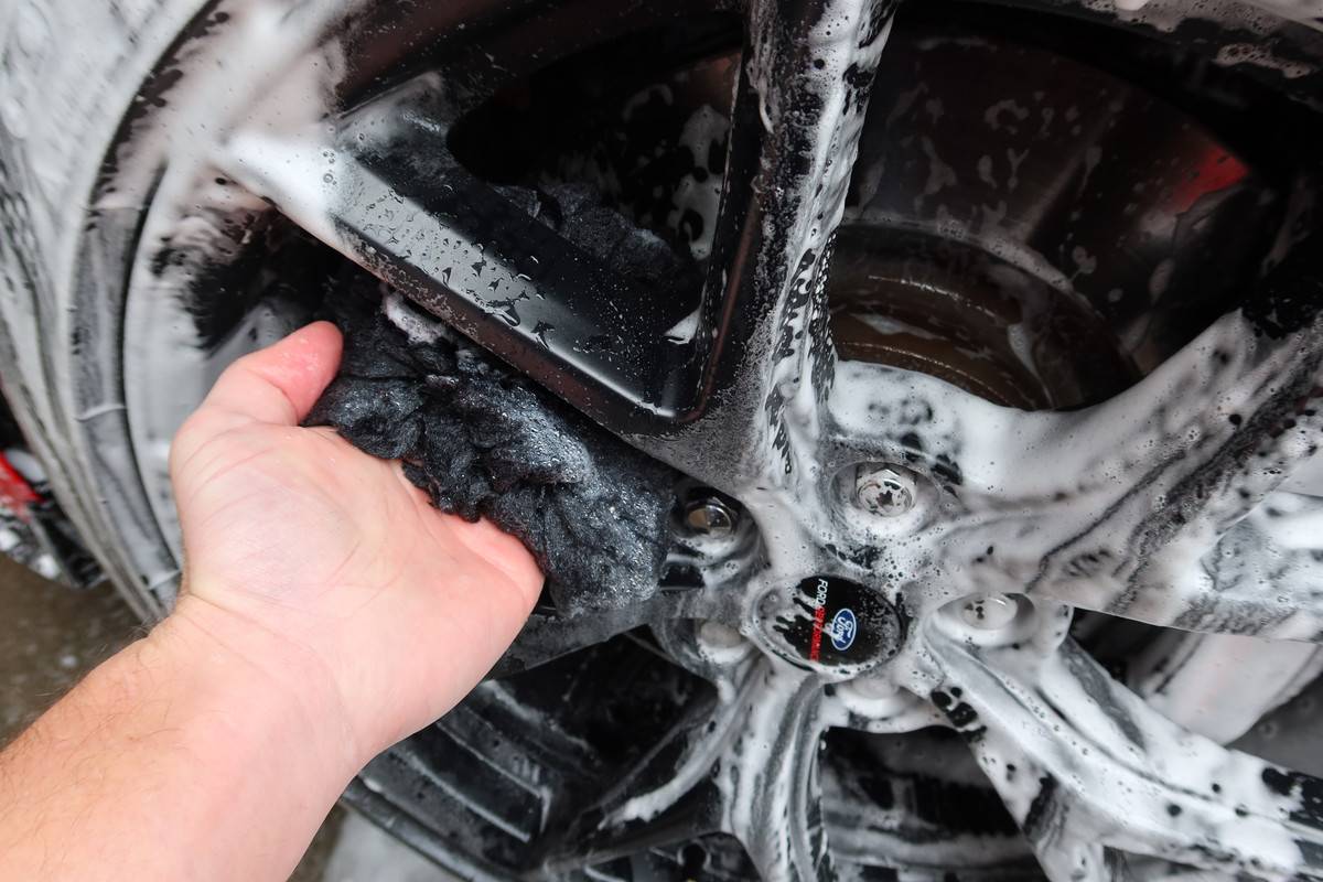

Continuing along with the theme of this thread, today was the first wash of these wheels.
That said, there was not much to wash. The ceramic coating has really stopped brake dust from adhering to the wheels. I think I could have just rinsed them off and been done with it.

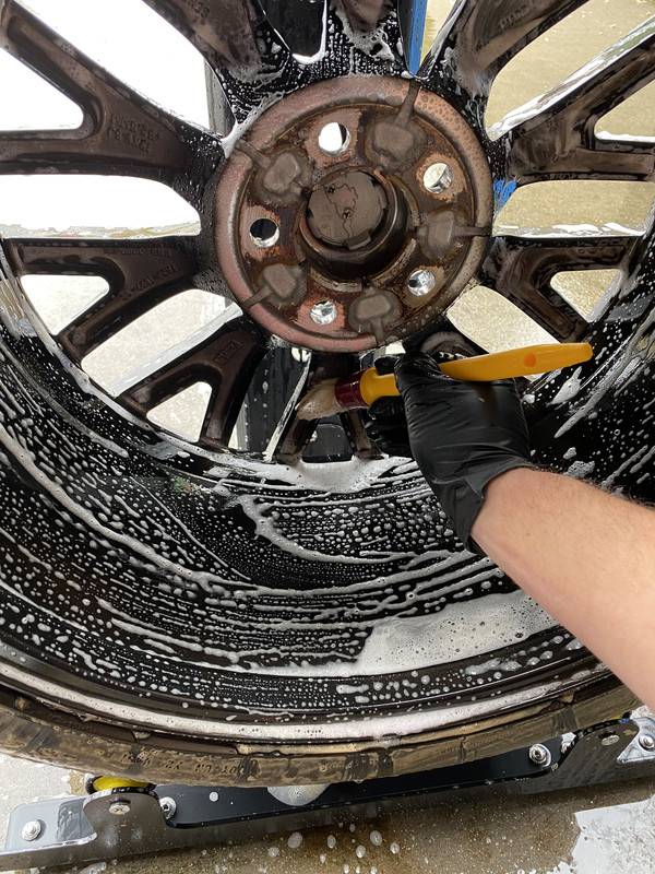

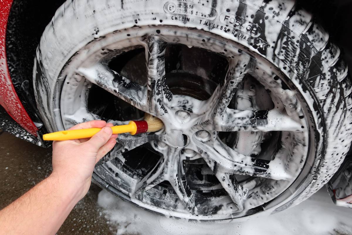

Foamed with soap, although wheel cleaner can be used if needed.
I can't begin to tell you how much joy there was cleaning these wheels with such ease today, just so easy to get everything with brushes and wash mitt. I do still need a bristled brush to get behind the caliper though.

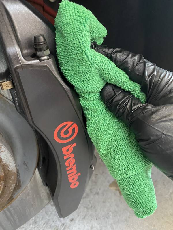

And I can now get the calipers properly clean.
With the coating on the wheels, they are dried with ease using the blower. I still followed up with some quick detailer though. Again, the luxury of clearance aided by the reduction in spokes.
And after the finishing touch of tire dressing.
