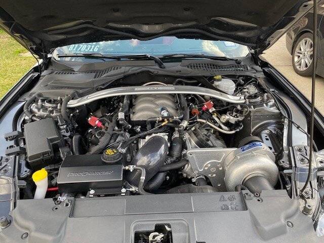

Random question, if i go with either a procharger or whipple, will I need a different oil air separator?
TRP45ACP
May 25, 2020
157
94
Houston, TX
2018 GT Premium Coupe, PP1, MT82, 401A
That depends on how you want to run your car. I simply vent mine to the atmosphere through little filters. At some point, the filters will get a bit dirty or oil soaked, I will then change them out.
