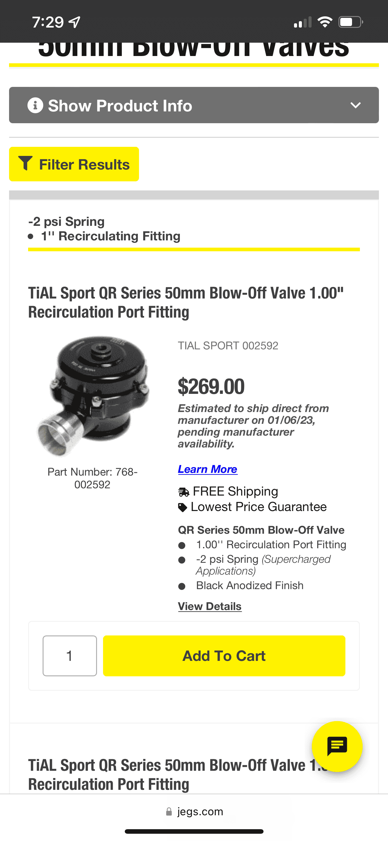

Actually this could be your best bet. Haven’t done any testing with this but it’s recirculating and should be much quieter. It uses the same v-band connection and would be bolt on with our intercooler. Would just need to route a recirculation hose back to the intake.

Thats exactly what I was looking for. Thanks Brevin!
