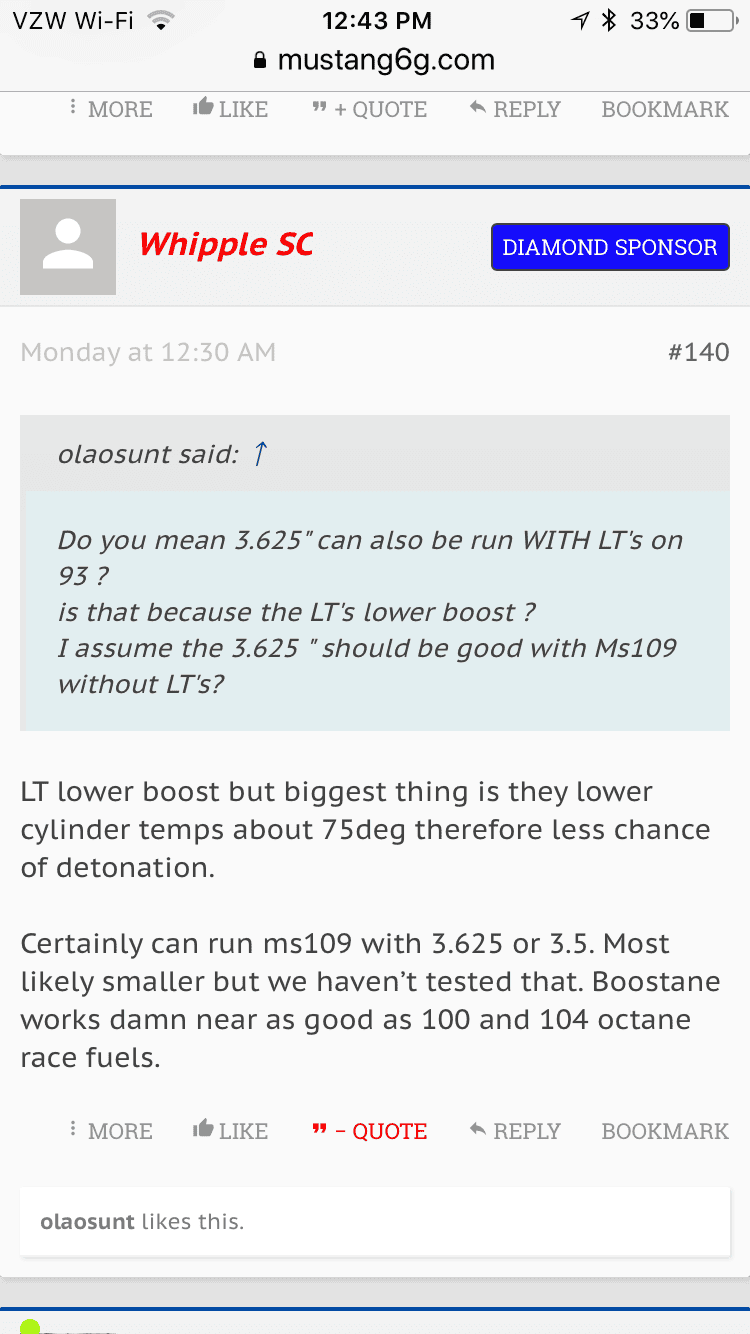

Sorry I wasn’t able to attach the quote from another thread so I took this snap shot of what Whipple SC (AKA Dustin Whipple) said about the benefits of of long tubes and removing cats. They both have an effect of reducing cyl heat.

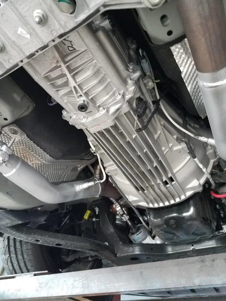

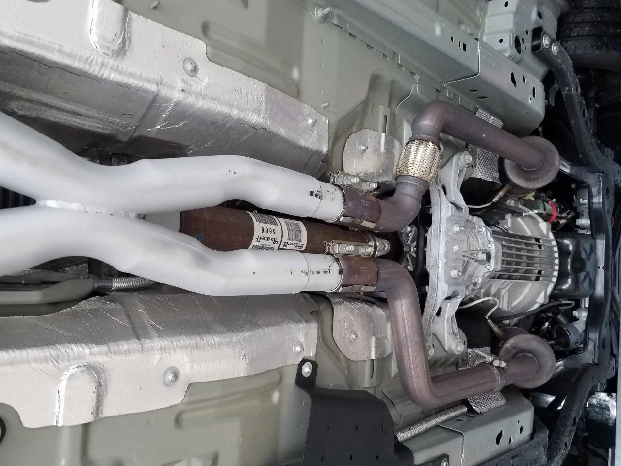

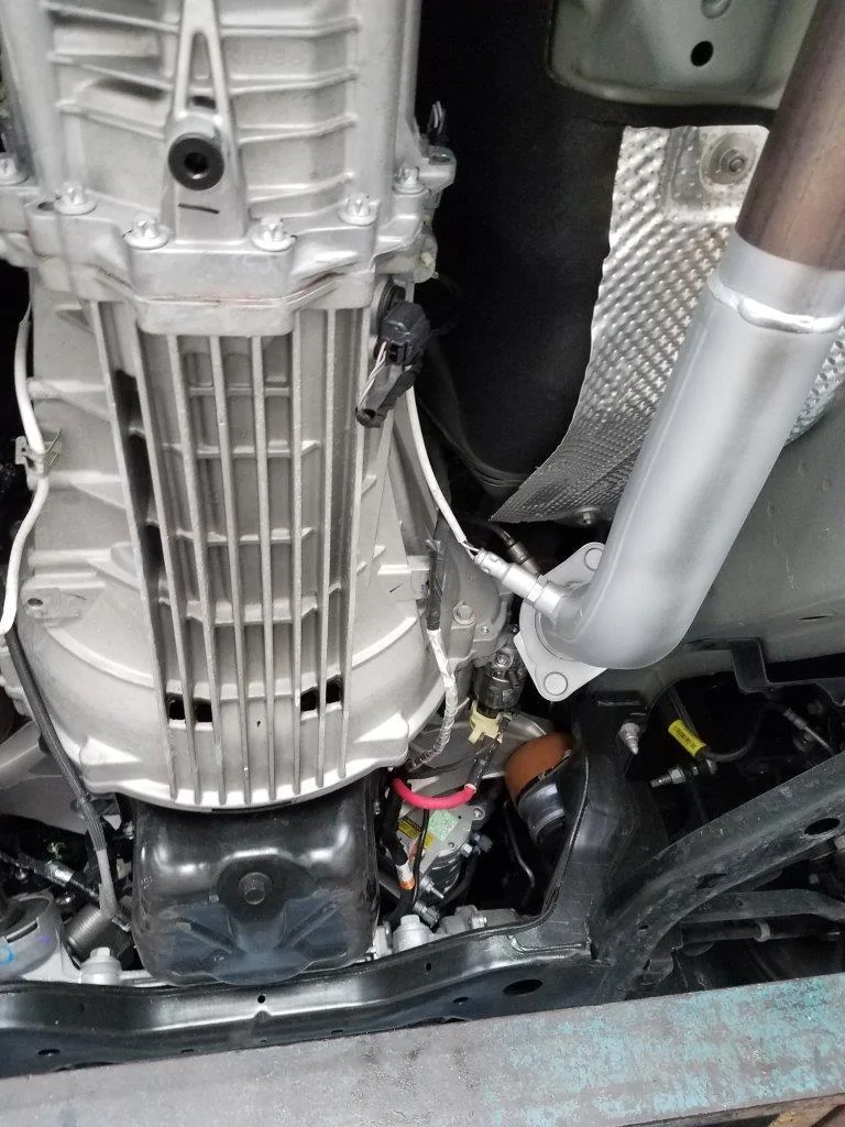

Just got the cat's removed, very happy with it so far.
At Idle, the sound is great, not much louder than before with the cats, just deeper. I feel like I can still keep it quiet (ish) rolling through a neighborhood.
Edit: I'll try and get a sound clip up tomorrow on cold start.
But upon WOT, Sick. Clean and Mean.

Fortunately I didn't have to actually do this work myself, I have a good friend in the muffler business that's a pro at custom fabricating. He did the x-pipe as well! :)
