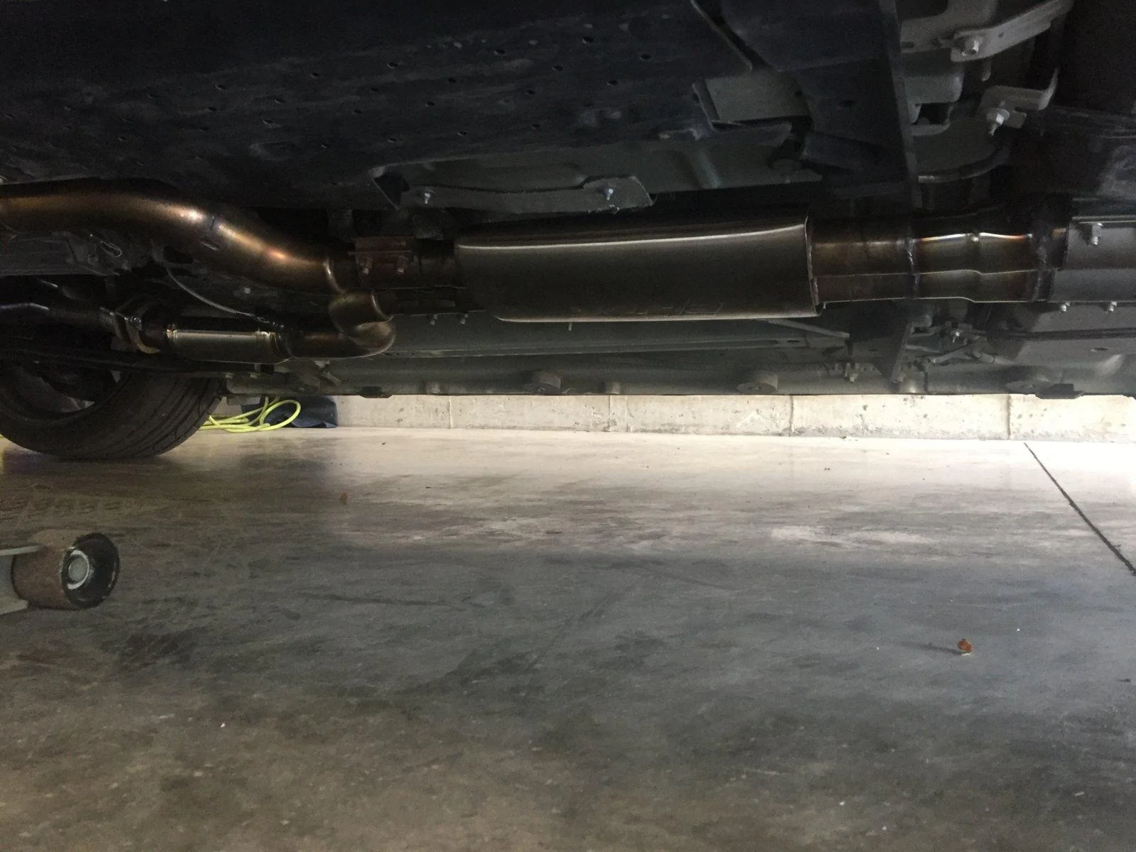

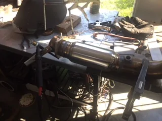

Details on resonator and location? I've got Stainless Power catless longtubes into a Corsa Sport catback and I'd love to tone it down some...
The Borla 60561 resonator was amazing a cutting down the volume, and that was replacing MBRP 3” 16” Long resonator tunes. I welded everything up and had to do a little fab work to get the Borla to meet the MBRP 3” exhaust pipes. Also you can see the 12” resonator welded in place of the green cats. My green cat after 3 years of us was failing.
