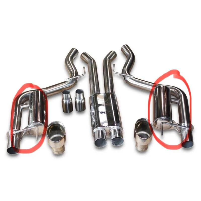

The helmholtz will be in place of the midpipe right? So the the mufflers/resonators should be between the midpipe and axle back are?
The Helmholtz resonance chambers are circled in red and located in the rear of the car near the OEM muffler location.
You’re using factory 4-2-1 headers w/o cats shouldn’t be to bad with the Thremal R&D as is out of the box.
