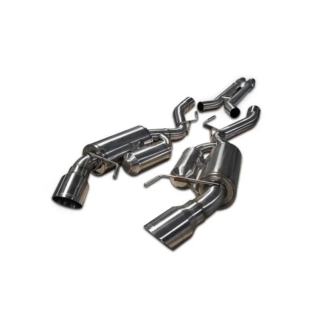

This is an Ark Grip Mustang exhaust with rear Helmholtz chambers. Those cancel out drone. AWE and CORSA mufflers have an internal Helmholtz whereas Ark, Thermal and even some MBRP use an external Helmholtz.
Catless is going to be a challenge to get the sound you desire. You’ll be way ahead if you start with the jones mid resonator/muffler. There are other mid options but the Supercharged guys have this jones mid combo dialed in both sound suppression and longevity.
Rear mufflers are a crapshoot. AWE’s sound good to me as does CORSA.
