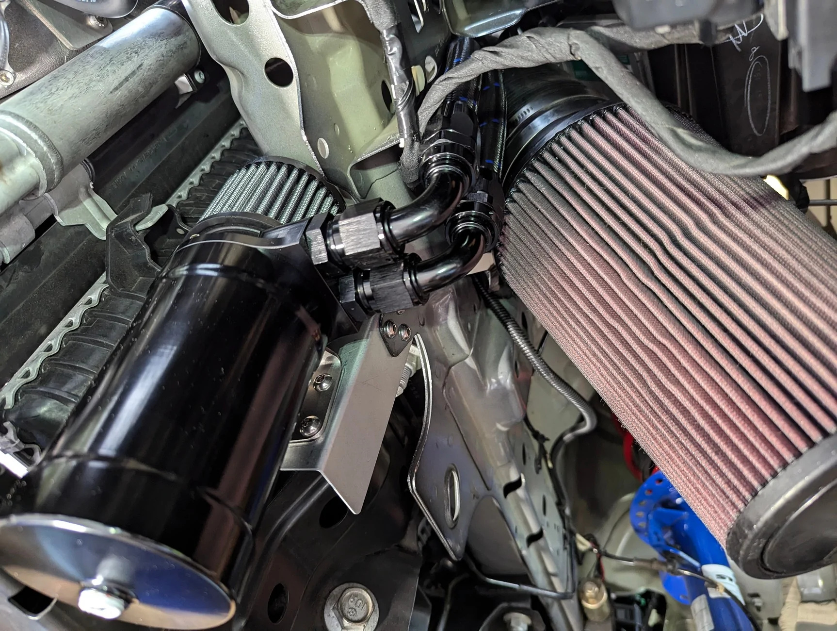

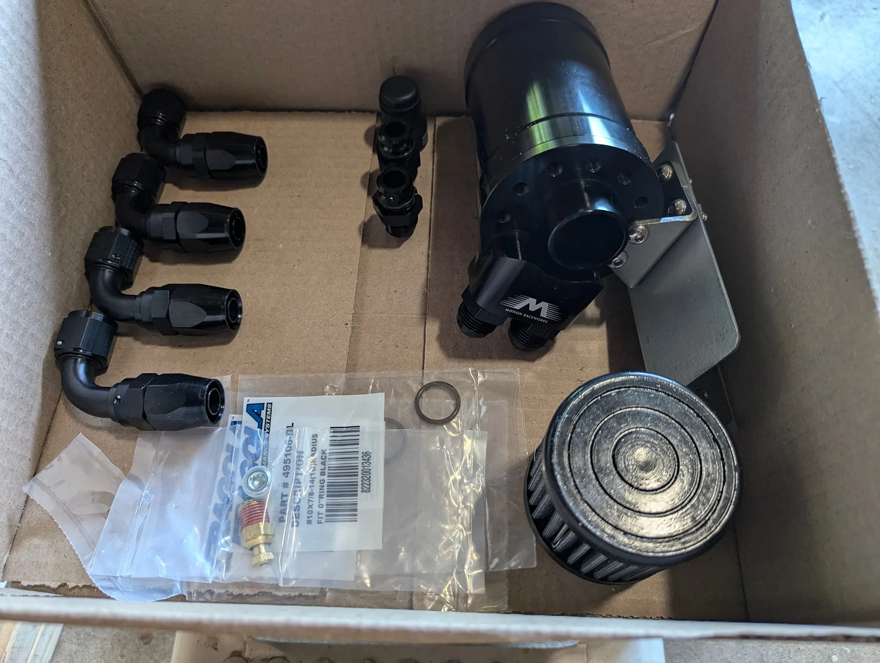

I like to reduce clutter under the hood. I installed my Motion Raceworks catch can down low next to the SC inlet. E85 puts out a lot of moisture that requires frequent draining. I drain it through a hole in the splash shield. Also keeping any crankcase fumes as far away from the HVAC inlet as possible.

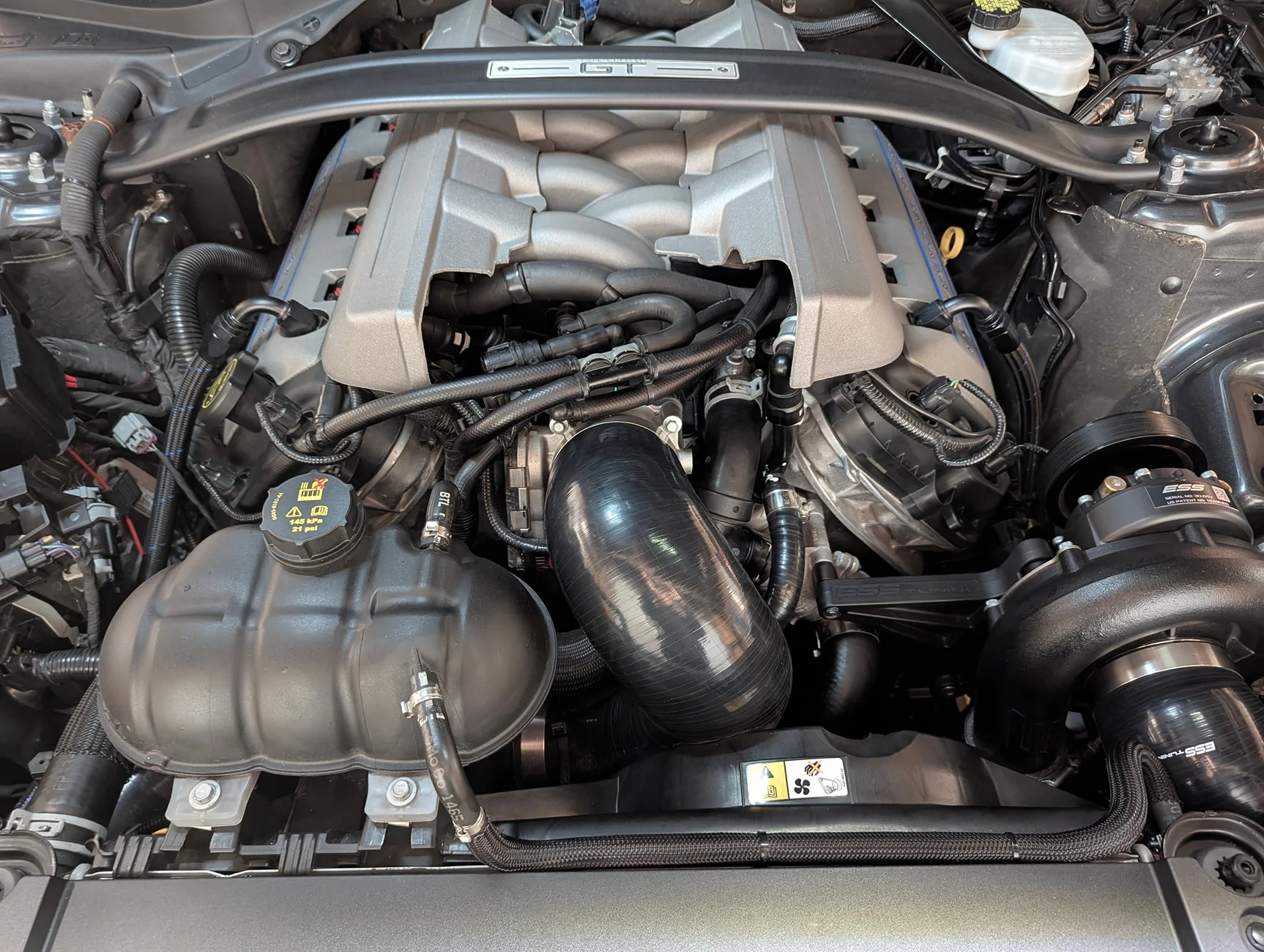

I ran JLTs when the car was NA. When I switched to a Centrifugal SC I put on a UPR Vented. It is my opinion the UPR is the better design and quality product for the money spent. I quite appreciate the UPR Vented. It is always a kick to watch people point at the hood vents when the car is warming up from a cold start and see the condensation and gases being vented out through the race louver vents I have.

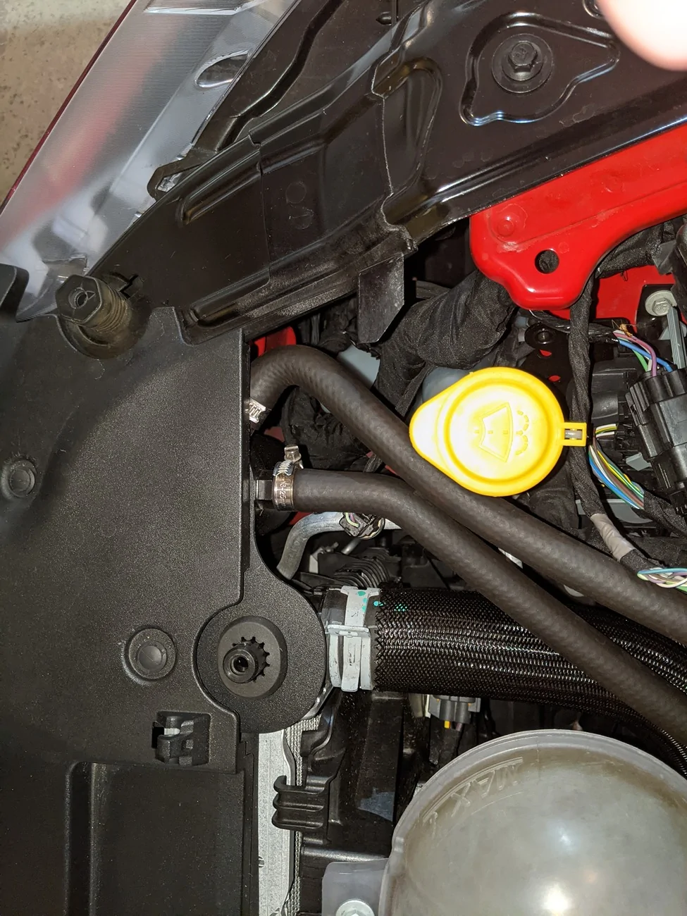

So I am looking to buy a passenger side catch can. Im not sure if all are equal in terms of what they filter and such. Ive looked at the upright, j&l, and mishimoto. I kind of prefer where the mishimoto mounts and am curious if its a little easier to access than the others?
From a quick scan, I don't see that your second question was ever directly addressed. I have the Mishimoto separator on a Stock '19 GT. I like how the can mounts out of the way (see attached photo). Since it's under the radiator support cover, you do have top remove the 11 push pins to easily access it for drainage. With the proper tool -- or even just a straight screwdriver -- it only takes a couple of minutes off and on. It is a very nicely made piece. I cannot compare how effective it is, since it is the first and only oil separator I have ever owned.
