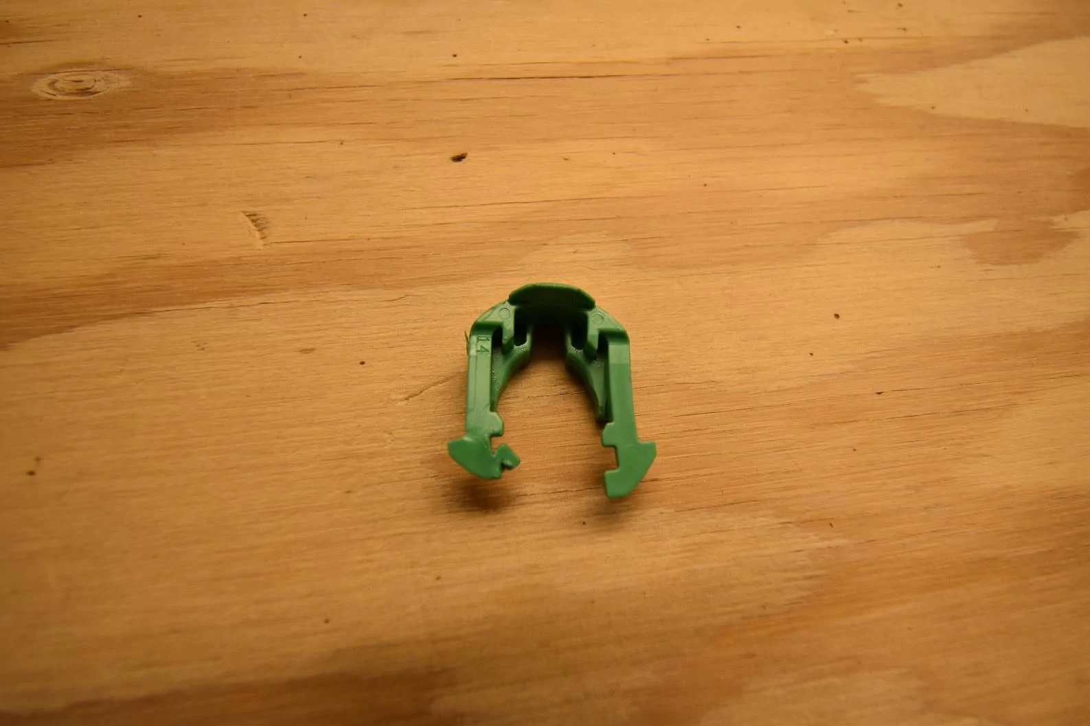

Newly installed JLT 3.0 catch can PCV side hose blew off today. Does this clip look normal?

NO! The retaining clip is bent or twisted. Both sides should be equal. Stop by Ford or NAPA and pick up one or two.
