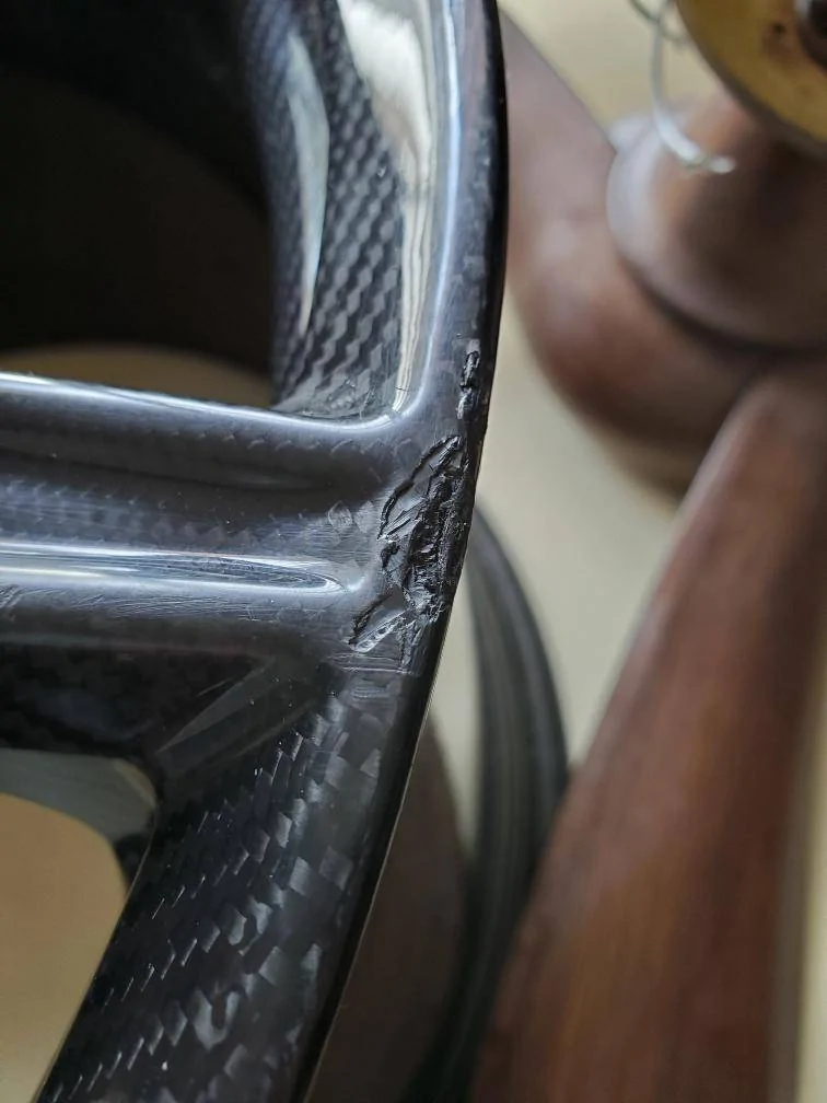

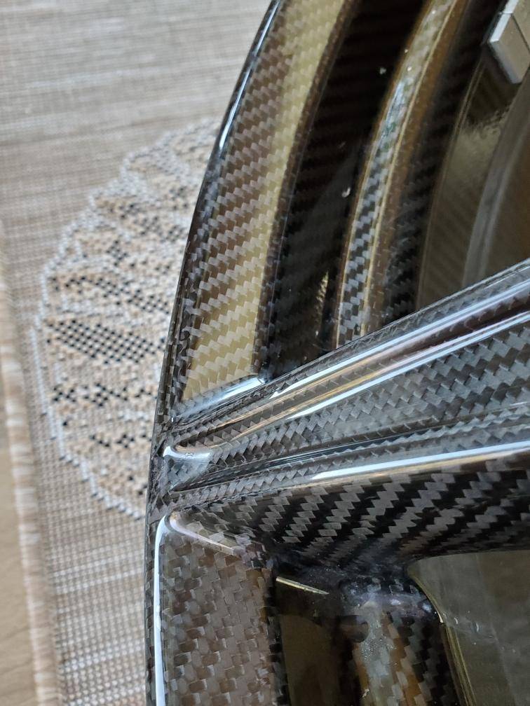

I have reconsidered my position on this matter. Recently, I have been able to buy damaged CF wheels from various sources. 4 GT500 wheels (3 fronts and 1 rear), 3 GT350R wheels (1 front and 2 rears) for very reasonable amounts of money.
1 of those wheels was brand new in the box. 4 of them required minor repairs that I accomplished. 2 of them went off to spyder composites for repair. One of the GT350 wheels was badly damaged from a curb, similar to damage recently in another thread. That was an easy repair and turn around time was quite fast. One of the wheels is still at the shop because spyder is backed up and I told him to take his time and make it like OEM new.
For the ones I repaired, they varied from minimal curb rash to severe curb rash (which is what you would reasonably expect to occur from street use). Once I obtain the last of the 4 wheel set for the CFTP, I will post a "how to" repair guide on taking care of the extremes of reasonable damage that can occur.
I used to be one of those people who was afraid to damage my CF wheels on the street. After repairing several of the more complex carbon weave wheels myself, I have realized that this whole paranoia of damaging the wheels on the street is just that. Furthermore, Bemaro films makes a PPF for the spokes of the GT500 wheel. I installed them and found the process to be easy.
I recently ran a Daytona Speedway track session with the repaired wheels and the PPF installed. I was concerned about the heat that would be generated and how the PPF would react. There was no issue and the PPF held on with no problems.
Attached is a sample before/after of one of the wheels I repaired. This wheel was probably the least damaged out of the lot. As you can see, it really isn't an issue to repair common damage to the exposed CF wheels. GT350 wheels are even easier, repair and paint. Done.
The signature wheels are now off the CFTP and I am enjoying guilt free CF wheels on the street without any worry.

Bearing in mind some of the shit flying around on other threads please don’t think I’m being an arse …
Do you have a photo from the same angle as the one that shows the damage ?
I’m genuinely interested - not that I can afford carbon rims for my car, but I fixed some broken carbon on my (push) bike and I currently have a damaged wheel that I’m wondering if I should have a go at fixing.
I kind of like bringing things back to life / giving them a second chance etc :like:
I’m also looking forward to reading your repair procedures :like:
WD :like:
those are the photos of that wheel as I took them at the time. I didn't take them for the purpose of this thread, so no, I don't have any more. I could take more photos of the finished product, but that will all be part of the "how to" when and if I get the last rear wheel.
As for the other threads, This post was written as result of those. I don't agree with scare tactics of "this is what will happen to your CF wheels" garbage.
The wheels can be fixed and the majority of the damage can be repaired by yourself.

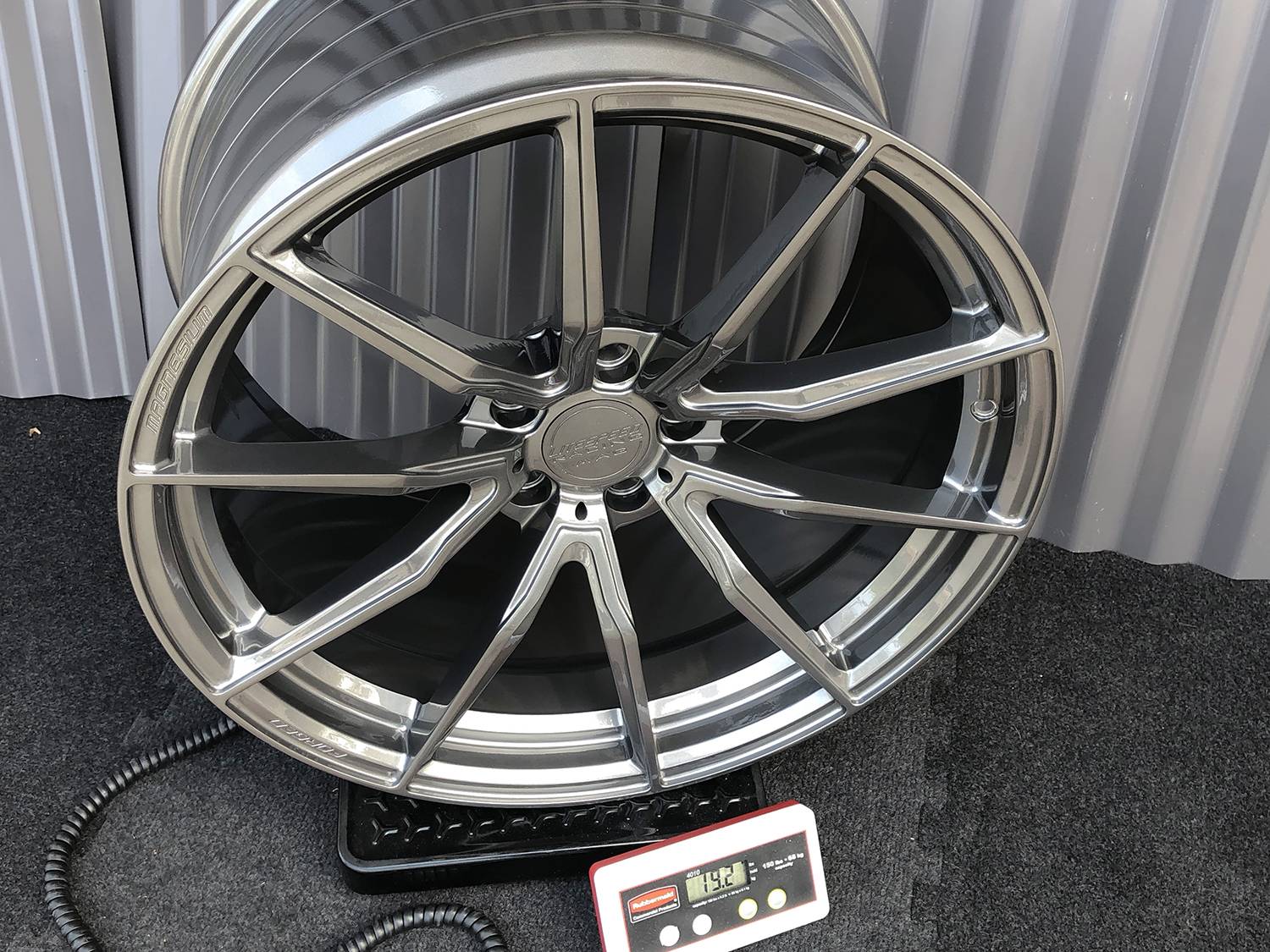

Here is my solution to Carbon Fiber Wheel issues. 20 x 11 and 20 x 12 Magnesium alloy wheels.
19 Lbs. front 20 lbs. rear with titanium lugs. Lightspeed racing did the wheels. Less than 8k

The question is, who makes them and where did you buy them at?
JNS_PP2
Mar 6, 2019
56
92705
Joe
2018 Mustang GT PP2
They are made here in southern California. They are forged magnesium. See Patrick's web sight link below. Yes I did misspelled the correct name of company in my post sorry.
Mine are gun metal gray to match the cobra badges. I am very pleased with the wheels.
Litespeed racing makes a lot of wheels for exotics. The wheel strength specs and flex numbers are very impressive.
