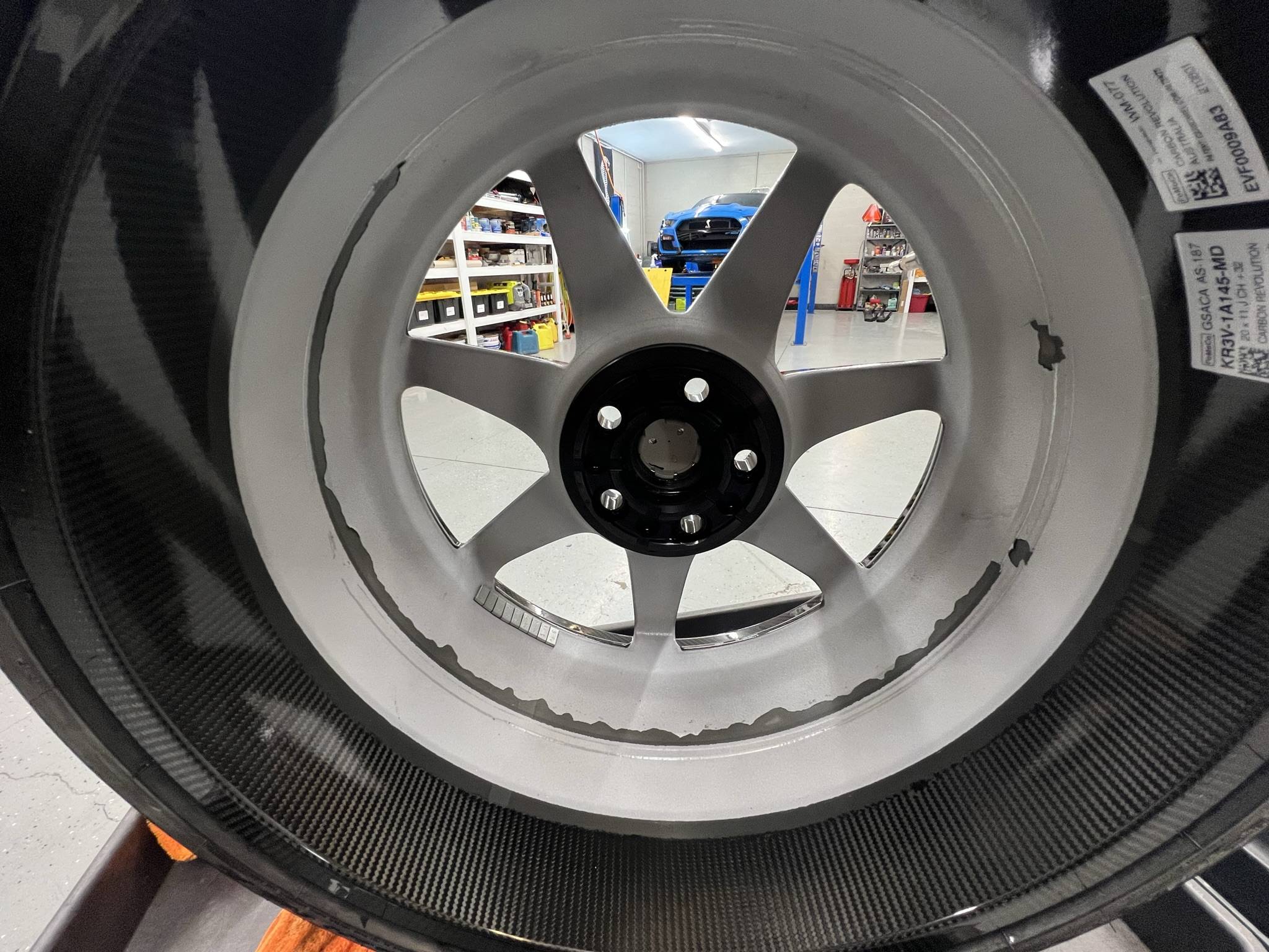

My opinions have changed over time concerning the use of CF wheels on the street. At first, when the wheels were new, there was a fear over damage because nobody really understood how easily CF wheels can be repaired. A major concern was the ceramic lining on the front barrels. There was no perfect fix. Spyder composites had a ceramic material where stone damage could be covered, but it wasn't optimal. There is now in place a process that replaces the barrel lining with the exact same material as used by CR.
I talk to Frank quite a bit. I am constantly buying these wheels and for the most part repairing them on my own. Cf is a very stiff and resilient wheel. The beauty of composites are that most everything (and I would say with the exception of severe damage to a spoke or hub) can be repaired. The same cannot be said for an aluminum wheel.
I have repaired at least 8 exposed CF GT500 wheels (4 of which are on my car and being used for everyday and track duty) and 8 or so CF GT350 wheels. I posted a thread on the process if anyone cares to search for it.
I recall the mass hysteria about damaging CF wheels and people resorting to the use of aluminum street wheels. I remember it was a very heated debate about which was better. I used to be in the crowd that felt aluminum wheels were the way to go.... that is until I realized how easy it is to repair them and how resilient the wheels are to repair.
I look at it this way. The a major performance factor and part of which makes the car so unique is the CF wheels. Why tuck them away in your garage to gather dust. It just doesn't make sense.
I will leave you with an example of how much damage can occur and still be repaired. I chose not to repair this one myself. I sent this one to Frank. He reported it is 100% repairable. Any significant damage to an aluminum wheel leaves it a paperweight.

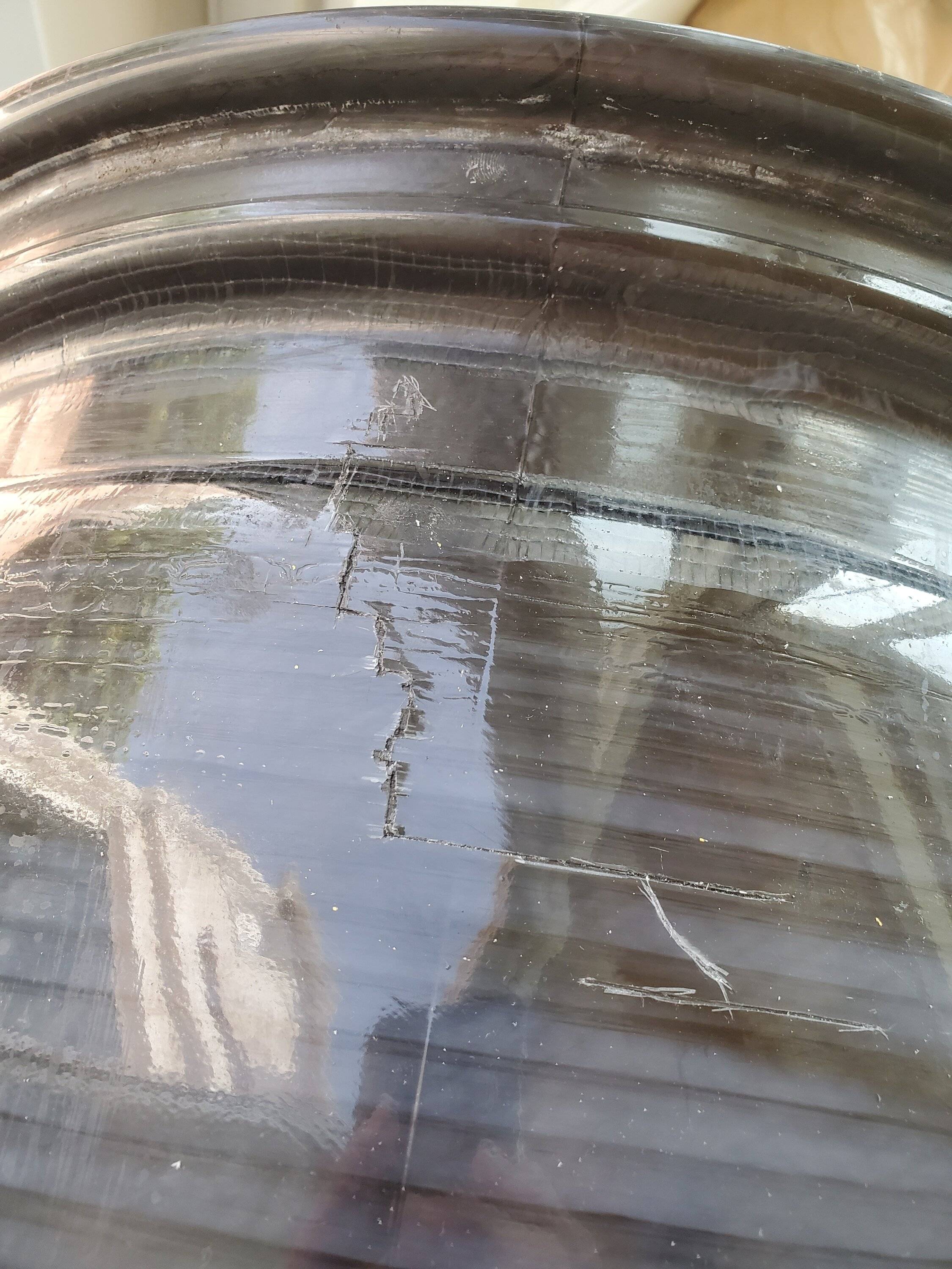

Looks like I’ll be sending mine off to Spyder this winter. 700 miles on the car. Was driving on a clean paved road - no idea where the rock came from. Pulled the wheel and sprayed it with a small electric pressure washer. The ceramic coating easily peels away from the wheel, just like removing the shell from a hard boiled egg.
That looks like a delamination defect. That should be replaced under warranty.

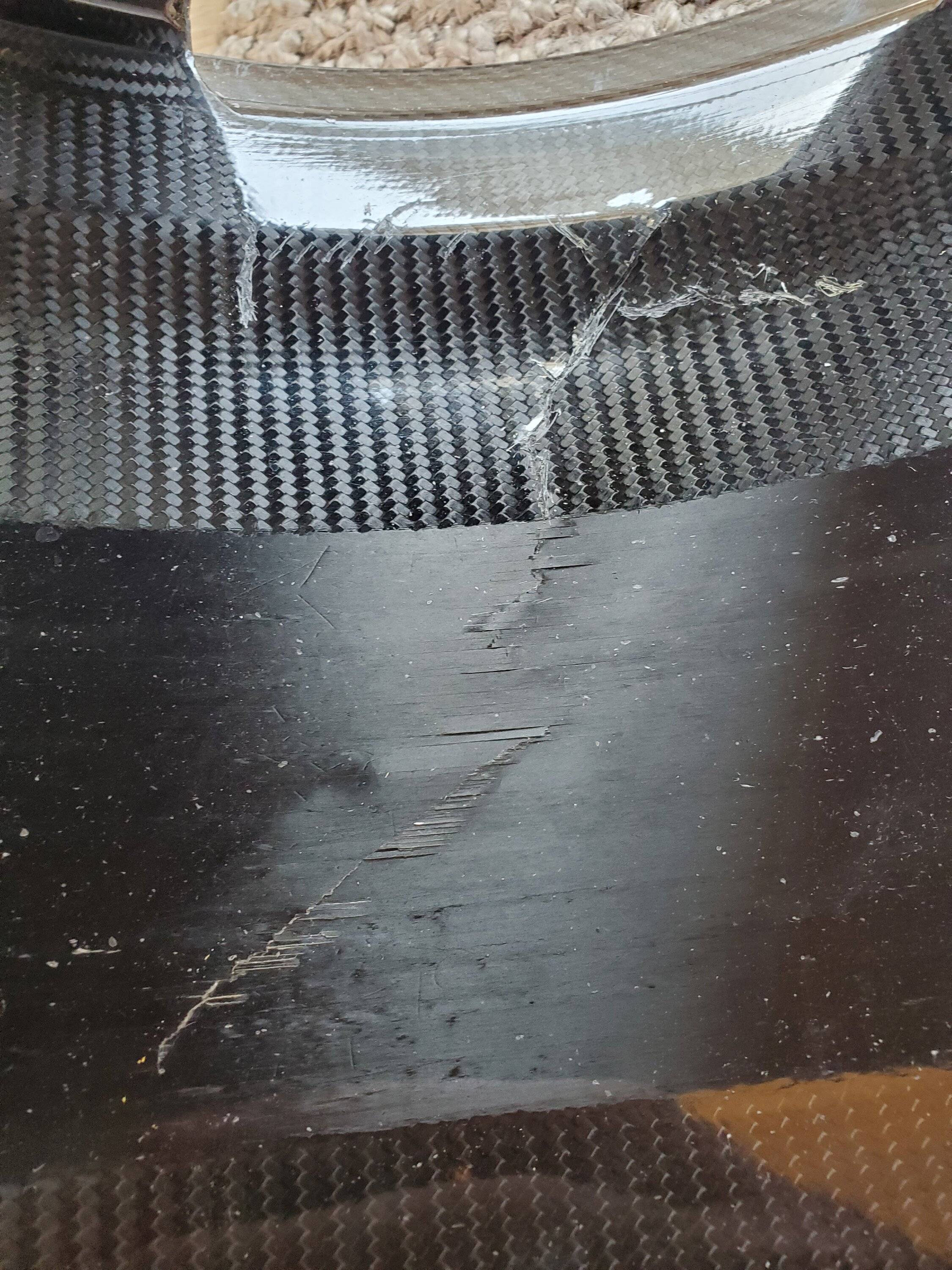

You and me both brother. Had the same issue. Once its opened up, it will peel if you put any pressure wash etc on it as the edges are lifted. I got a rock in front of my house, seriously in front of my house but it only made it a quarter of the way around as I was going 5 mph! I was turning around a large bend and those tires like to grab stones and im sure one grabbed, hit the inside of the wheel and that nice rough coating has enough friction to lock it right into place under the caliper :) I also had some delamination of the white coating on a prior wheel that did get accepted under warranty, I tried one with similar to yours and got denied. Just as an FYI
So by leaving that untreated, the CF could be exposed to heat from the brakes and cause damage to the CF core?
