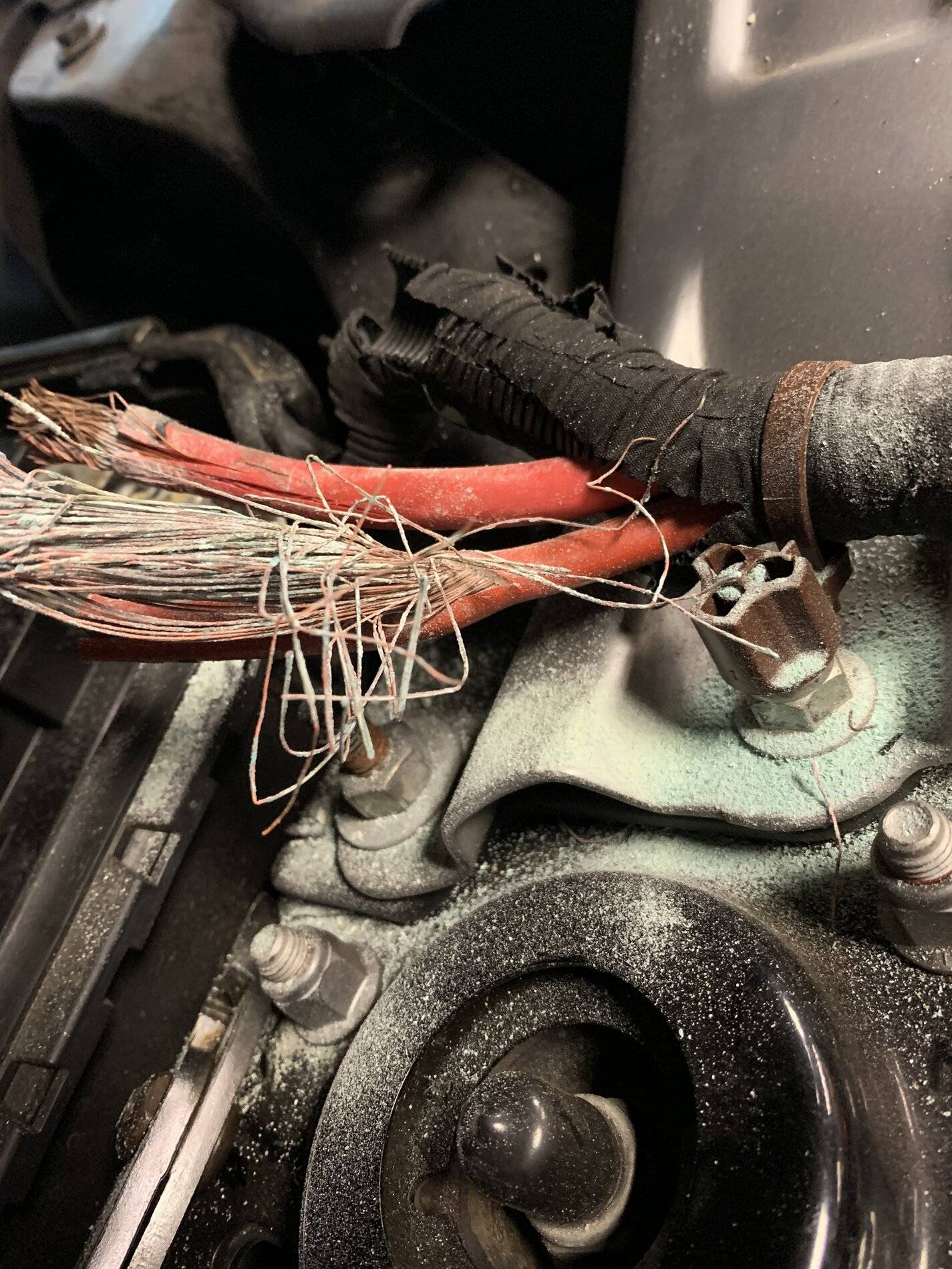

I know this is an old post but maybe it will still help someone searching for some answers. I own a 2016 Ford Mustang gt 5.0 Manual transmission(one previous owner). My car would not start for days after a cold front came in. Replaced clutch engage switch, battery, starter. Bolts were lose on starter (not the problem for me) but worth fixing. No codes and accessories would all come on fine. It would say I had ( - - to empty ) and I have a full tank, when the accessories would come on. Just clicking when I’d try to start.... I have a really honest electrical mechanic i bring my car to. I almost brought it to dealer due to frustration. (To expensive in my opinion and to busy to really get a good diagnosis) I’m sure there are good dealership shops out there (just not near me) :) Anyway, he found the problem after troubleshooting through the battery , starter, clutch engage switch replacement. A Main positive wire Going to the fuse box was Terribly corroded. I live in Florida so lots of humidity. Owner previous tried to fix with electrical tape and crimping wire to break up the corrosion I assume . Made it worse in the long run. Here are pics after removing electrical tape the previous owner but on it. Definitely the cause for starter shorting. Hope this helps

did he find it just like the picture shows? If so, I would that one should have been glaringly obvious to anyone opening the hood?
That is a bad situation
Lmao! I lift my hood up and say “Well, everything looks good here.” While shutting it. Lol!!! No he peeled back the insulation to show me the corrosion.
