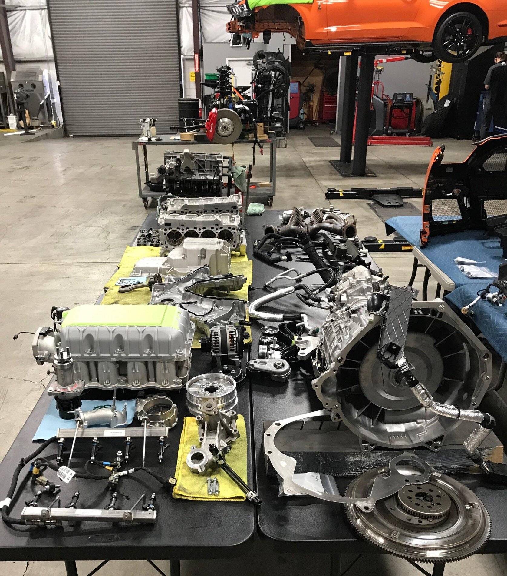

Per dealer right now: "It looks like the engine is seized. We are going to start tearing it down to see what caused it"
Correct. But they won’t get to it for at least another week before they even look at it

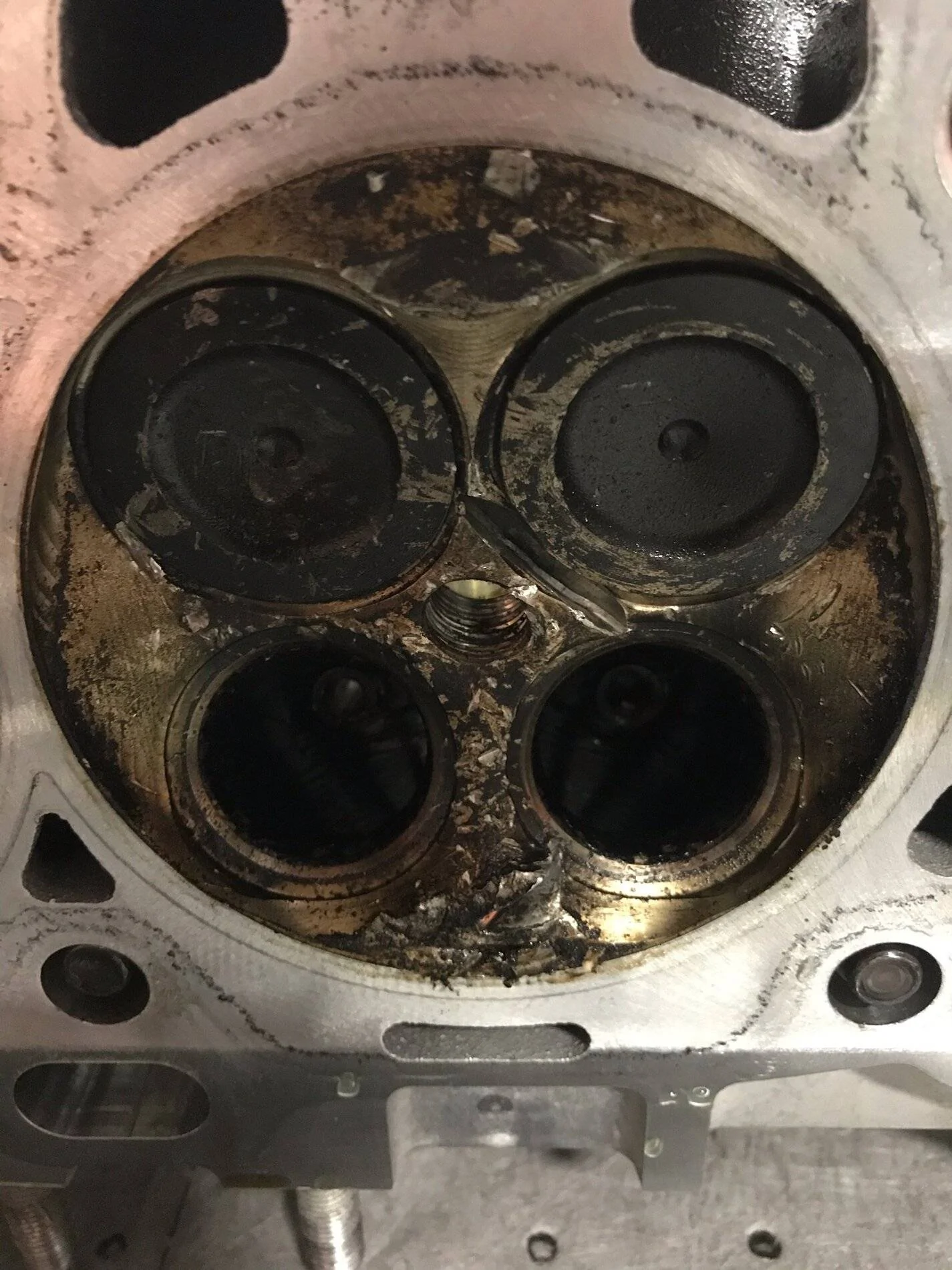

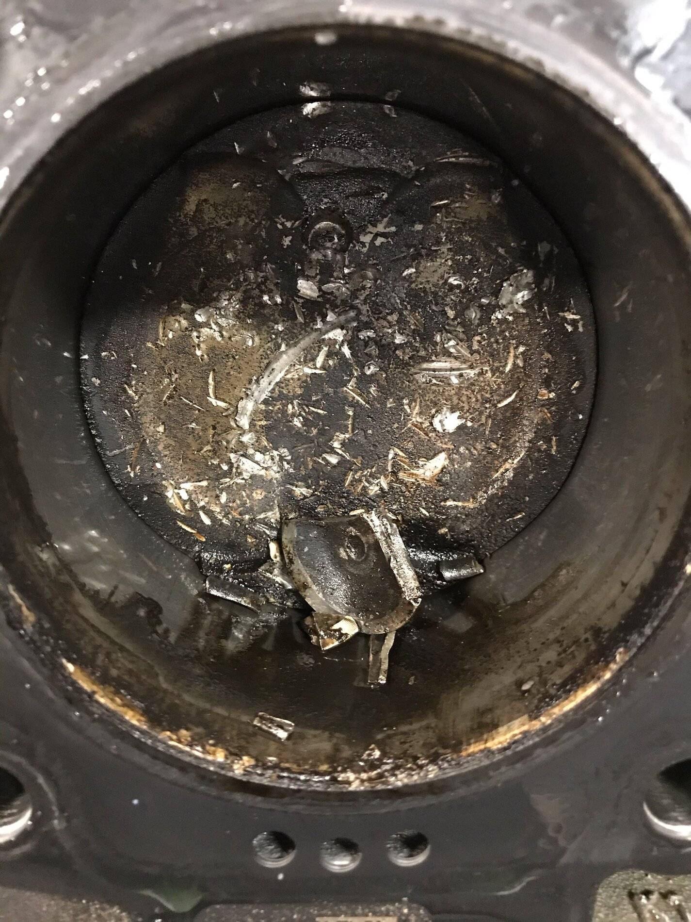

Update
per dealer: "a spring failed, and a valve dropped in cylinder #5. New engine will be here in 5-7 days (including supercharger)"

Doesn't make for a lot of confidence in the valve spring supplier/manufacturer. Two on the forum probably translates into at least a hundred in the larger world.
