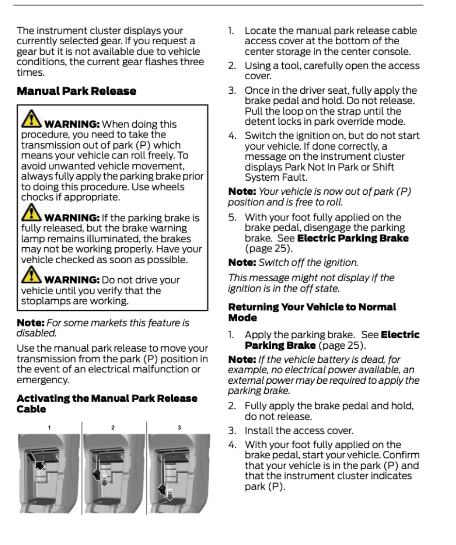

Tow truck is on the way, how do I get it into neutral if I can't start the car?
What car are we talking about.
