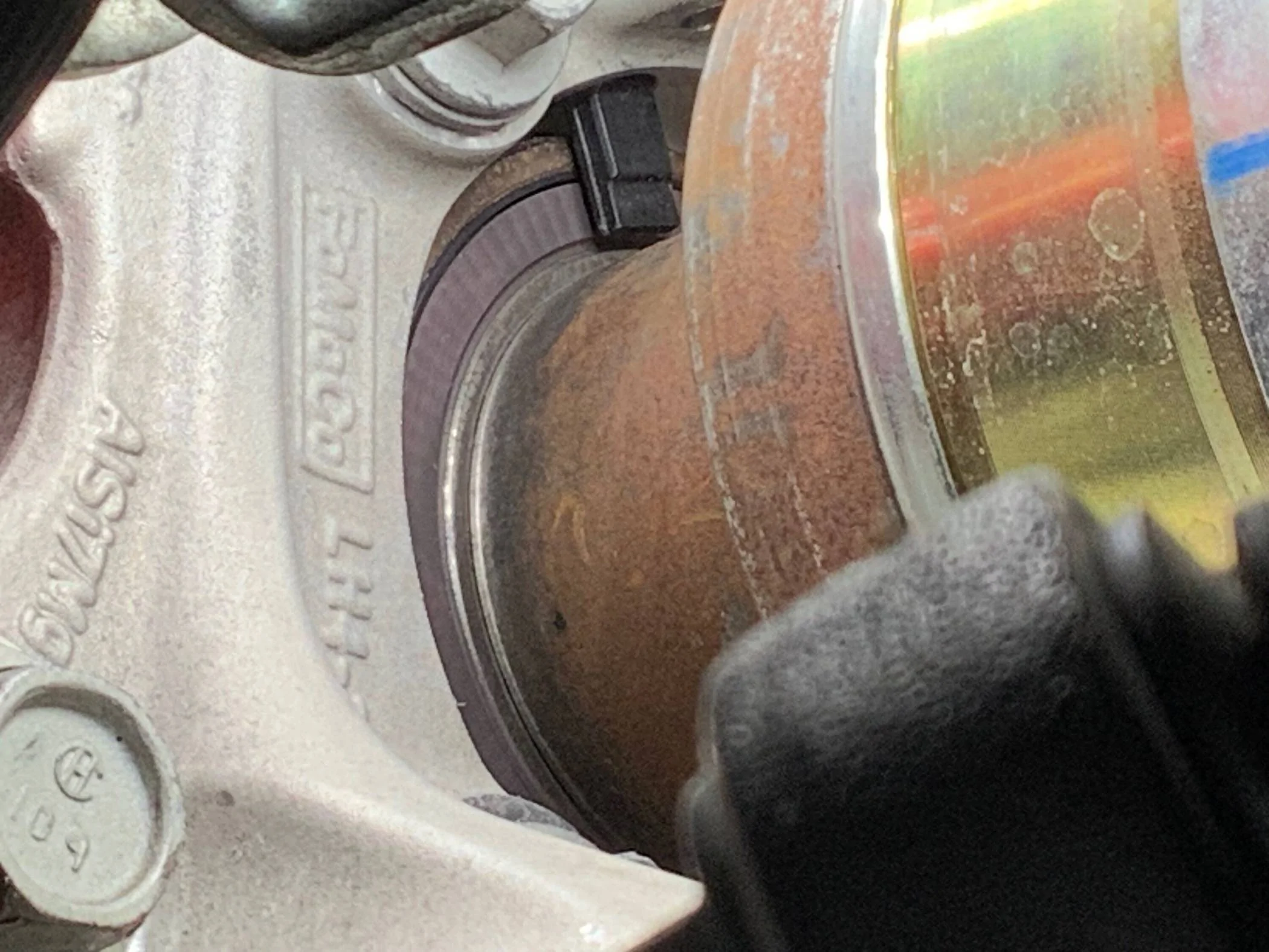

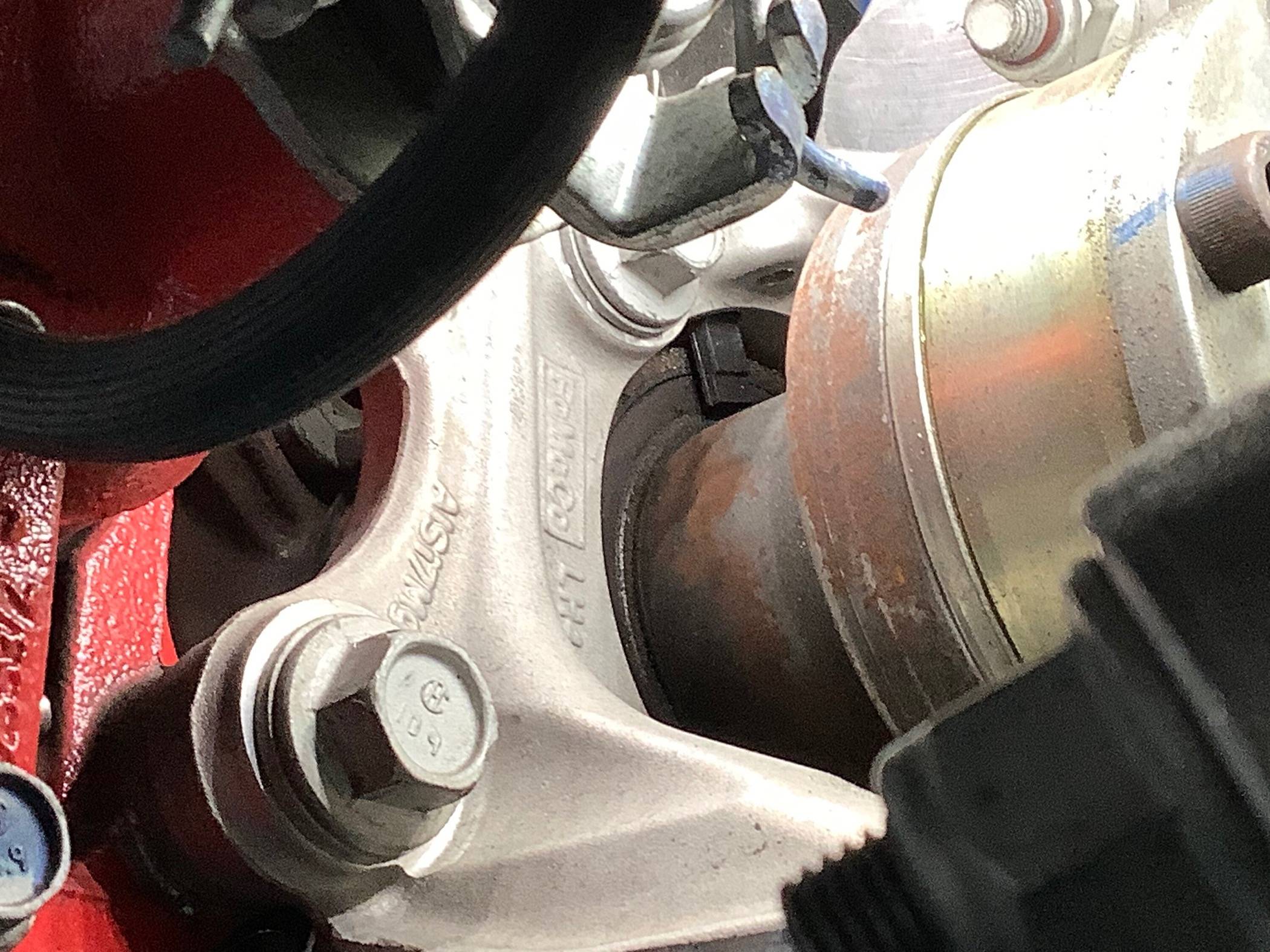

Maybe the rear ABS sensors and rings are gunked up like mine were with just 8300 miles and the sensors are unable to take a proper reading. Jack the rear of the car up to check and see if they are dirty. If they are, clean them with brake and parts cleaner and a rag and then retest. Here’s what mine looked like before and after cleaning them.

I would imagine that if the rear wheel speed sensors weren't reading correctly, it should've set a code in the ABS system as it monitors all 4 wheel speed sensor. If it sees a conflict (say the fronts reading 55 mph and the rears 30 mph or erratic readings) it should set a code and many systems will also deactivate the ABS system altogether since it wouldn't be able to determine whether it's applying the correct amount of braking force to prevent wheel lockup.

I don’t know for certain what systems are tied together. All I can say from my personal experience is, I had received the following DTCs and or warning messages off and on until recently, when I made my own Magneride delete sensors for the rear shocks, (P2BFB and U0416, Suspension Fault - Speed Limited to 80 MPH, as well as Adv. Trac and ABS fault lights which stayed on). Cleaning my ABS sensors before testing the MR delete sensors seemed to make sense, given how dirty they were. I can’t imagine them not having some sort of negative effect on the ABS system.
Granted, some of my issues may have been self induced by trying to circumvent the rear portion of my MR, but recent testing has come up void of any codes and I hope it stays that way too.
