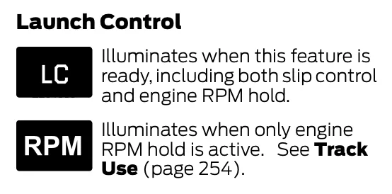

Yes, I think you're right. I found this in the manual:
I thought the LC was completely inactive without the traction control, but my assumption was wrong. It seems that half of it will still work. It will hold the required RPM, even though it won't be able to do its main job afterwards.
