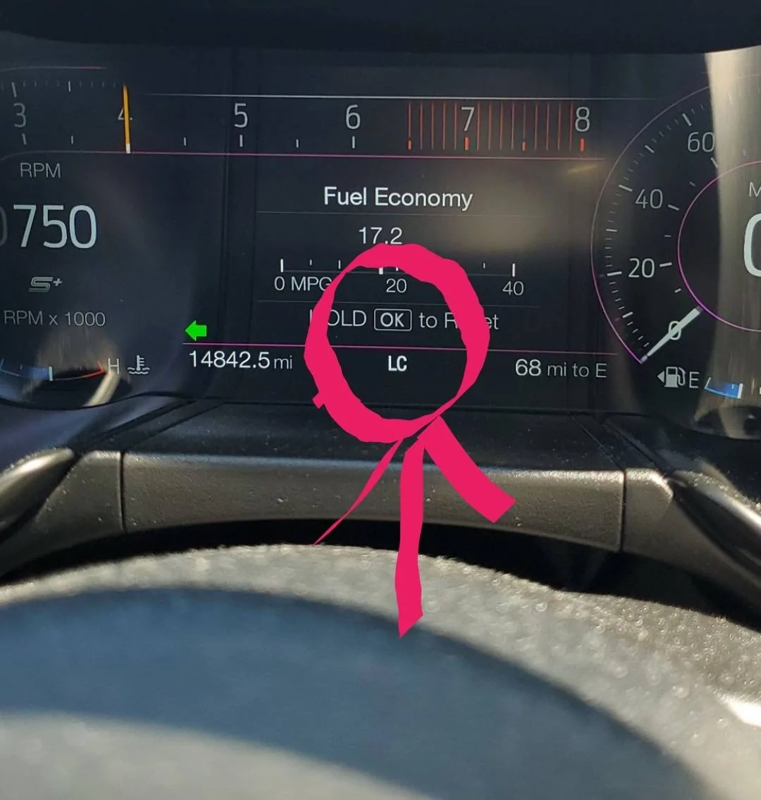

Im not sure if you have used it, I attached a screenshot. When you go to the launch control menu, you can either check the box or uncheck the box to enable or disable launch control. For the past year, this "LC" in the picture world be on the dashboard and you can use the launch control.
Now, even when you check the box and enable the launch control, that lit up "LC" no longer displays and the launch control doesnt work

Why is the shift light set at 4k ? Could that effect it (is it lower than your LC setting ?).

I know. The box has to be checked.
Are you sure your is checked???

It's always been there it hasn't moved, i was trying to play with the rpms the launch control is set at and the shift light it doesnt seem to have anything to do with that
