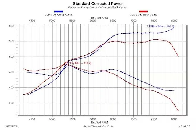

Yes I saw this article
If possible, I would be interested in FI cams which adds credible added HP to a specific boost level.

What are the goals?
I would only do cams if you want to go all out n/a. That means getting a ported cobra jet/high ram too.
Comp stage 2 n/a cams are the smallest I would go for gen3, any smaller and whats the point. If you look on the All Motor Coyotes facebook there is a guy that will make custom cams. I would go with him. I would ask him if its worth it to do lockouts so you can run bigger cams.
But at ~$2k for cams, ~$1,500 for manifold and tb, plus another ~$1.5k for install if your only goal is more power why not just go boost?
