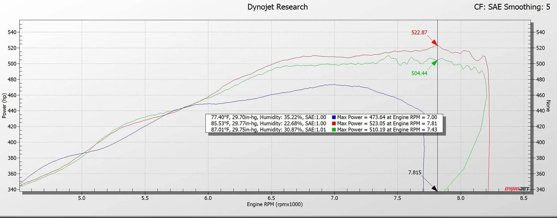

Here's an A-B. FBO E85 vs. my Comp Cams build I get to 520+rwhp SAE Holley low-ram because I did the little extras. "NSR" no springs required is meant to factory redline. The heck with that, I want to shift at 8200rpm and do. So I did PAC 1281X springs, titanium retainers, tensioners, chains, etc.
Blue is FBO with ported stock Gen3 manifold. Green was before Soler 95mm TB and a very light home port match on the lower ports of the Holley. Pump E85. My tuning with HPtuners and it has excellent driveability and shifts great.
