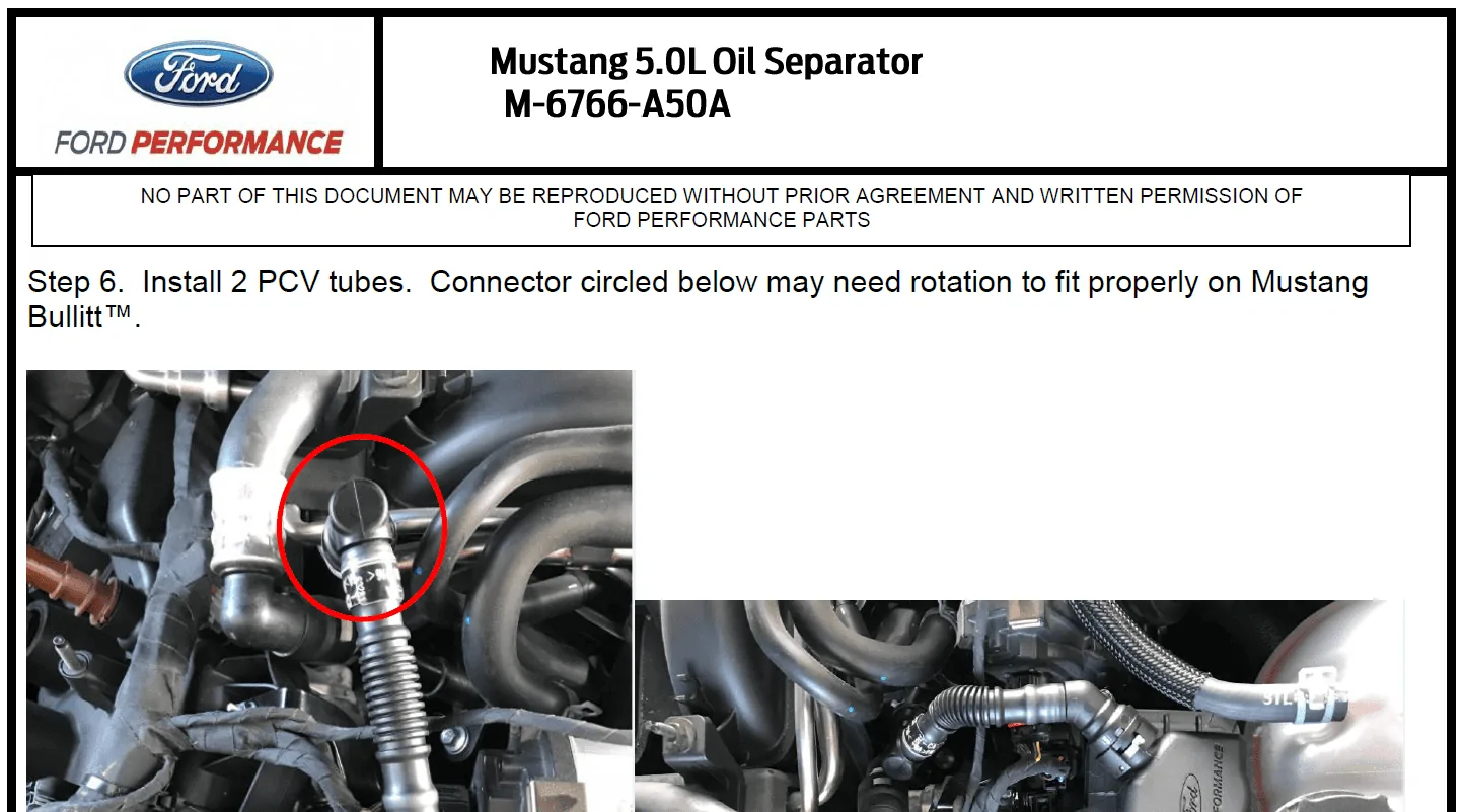

Bullitt IM swap in a 18+ is not as straight forward as many think.. Some connectors change, the evap solenoid change but there is a work around using the stock one. The car have some different vac lines than a normal GT.
That's what I was afraid of. :frown:
I know this is an easy mod, but these instructions back up there are differences in the PCV lines :
