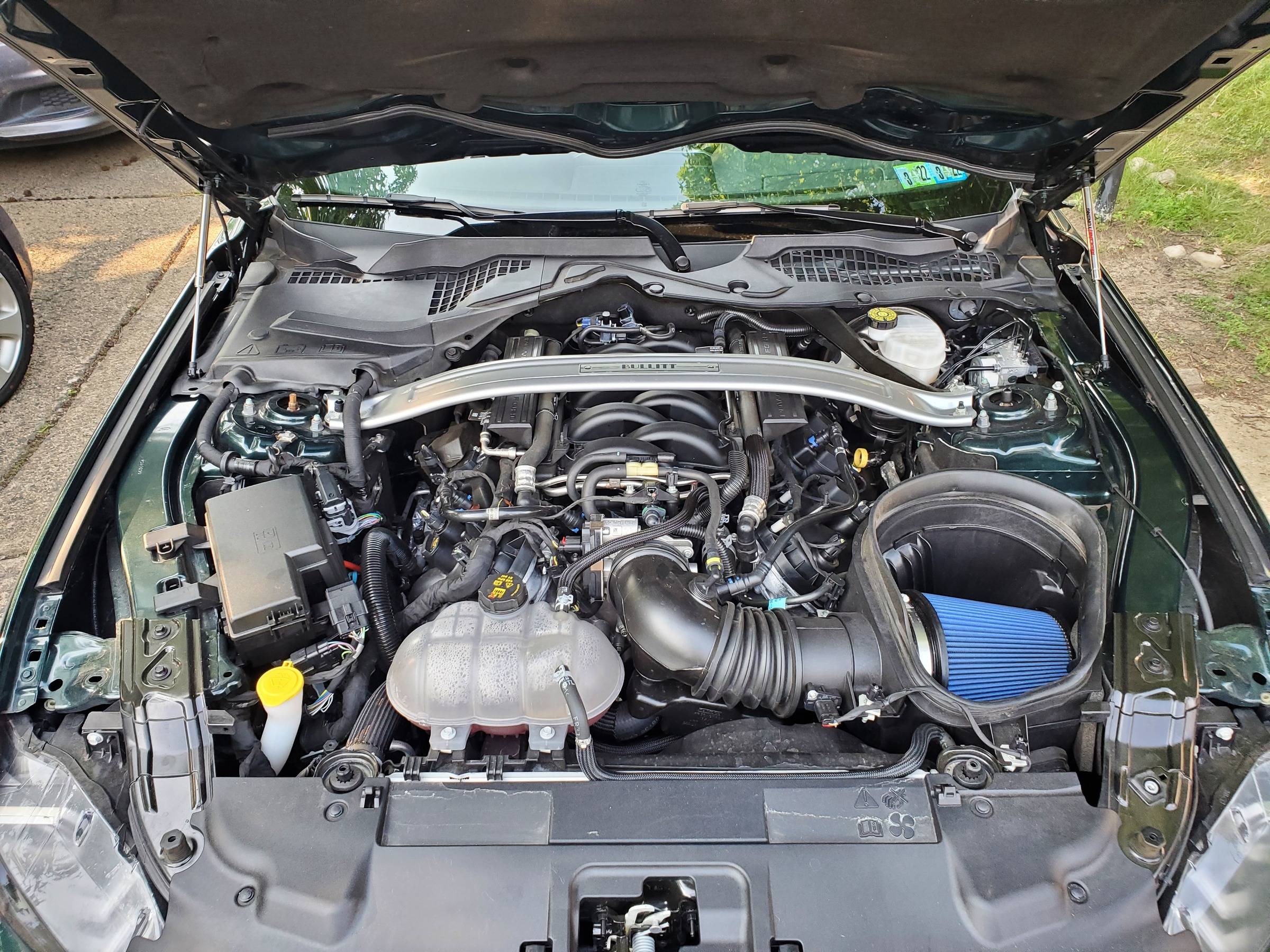

Strictly speaking about the power difference.
GT350 Intake Manifold
GT350 Throttle Body
GT350 Air filter/intake

It also has everything a performance package 1 has besides the spoiler. This includes the bigger radiator, brembo brakes, upgraded sway bars, and the strut tower

Because I suspect it's going to be expensive, and maybe not so trivial to replace. Whereas the intake and throttle body alone shouldn't be too much trouble.
I'm trying to figure out what it would take to turn my GT, technically, into a Bullitt. There's also the tune, of course, but that shouldn't be too hard; it's the hardware I'm more worried about.

The manifold is about $500 (at least in the US) new and it's pretty easy to swap with basic hand tools and knowledge on how to turn a wrench.
Not sure about availability of this part to Romania though.

After 2017 the GT350 manifold is no longer plug & play for the IMRC. 87mm GT350 TB is analog, 2018 up GT 5.0 are digital. Turning your 2020 GT into a Bullitt is a hot mess electrically.

Short of a Cobrajet intake, You already have one of the best intakes going. Yours has better low end torque than the GT350 intake and has power to 7500 rpm.
IMO. Go with a CAI and a good tune. You will find the HP difference there. Add E85 to the tune and you will likely exceed the Bullitt numbers.
For around $1000 bucks you will reach or exceed your goal and blow your warranty to hell :like:
The HP difference is negligible relative to my 2019 GT and that can be easily remedied.

While correct to a degree, there's a little more to it than that. The Bullitt/Mach1 intake manifold carries a different part number than the actual '15-'20 GT350 unit.
While the GT350 intake is plug and play in terms of the IMRC on a '15-'17 GT, it's not on the '18+ but presumably the Bullitt/Mach1 unit would be.
