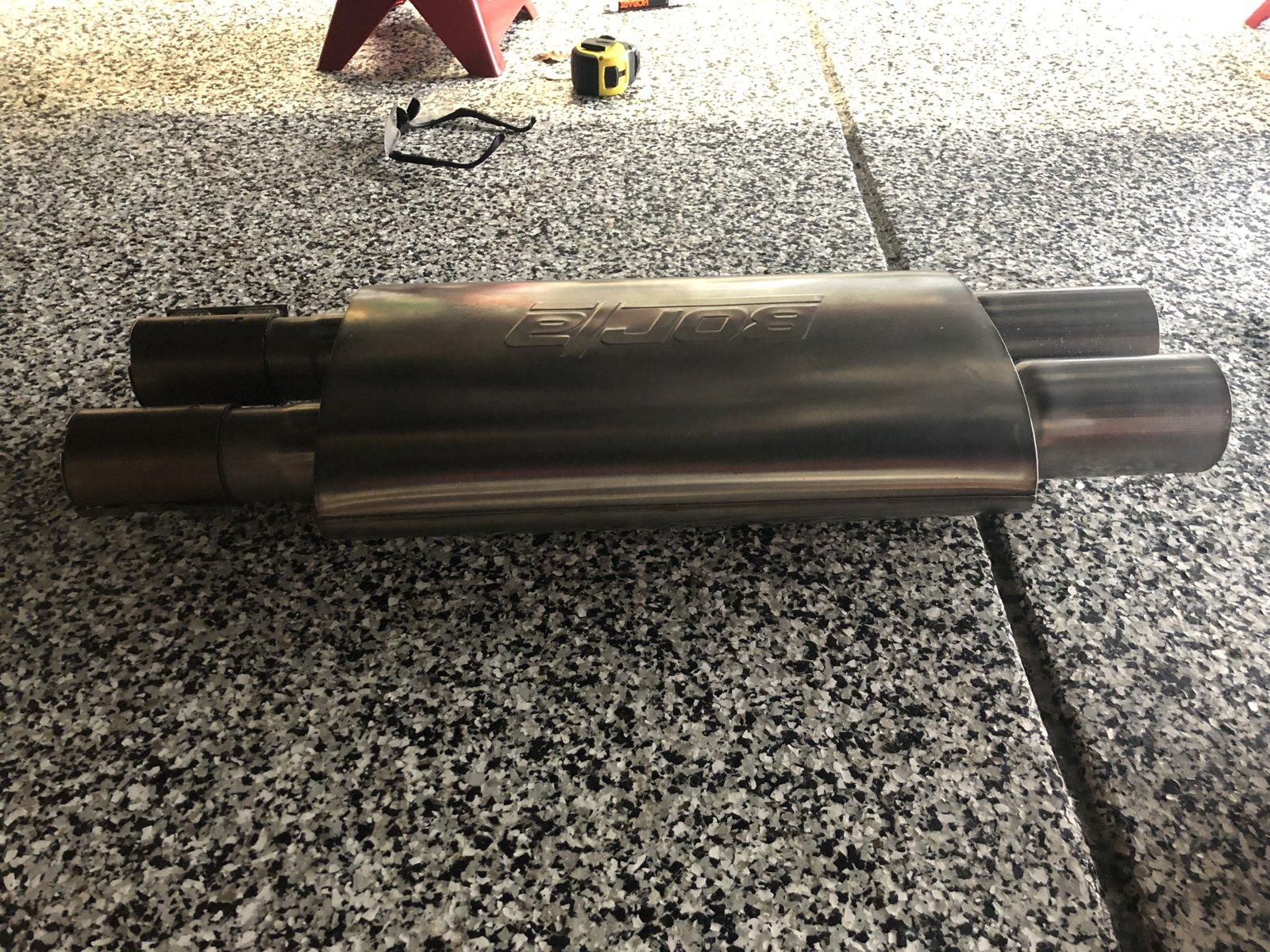

I got a borla resonator and was mocking it up under my car with pypes catless headers. On an 18 the body of the Borla resonator is so wide it looks like it will make contact with the car body heat shielding underneath or possibly the parking brake bracket that's between it and the driveshaft in that same tunnel area. I'd hate to chop an MBRP h pipe to only have contact and noise transferred into the body.
Anyone got pics of how theirs went - or if not - have you had any contact noise from yours installed?

Borla 60661 - I'm wondering if just lowering the header midpipes a smidge - if I can - will resolve the issue.

No - I will have to cut out the h-pipe section of the exhaust to accommodate the Borla taking it's place. It also happens to be an h-pipe though, in case I wasn't clear what I was trying to accomplish earlier in the post.
