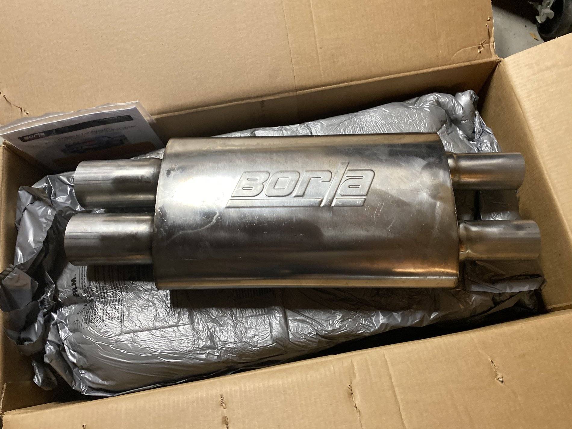

I ordered a Borla resonator from Summit racing for my 18 GT. Received it yesterday and when l opened it up, it's not as advertised. It's advertised as 3" in 3" out but only one end is 3", the other end is 21/2. Has anyone else experienced this, or did they ship me the wrong one?

Sir if you go to the Summit website and look up Borla resonator part # 60661, it is advertised as 3 inch inlet, 3 inch outlet. That's why l was wondering if they sent me the wrong part.

So I bought all 3 Borla resonators as this was something I was curious about and I to can confirm that the 3" one was advertised as 3" in and out which is what I wanted. I also have the Kooks uncatted headers on my car and was trying to run it continuous with 3" till it exited the resonator down to 2.5" (I'm not changing my current axel back). ALL of the Borla resonotors have a 2.25" inlet and the exits are 3" and two that are 2.5". The difference between the two versions of the 2.5" exit ones is that one has sound deadening material and the 'Ford Performance" one has none....sounds like a hollow can.

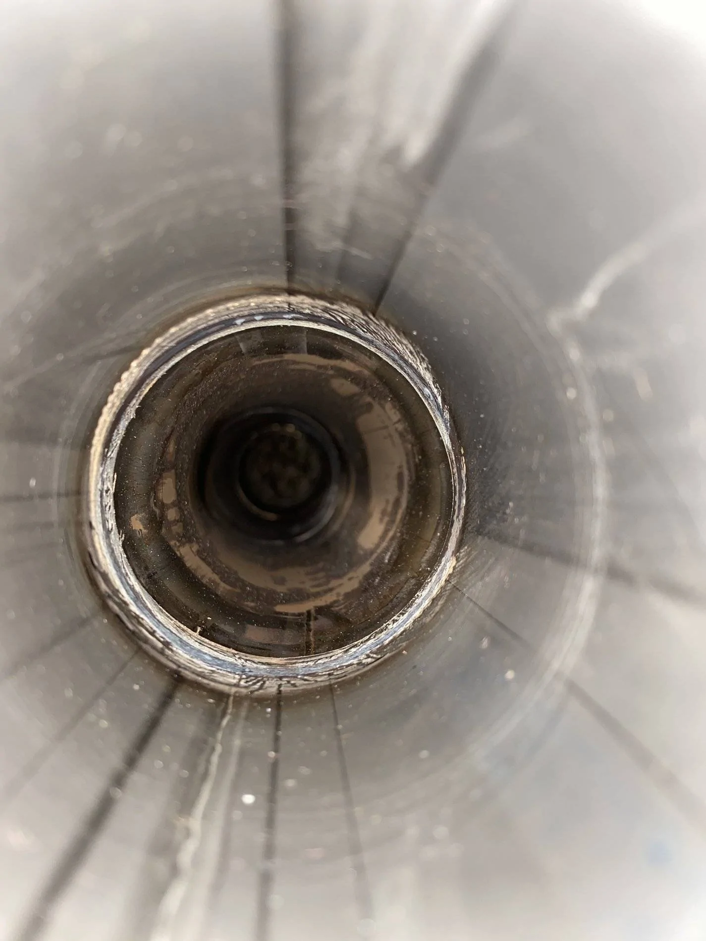

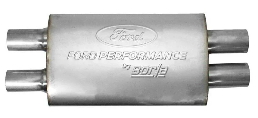

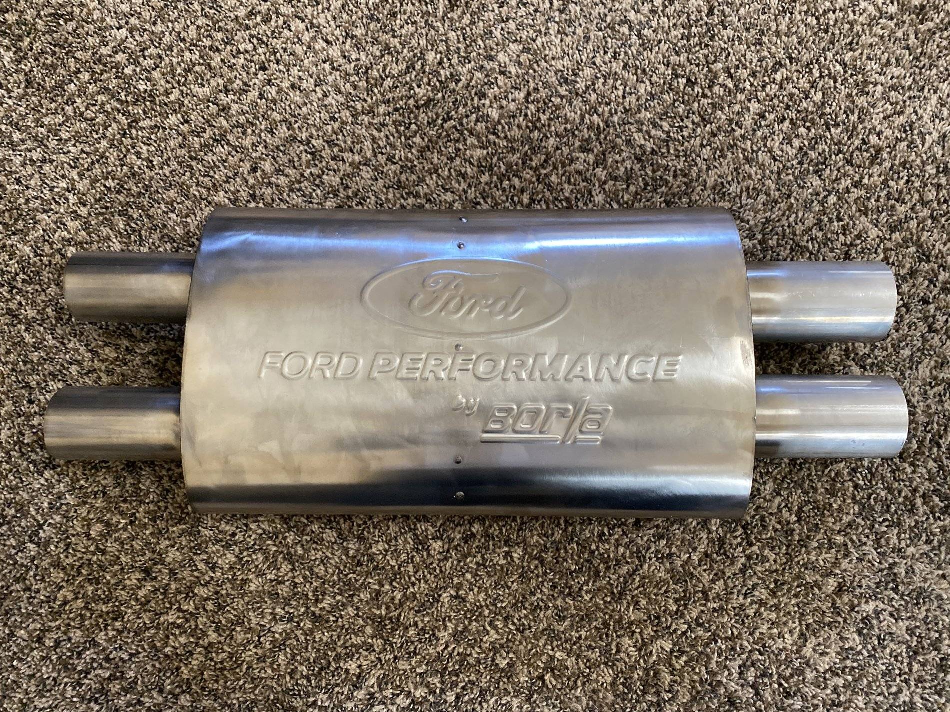

I just installed the Ford Performance by Borla resonator on my Kooks catless longtubes to Ford Performance by Borla Extreme catback setup. There is absolutely nothing to blow out on this resonator because it does not use sound deadening material or any perforated tubing. Internally it is like an H-Pipe but near the inlet of one pipe has an air chamber and near the outlet of the other pipe is another air chamber. These 2 chambers simply cancel out the obnoxious rasp in the lower rpms. It works surprisingly well and allows me to have much better control over the volume of the exhaust. It is still LOUD AF at WOT and anytime I want it to be. When I had the Xpipe, it simply was ridiculous at any throttle position and I grew tired of it very quickly. I wish I took pictures of the inside of this resonator before I installed it but here is my shitty drawing of it. Ha!

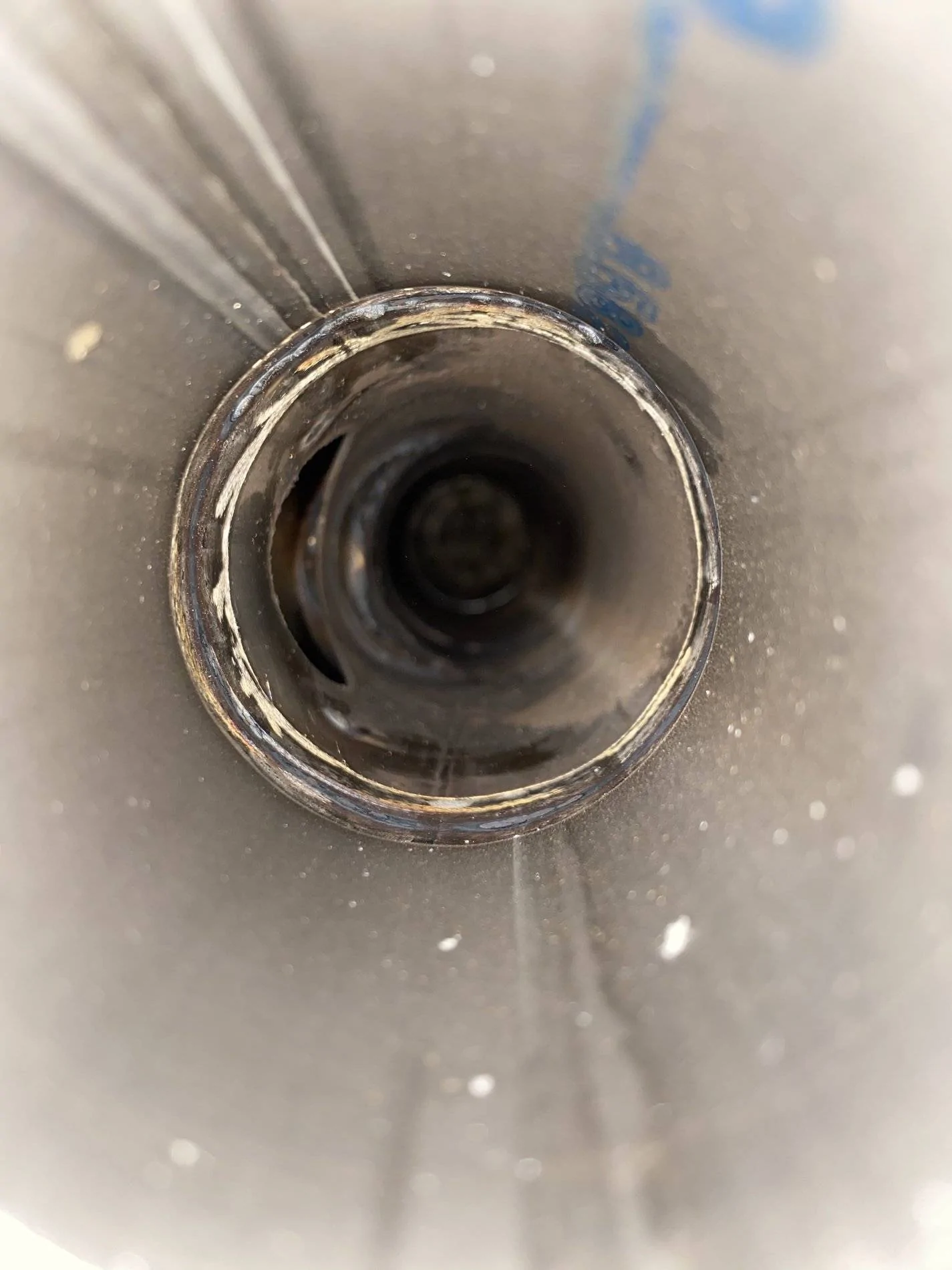

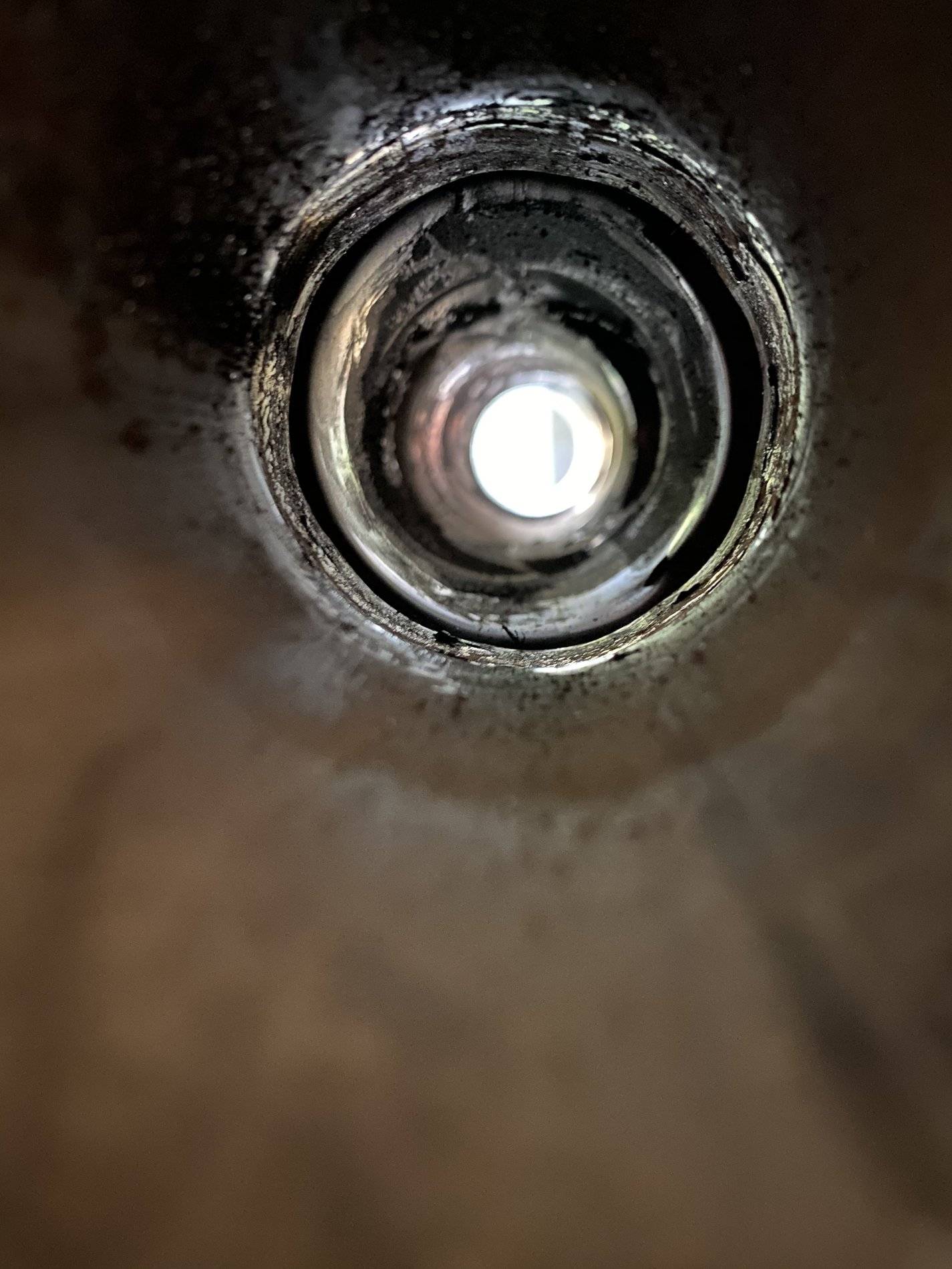

Here is the pics of the inside of the Ford performance Borla resonator that I took. No sound deadening hollow can sound if you tap on it.

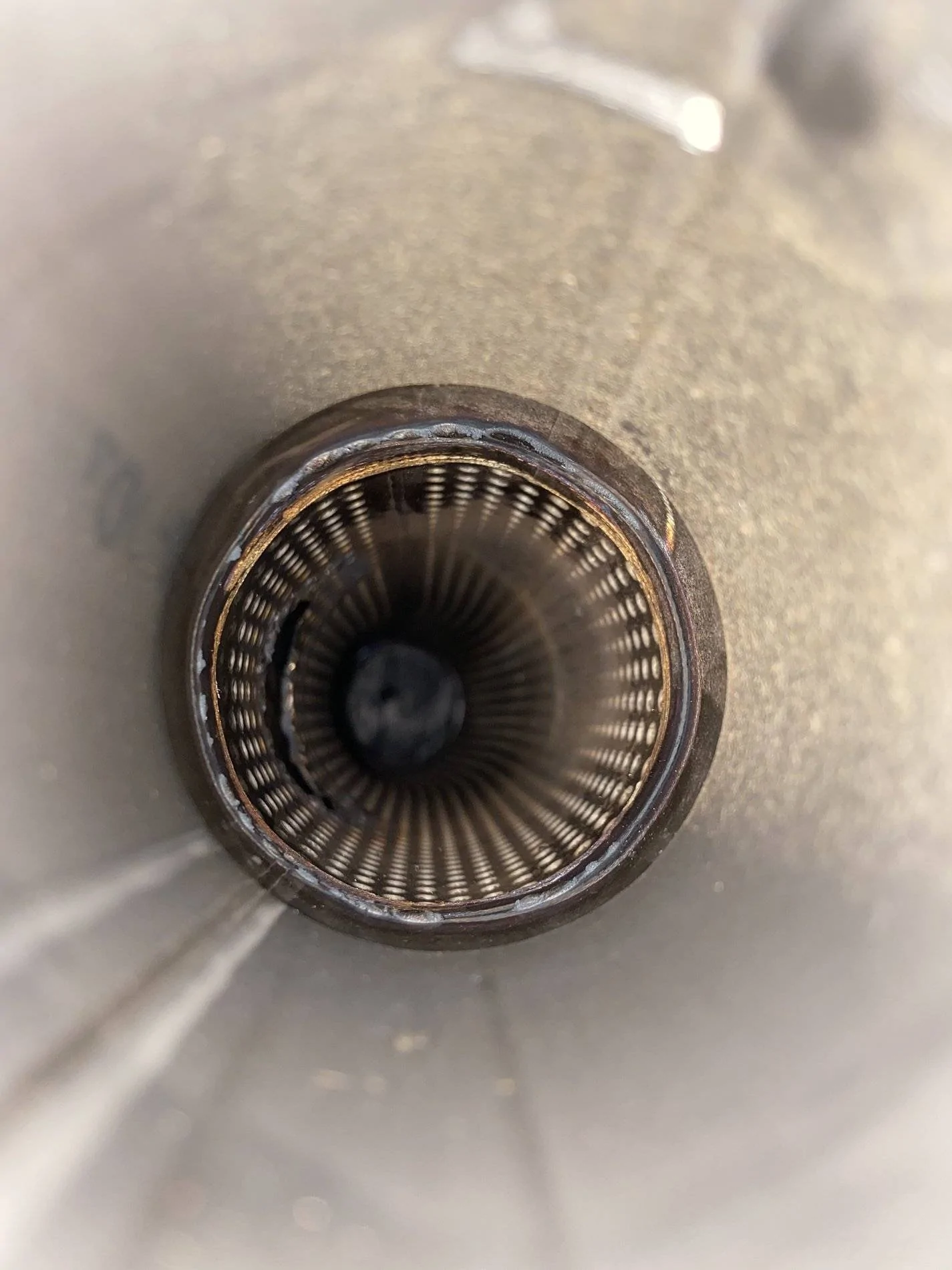

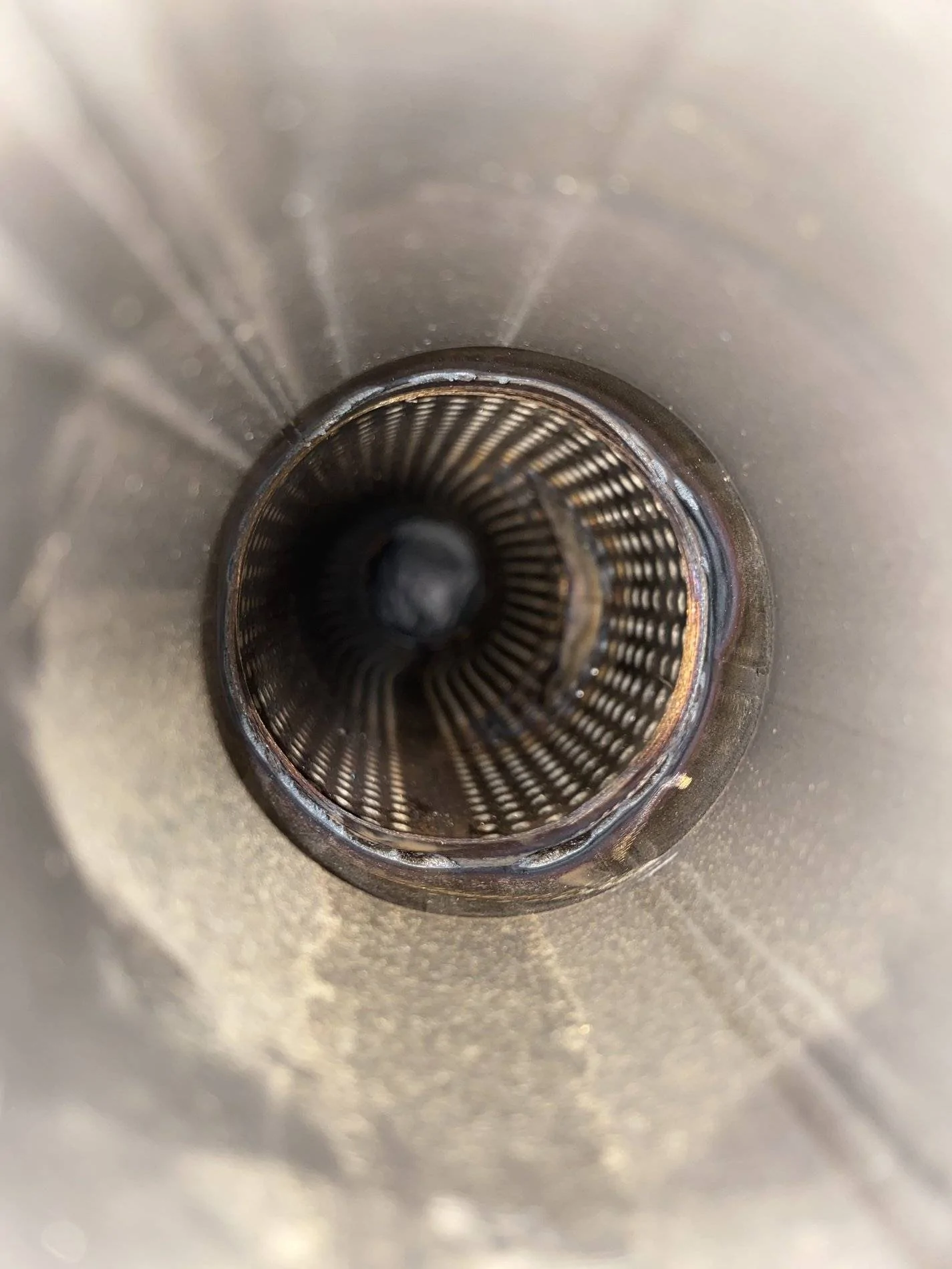

Here is the other Borla resonator regardless if it’s the 3” exit or the 2.5”. Sound deadening material inside and sounds like a dull thud when tapped on. You can easily see the openings for that.

^Yupp, ours looked like the borla direct one, In fact, in some videos from behind the car, you could see the resonator packing blowing out of the exhaust tips
